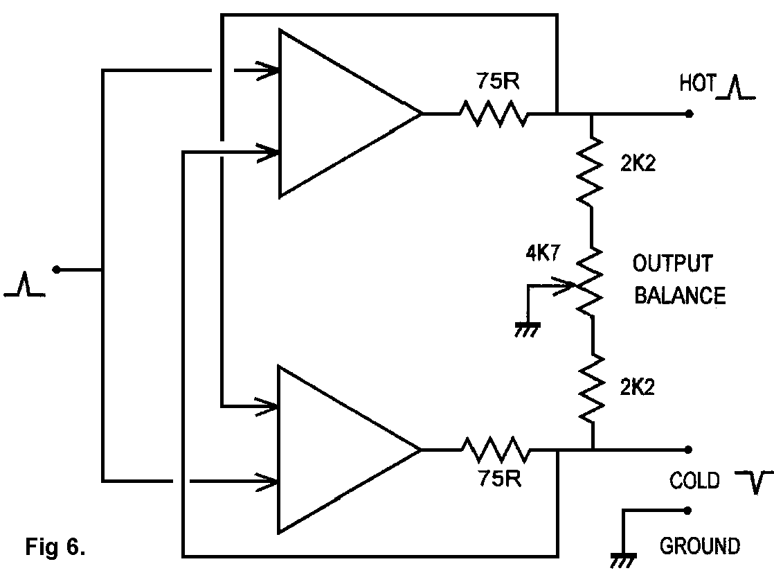

Mentionned by Douglas Self, quasi-float (Balanced Line Technology ), this is the principleas used by the DCX and by the BSS366 :
Wiring as in BSS 366 manual (should be used with the DCX) :
attachment.php
Using the connection as shown by the lower graphic, you get the same voltage for an unbalanced receiver input as for a balanced receiver input.
Using the upper connections, you get half the voltage for an unbalanced receiver input compared to a balanced receiver input.

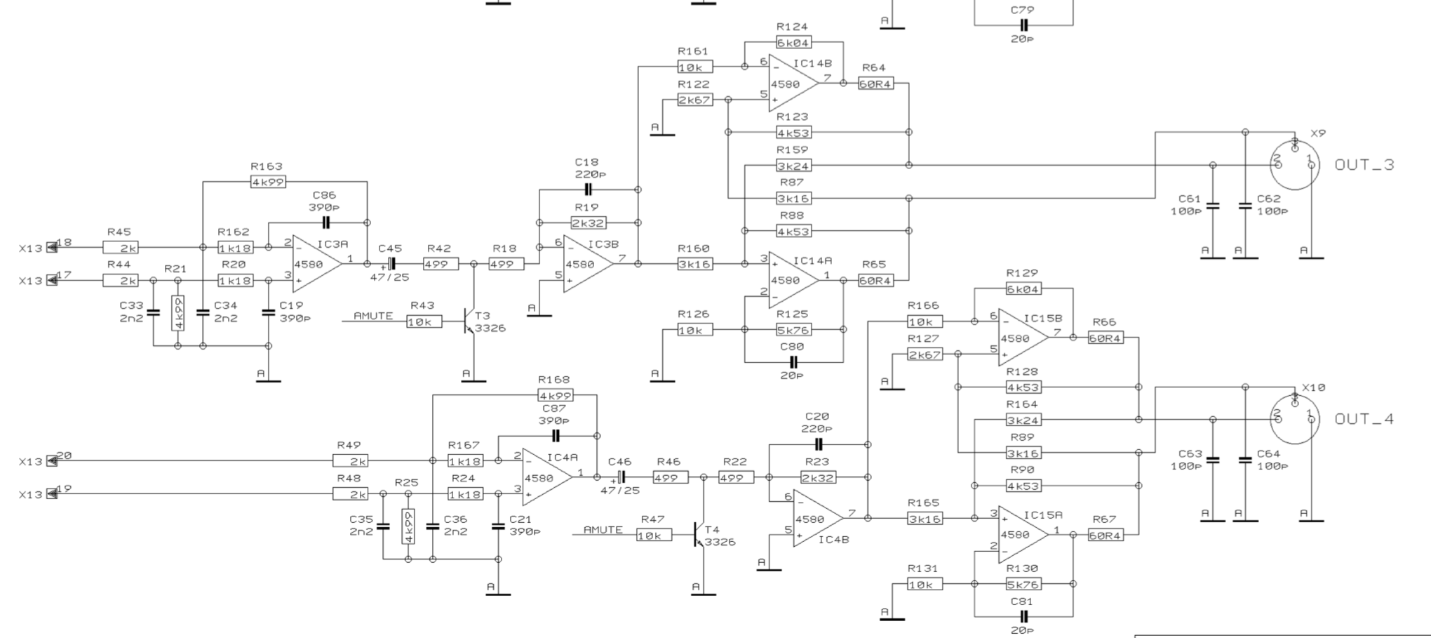

IIRC there are people who have picked up the single ended signal somewhere around the muting transistor, or just after the 1st opamp. I haven't done that, but it seems a reasonable place to get the signal if you want a single ended output. The signal level may also be better for consumer gear.
Yes, that has been reported in the DCX Threads.
There was a French Member who went a bit further and added a passive filter after the mute tapping point that bypasses all of the remaining output stages.
He had a webpage or more detailing the modification.
That avoids ~11dB of gain and the noise+distortion that gives

Yeah, that's a common DIY modification. However, in my opinion, that doesn't leave enough gain.
When considering modifications to the output stage, you can quickly come to the conclusion it makes more sense to just remove the entire board and substitute in something much better. This is how many of the more formal modifications (like Jan Didden's) have been implemented.
On my own DCX, I removed the entire rear board and installed a six-transformer configuration that picks up the signal directly from the DAC's. This doesn't yield enough voltage either, but adding a six-channel volume control (with some line gain) solves the issue.
I hope this posting of the output portion of the schematic makes clear my previous commentary regarding the handling of pin 3. You can ground pin 3 if you so chose, but you will have plenty of voltage and the increased load on one section of the output driver translates to some increased distortion on the other half.
However, if you leave pin 3 floating, then you have a more suitable output voltage, but you lose matching between the six channels owing to component tolerances surrounding the output driver stages.
It's a double-edged sword.

The posting of the output schematic makes it clear that it is a quasi-floating balanced output, and according to Doug Self and others pin 3 should be grounded, here is a quote from Selfs article
"When a quasi-floating output is used unbalanced, the cold leg must be grounded, or common-mode noise will degrade the noise floor by at least 10 dB, and there may be other problems"
It is from this article Balanced Line Technology
