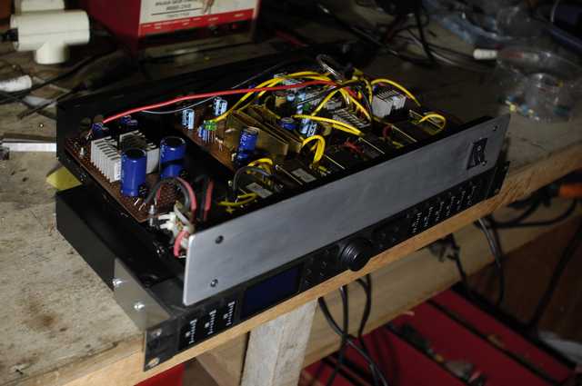

I can give you a live opinion : after the big amelioration with a linear PSU for the DAC (5V + 3.3V), I've been feeding each stage with an independent linear PSU (including the LED frontal display). All 317/337 based, in a separated rack screwed under the DCX for harboring the 9 circuits.
Honestly, it's not worth the job, I have not been detecting any striking improvement, and I don't even speak of the anxiety when you discover that there is a digital ground and an analogic one.
here a picture of an early stage, still is missing the +/- 15 V for the screen, the fans (all this get hot) and their PSU.
