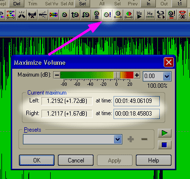

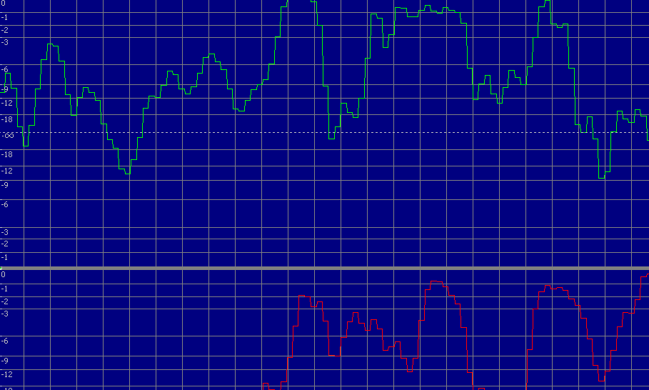

OK, a couple of shots of a pop MP3 with lots of clipping. Not hard to find!
If you go to the Maximize Volume button that looks like a knob with a ! beside it, it will scan the file and return the highest value and its time. See below.
Don't DO any maximizing, just cancel and go to that spot. The other image shows a zoomed in waveform where you can see the clipping. Use the 1:1 zoom or just keep selecting a small section and using the Zoom to Selection button. You'll figure it out real quick.

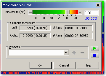

This file is "take it easy", you can see the 'max vol' is not quite at zero??
I assume the clipping is the signal hitting the top of the Y axis, not the actual square wave presentation of the signal in your screen shot..
I couldn't quite work out how to get same scale as your, but I have this screen shot shows the signal hitting the top of the Y axis
Strangely enough, this track hits Red on the DCX input meters for most of the song, but judging by the screen shots, it isn't actually at 0dBFS (assuming thats what the scale is?)

Yep, that's the stuff! Odd that Goldwave says max is not 0dB but you still see red lights.
Maybe there are just a lot of peaks right near the top, between the -0.1 that ZigZag found lights the red LEDS and the -0.01dB of your max value.
I have a few recordings like that. They are hot enough to flash the red lights but they aren't actually clipped. Very hot mastering, tho.
Looking at what you posted it does look like something that had been clipped at some point, then turned down a bit. You might see more by zooming in tighter.
