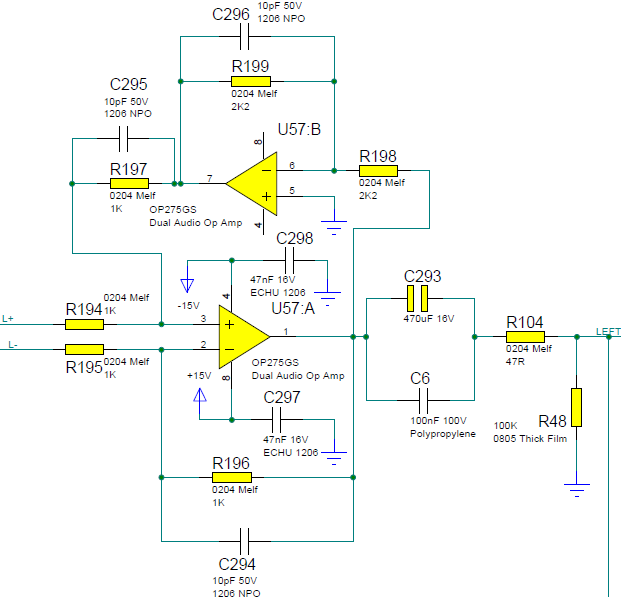

Schematic attached.
I perceive it as a differential to single ended converter with servo balanced biasing and capacitor output AC coupling.
If you reuse the structure, you will need two of those, each connected to both inputs, but with opposite polarity.
My idea was to reduce complexity, not increase it... 😉
Now, applying two of them to the input of a fully balanced opamp would theoretically increase CMMR with the added benefit of offset control and AC coupling. Interresting idea, ideally the common-mode reduction ratios of the buffers and the balanced amp would add, as the balanced amp only sees the common-mode output of the buffers - which is the input common mode attenuated by their CMMR.
It's practical application looks difficult, though. The frequency compensation and transfer function doesn't look suitable to leveraging the OPA1632 in the next stage, also complicating calculation and making the whole thing more prone to component quality and tolerances (as imbalances in the two buffer circuits' transfer functions will greatly deteriorate CMMR of the following stage, probably beyond the point of making the gained CMMR futile).

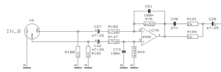

Take a look at the attached schematic. It's Behringers original differential input buffer and AC coupling. That's basically your proposal minus the actively driven feedback loop (and plus rubbish components). Cloning this stage and reversing the input feeds towards the pair would theoretically yeld the same CMRR increase, yet it's never used. I can only explain this observation with difficulties that likely come with mirroring it's behaviour.
Lastly, that Vocm capability of the OPA1632 is a feature that renders control of absolute offset voltage unnececcary, as the output will be elevated to the (constant, input independent) ADC bias level anyway. Also, I don't see the need for input or output offset cancellation in this balanced, DC eliminating ADC drive application. Can you please elaborate? I might as well be wrong on this, it's been a weekend full of hard work at work. 🙂

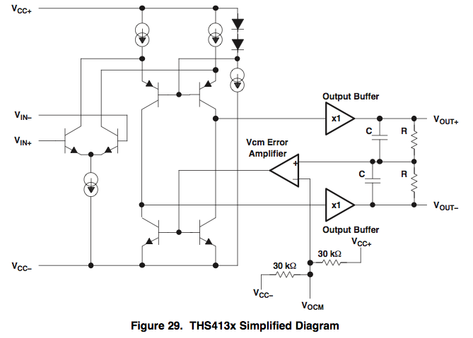

The fun property is that the Vocm input voltage replaces the output DC component of the (differential) input signal, independent of gain and frequency compensation. The block diagram (see attachment) shows that this is actually realized by something like a tapped servo loop...
provided errors are common mode, which given a reasonably well realized diff cct is entirely possible; the result will be very acceptable.
That's also my reason for choosing it. It sounds like you know it, then. How would you solve the input stage? What would be reasonably well realized according to you?
It's what it says it is, the simplified block diagram of the THS4031.
The similarities between the THS403x series (generic ADC driver) and the OPA1632 (specified for audio) are no secret, AFAIK. At least not since TI got into the DIY news when licensing parts of it from Nelson Pass. 😀
It's not the holy grail of audio nirvana, but it gets the job done pretty fine I suppose...

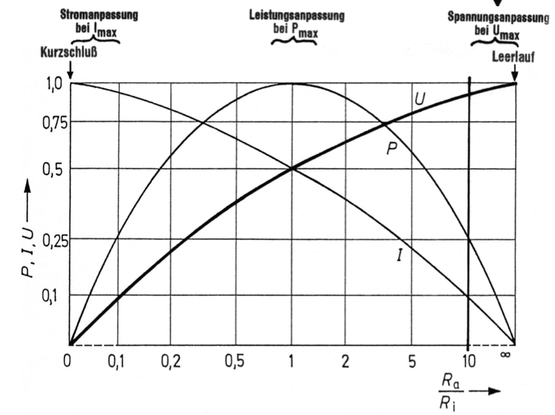

For an interconnection to be fully balanced, the inverting and the non-inverting current paths need to be equal in transmitter output impedance, gain/damping, transmission line frequency response/transfer function and receiver input impedance.
They do not necessarily need to have equal transmitter impedance and receiver impedance, i.e. 50 Ohm output impedance and 50 Ohm receiver input termination, respectively. This would of course be advantageous to high frequency signal transmission (RF) like an AES/EBU digital audio connection, but it's absence does not ruin the gained common-mode reduction due to the symmetry.
I have attached a diagram of input vs. output impedance. It's published by Eberhard Sengpiel on his website, I unfortunately couldn't find an English source for that kind of illustration (and I don't support all opinions of Sengpiel).
It shows voltage (U), current (I) and power (P) against impedance ratio of output impedance (Ra) divided by input impedance (Ri).
The extreme cases are short circuit ("Kurzschluß") at Ra/Ri = 0 and idle ("Leerlauf") at Ra/Ri -> inf.
Inbetween lies the range having maximum power transmission ("Leistungsanpassung").
As can be seen from the logarithmic ordinate, the relationship changes pretty quickly.
Consequentially, fitting a low output impedance transmitter to a high input impedance receiver almost universally makes any audio interconnection a case of "voltage fit" in the attached diagram. It's almost never a power fit and virtually never a short circuit. 😀 Those are for transmission lines and power feeds.
As of my understanding, going balanced and going for matched input and output impedances are two entirely independent design decisions, whereas the case Ra = Ri is entirely misplaced in the (analog) audio interconnection world due to established standards and proven best practice.

I perceive it as a differential to single ended converter with servo balanced biasing and capacitor output AC coupling.Schematic attached.
Yes, but I urge you to remove the output AC coupling and DC couple to the summing resistors at the OPA1632 input. Also, you probably know better opamps than the OP275.
It still comes down to two dual opamps as in your earlier schematic, but now only two amps are directly in the signal path. Of course I do not argue with your conclusion that five opamps are more than one.My idea was to reduce complexity, not increase it...If you reuse the structure, you will need two of those, each connected to both inputs, but with opposite polarity.
I do not understand what you mean here.It's practical application looks difficult, though. The frequency compensation and transfer function doesn't look suitable to leveraging the OPA1632 in the next stage, also complicating calculation and making the whole thing more prone to component quality and tolerances (as imbalances in the two buffer circuits' transfer functions will greatly deteriorate CMMR of the following stage, probably beyond the point of making the gained CMMR futile).
No, this schematic is fundamentally different and probably much worse than your proposal without any input buffer. The input resistor at the + terminal of the op-amp goes to ground and not a dummy -1 node. This means that there will be voltage swing on the + terminal, or common-mode, which will cause CM-induced distortion of the op-amp. And by the looks of it, quite a lot actually.Take a look at the attached schematic. It's Behringers original differential input buffer and AC coupling. That's basically your proposal minus the actively driven feedback loop (and plus rubbish components). Cloning this stage and reversing the input feeds towards the pair would theoretically yeld the same CMRR increase, yet it's never used. I can only explain this observation with difficulties that likely come with mirroring it's behaviour.
Let me then first thank you for taking the time to reply so sensibly after so much hard work. However, the VOCM will not have an influence on the different DC-levels at the input arising from input pair offset. IIRC, the OPA1632 input offset specs are not spectacular. And this offset will translate to a DC operating point with differential imbalance. This will mean asymmetric loading of the source and more influence of the VOCM loop on the output signal. With a buffer you would not get rid of the asymmetric loading of the source, but you would have manual control over the way the common-mode is rejected. I'm pretty sure that if you do it by dummy opamp it will be better than with the OPA1632. I suggest you try both ways and see for yourself what the difference is to your ears (I always use a friend with better hearing than myself to tell me such things; also this automatically makes it a blind test...).
So, although the datasheet says the CM loop is very good (and in theory this should eliminate the need for any input buffering), IMHO you should expect it to have high-frequency intermodulation effects and keep this in mind when designing a circuit.
In conclusion, Behringer original (vastly <<) your proposed circuit (potentially even <) your circuit with added DC servo input buffer.

Looking at your latest circuit diagram, I see that both inputs see resistors into a differential virtual ground. This is already quite good.
Are you referring to post #2900? That was my latest schematic, although it's the one without the buffers.
Thanks, an essential point of insight gained!
Ahhh, that's a judgement I can work with. 🙂

you may have misunderstood my meaning when I said send and receive to have balanced impedances. I did not mean equal impedances.................
The transmit hot and cold source impedances must be balanced.
eg 50r+-0.1% & 10uF+-1%
The receive end could be 1M5+-0.5%//10k+-0.1%//220pF+-1%.
Tighter tolerances can be adopted if you have the resources.
