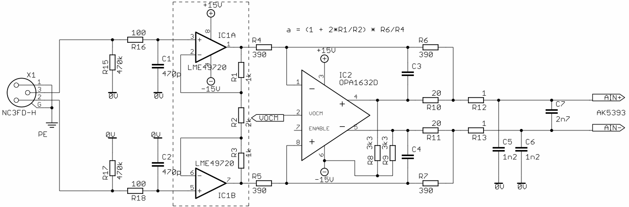

I'm joining in pretty late, but only now do I get around to modifying my DCX. I'm currently using the thing as a three-way crossover since a couple of years. The more I improve my other projects, the more my DCX gets on my nerves. Noise, gain issues, lack of quality volume control, etc.
I've sorted through this thread, the commercial projects, some alternative approaches ... and have come to a conclusion: I'd like to do my own set of mods to the Behringer DCX2496.
My first steps (in this order):
- Fully symmetric active input and output stages,
- Completely linear power supply,
- Improved digital input stage incl. AES/EBU, S/P-DIF, USB and AirPlay.
I'm about to remove my I/O-Board, but like to get some advice before I throw any time and money at building the new one.
Here's the first approach (see attached schematic, power supply decoupling ommitted):
High impedance input with some RF rolloff. DC coupled signal path. Instrumentation amp style jfet-input (OPA2134/LME49720) buffer and gain stage (as seen i.e. from Shine7). Fully differential opamp (OPA1632/THS4130) with second order LPF (according to recommendations from both TI, p. 7 and AKM, p. 16). Class A biasing by pulling both differential outputs down (as seen in ARDA Technologies AN-AT1201-1, p. 5f).
Actual gain and frequency response haven't been decided yet, so actual passive component values are only a suggestion.
What I'm interrested in is this:
- Is there any demand for a new dedicated thread? I don't want to ruin this one. 😛
- Is there anything fundamentally wrong with my approach so far? Any detailed recommendations are welcome!
- Do I really need the instrumentation amp buffers (dashed box area)? Can't I do with the fully differential amp alone, ignoring it's slightly higher input bias and impedance limitations?
- Do I perhaps need some more input spike and emi protection?
I know much of this has been done before, but not the way I'd like to implement it (i.e. different enclosure, entirely disposing off the front panel).
Thanks,
Sebastian.

Sebastian, the input circuit you have attached is very similar to what I'm building for my 3 DCX, but single ended in.
Single ended in is probably more useful for most DCX home users, but I prefer balanced all the way. 😉

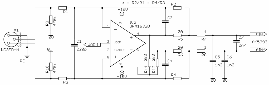

The only common-mode reduction mechanism in the LME49720 section seems to be the attenuator. This might affect the OPA1632.
Is the near-infinite input resistance a requirement? Otherwise putting the LME4970s in 2x inverting configuration seems like a better idea to me.
Do you need the attenuator? Otherwise you might want to consider the topology as used for the OP275s in the CA dacmagic; it gives you common-mode rejection and as an added bonus only one in two opamps is really directly in the signal path.
Or am I missing something and can someone (please, pretty please) tell me why the Shine7 topology is so good?
Hmm, I guess it's not. The stage is intended for regular interfacing, no special versatility for high impedance sources or high gain levels is required.
I'm really looking for a reason to dispense with the input buffers, maybe that's the justification. 🙂
Awww, I probly didn't explain myself clear enough here. By linking to the Shine7 schematic I only intended to deliver a source for my idea. I didn't mean to actually copy the whole circuit, i.e. I only wanted to give credit where credit is due.
The portion I applied here is the instrumentation amplifier configuration with one LME in front of the OPA1632 (instead of another unbalanced opamp), not the attenuator inbetween buffer stages.
Yes, I'm open for other ideas. Unfortunately I don't know the DACmagic from the insides. Could you point me towards schematics or an analysis.
As explained above, I don't think it is (for my project), although I could imagine doing something similar in the analog output stage of the DCX.
The design started as an online forum development. I never understood why they mutually agreed on having five amps in the signal path just in order to be able to make the attenuator "symmetrical".
Well, maybe I'm just a little bit reluctant to use the fully differential amp as the first (input) and only (anti-aliasing filter) stage. But as I see from a lot of evaluation boards and commercial products, there seems to be no reason to be afraid of doing so. That's why I made a modification to the schematic (see attachment).
What does everyone think?
