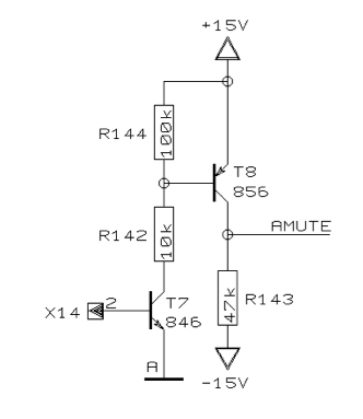

Yes. I've attached some screenshots from the DCX schematic. The first one shows the differential input of the DAC buffer (example shown for output channel one, connector X13, pins 13 and 14 on the I/O-board).
These pins should both be tied (together and) to analog ground. If left open the opamp IC1A will have an ill defined input signal and might pick up noise. This noise - and likely hum - would be amplified, which could result in parasitic supply current drawn by the opamps. We're speaking of four opamps per output channel, so 24 opamps (12 ICs) in total for all six outputs. In a worst case scenario this load would weaken regulation performance of the DCX's power supply even further - unfortunately it's very bad to begin with.
The second image shows the muting control circuit. If you feel like it, you could additionally use this one in order to permanently mute the outputs. If you don't, just keep this pin connected to the DSP board.

Just to confirm, when you said 'short the now open inputs to the opamps, too.', do you mean connect the signal lines going to the op-amps to ground? If so that sounds easy enough so I'll do that. 🙂
