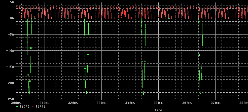

I've just read a post where it says a bridge rated 35A can provide 70A of direct current. This is plain wrong, because capacitor loading happens in a spiky way.
The attached image shows the current that passes through a diode in a bridge rectifier that is powering a 50W/8Ohms gainclone.
Some clever people may thing 50W & 8Ohms means (I^2)R = 2.5A. Some cleverer may thing: Ipeak = sqrt(2)*Irms = 3.54A. If you are one of these then give a look at the plot.
EDIT: The red trace is the current the amplifier takes from the positive rail, green trace is the current that flows at the diode.
Maths are useless if they aren't driven by common sense.
EDIT2: Guess what happens to your masterpiece when one of these diodes becomes tired of it and shorts? I learned it the hard way.

Maths is a precise tool in the right hands.ionomolo said:Maths are useless if they aren't driven by common sense.
What was behind the plots? Software that relied absolutely on maths to generate the numbers that are plotted.
It's us users that are useless, not the arithmetic.

Let's push a bit the state of art. Shouldn't a 0R2-0R5 resistor between the rectifier and the main filter caps be a standard in all psu's? From what i see in spice it makes life much easier for the rectifiers apart from giving a cleaner FFT, the gainclone will not sound that quieter if feed 32V instead of 33, and the resistor is very cheap.

but it's already there. Many forget that the secondary resistance does exactly that job even though it's located before the rectifier.ionomolo said:Shouldn't a 0R2-0R5 resistor between the rectifier and the main filter caps be a standard in all psu's? From what i see in spice it makes life much easier for the rectifiers
Most ignore that resistance when they model the performance.
Good point. I will do some more simulations to see if the 0R5 would still relief some dissipation at the transformer, but i don't expect it to be as spectacular as with the "ideal" vsin.
