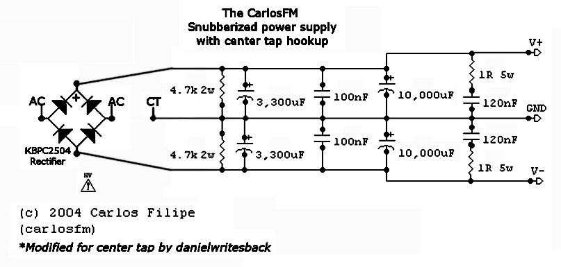

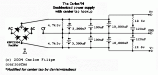

POWER SUPPLY

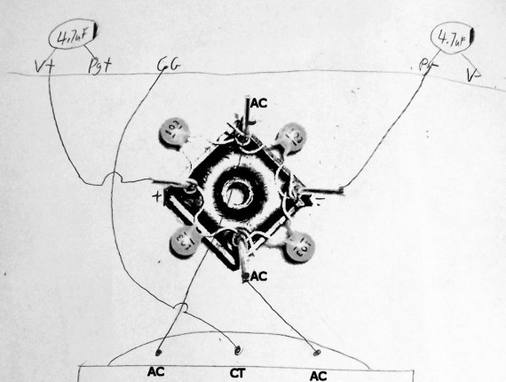

If you have an Audiosector PCB or the style of "open wire" (no pcb) that has similar large caps right on the board, then this (pictured) is all you need for a power supply board.
The parts are a 1 piece rectifier (KBPC1004 or KBPC1005) along with 10nF caps (ceramic or polyester).
These 10nF (0.01uF, "103") little caps subtract rectifier noise, which reduces heat and reduces radio interference.
Also, have a look a photo # 4 in Mark Houston's design http://www.diyaudio.com/forums/showthread.php?s=&threadid=123515 and you'll see this same thing.
I like this little plastic rectifier (KBPC1004), because the top of it is clearly marked for hookup.

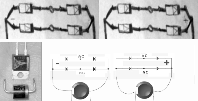

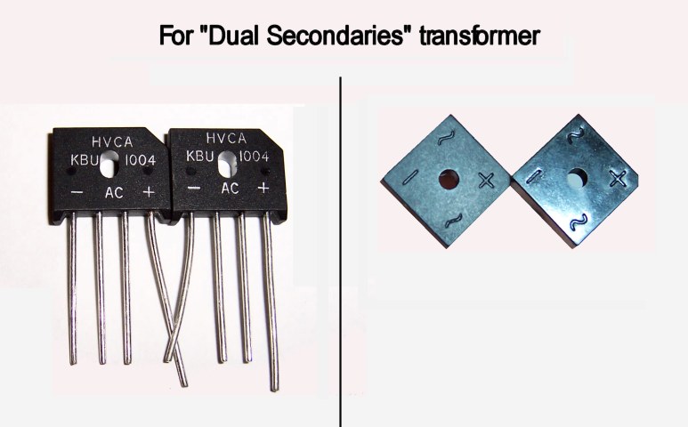

What if your transformer has 4 wires coming out instead of 3?
That would be a dual secondaries transformer. In that case, you use two rectifiers.
The AC terminals are marked on both the transformer and the rectifiers.
The DC output of the rectifiers go just like flashlight batteries in a 2-cell flashlight (- + - +). The centrepoint between the two is the 0V line. See photo.
Here's a photo montage that takes the mystery out of how to deal with two rectifiers (for use with dual-secondaries transformers).
This is quite similar to hookup methods for the Audiosector and Chipamp.com power supplies.
Maybe the photo will help to explain them.
What if we have an amplifier board that doesn't have large (1500uF or so) caps onboard?
Our recent LM1875 project uses one of these values on the amplifier board:
220uF
330uF
470uF
And so we can tell from this, that we need both rectifier and a full power supply board to go with it.

There's actually a lot of variety in power supplies, but they do have a few things in common.
First, the caps that are directly at the rectifier are exposed to rectifier noises and they get warm. In the commercial example above, the caps on the right side (first line of defense) get warm.
After the first pair have worked hard to make relatively clean power, then the second pair run cool.
That's working like this:
1). Transformer
2). Rectifier (diodes)
3). Caps that clean the power
4). Caps that contain a clean reserve, similar to a battery

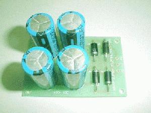

Here's a larger example:
Look closely and see that a pair of 3300uF are cleaning the power before passing on to a pair of 10,000uF, and the 10,000uF are then able to provide clean reserves for the amplifier.
1). Transformer

Here's another concept that I believe to be important. . .
I think that speaker support vs cap speed can give us a clue about the minimum size caps to use.
The ground return of your speaker hooks to the zero volt line (Power Star Ground). Therefore, I'd hazard to say that the minimum size power supply capacitor is exactly the same size that could possibly pass the entire audio signal if used for a crossover.
Popular examples include 1500uF, 2200uF, and 3300uF.
Simply put, the centrepoint figure is 2200uF, so let's use it for the "first line of defense," right at the rectifier.
A 2200uF 50v cap is quite inexpensive and fits easily to a variety of projects. Its usually fast enough to do a great job for clean DC (power smoothing). Its also large enough for reserves, but that could be expanded. . .

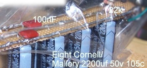

The simplest way to expand on a pair of 2200uF is to add 3 more pairs of 2200uF (in the photo below).
The total number of 2200uF capacitors in the photo attached, is eight. If you price that, its a bargain. When you go to solder that, its a breeze.
Here's a sample photo.
Soon, I'll make another with a bit wider board and show the rectifier attached as well.
I don't agree wit hthe last post entirely...
Yes you get lower ESR from parallel caps.
However it is not economical....
In that you need more space (larger case = more money), also the price of paralled caps tend to at least equal and often exceeds the cost of one single larger unit.... At least for as long as I have been looking into it.
If you are going to use parallel caps make sure they can store the energy required to drive your load at x Watt.... some high school physics required to work out Joules...
Sometimes I will make a compromise and use 4700uf combined with 10000uf, I think there is some merrit to adding the faster (smaller cap)
If you want cap speed, put down the bucks for some Epcos Sikorels, will set you back about $50 each in $10000uF 63V. (nice and big they are 2 x 3 inch)
Also, you don't NEED two bridges for dual secondaries... it is merely an alternative, bringing its own cons...

On pricing my power supply, it generally comes in around $10 to $14. And, its performance appears to be considerable. The main thing is that it can give the beginner a good solid baseline for some performance; and, do so in a simplistic and inexpensive way. This is, after all, a "very first build" project.
At this time, the space it takes up isn't a concern for me, considering the wooden amplifier enclosure is going to. . . 😀
I'm not prepared to spend $800 for smoothing caps for a pair of 300W into 4ohm monoblocks.Nordic said:......If you want cap speed, put down the bucks for some Epcos Sikorels, will set you back about $50 each in 10000uF 63V.....
Nordic said:will set you back about $50 each in $10000uF 63V.
AndrewT said:I'm not prepared to spend $800 for smoothing caps for a pair of 300W into 4ohm monoblocks.
Yes, buying smaller caps in bulk quantities is more economical. For the same price quoted above, you could have 82,000uF (10 x 8200uf). Also, using smaller caps gives some flexibility for layout. I managed to squeeze everything in for this amp using smaller parallel caps.
