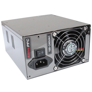

I see a three pin IEC socket.MJL21193 said:Computer power supplies are complete, stand alone units with the safety earth connected to the metal case internally.
Where is the confusion?
