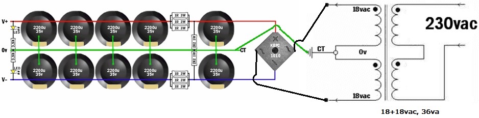

What is the DC voltage of the rails (output of your power supply)?hi Daniel, newbie here just finished building my first LM1875 chipamp

What is the amperage or va of your transformer?

Move the PSU snubber to the transformer secondaries.
He's right.
Those RC's go on the AC side of the bridge rectifier.
In that locale, they cannot harm audio.

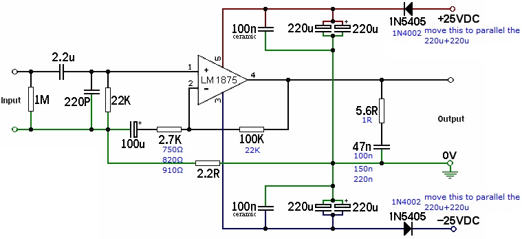

Thanks! Daniel. So the latest Turbo II schematic is what is linked in your signature, right? This?:
And should I use this as the PS for each mono block? Please suggest better or improvements because after all, an amplifier is only as good as its power supply. Or should I build this [https://www.quasarelectronics.co.uk/kit-files/smart-kit/1217.pdf] P2P?

Change the carbon resistors to metal film <=100ppm/C 1% tolerance.
Starting from the left.
1M ok, 2u2 ok, 220p ok, 22k ok, 100u ok, 2k7 becomes 750 or 820 or 910 depending on what gain you need, 2r2 might be OK, maybe a bit higher for a stereo build and needing to attenuate interference current.100k becomes 22k to match the input for lowest DC output offset, two 100nF ok, four220uF ok, or two 470uF or two 1mF, 1n5405, change to 1n4002 or higher and move the diodes to parallel the decoupling caps. These will then prevent significant reverse voltage on the caps if a fault develops and if you make a mistake with the PSU, these will blow the close rated mains fuse at start up, 5r6 becomes 1r and 47n becomes 100n or 150n or 220n
I don't know where you got that sch from but it is rubbish.
Which sch. is rubbish? The PS image that is in my post? I got it off the first post in the thread. What do you recommend?
post586 amp sch is rubbish.
That's the one immediately before my reply explaining what to keep and what to change.
Needing 7 changed component values cannot be good!
Oh and it needs a defined source impedance to get the RF attenuator working within a defined range.

OK, read my post 580 and Daniel's response to that in 581. In that he recommends building the Turbo II version of his take on this amp. The Turbo II schematics are in Daniels signature which is what I linked to.post586 amp sch is rubbish.
Is that the only reason for you saying it is rubbish? If yes, then with the changed values that you provided, does it cease to be rubbish? If EVEN with the changed values that you provided, it still remains rubbish then you should not leave it at that. I suggest you spell out why exactly it is rubbish and give Daniel a chance to explain why he used what he used and where he used it. Maybe you can post a schematic that according to you is not rubbish and once everyone agrees that it is the bees knees, I'll build that instead of Daniel's schematic.Needing 7 changed component values cannot be good!

OK, will do. Thanks!Do those 7 changes to get it working properly.
The two input filters will define the amplifier passband.
You select component values that ensure the amplifier works properly within that passband.
Then you select feedback values to give the gain you require AND give zero output offset.
and finally you follow the manufacturers advice on supply rail decoupling and output loading to give stabilitiy.
Only when someone has produced evidence that the manufacturer has got the stability components wrong do you change them for the better.
I am very suspicious about the 1r0 for the output Zobel, but my suspicions are worth nought because I have not seen any evidence that it should be different, or will be more stable.
I do advise you fit the other half of the Thiele Network to make the amplifier more tolerant of reactive loadings. Try ~1uH in parallel to ~3r3 to feed the output terminal and at the output terminal, add in a snubber R+C of 10r+100nF. This attenuates RF interference that tries to get back into the NFB route to get amplified at the -IN pin.

Guys, any comments about the PS in post # 586? Adequate? Good? Can be bettered by this <please post schematic>.
Where is the 1r0? There is a 5.6R+47n as a Zobel.I am very suspicious about the 1r0 for the output Zobel, but my suspicions are worth nought because I have not seen any evidence that it should be different, or will be more stable.
There is no Thiele network. AFAIK, an LR combination is a Thiele network, so what is this other half that you are referring to?I do advise you fit the other half of the Thiele Network to make the amplifier more tolerant of reactive loadings. Try ~1uH in parallel to ~3r3 to feed the output terminal and at the output terminal, add in a snubber R+C of 10r+100nF. This attenuates RF interference that tries to get back into the NFB route to get amplified at the -IN pin.
I think I now understand what you are telling me. Correct me if I'm wrong and let me know if I'm right:I do advise you fit the other half of the Thiele Network to make the amplifier more tolerant of reactive loadings. Try ~1uH in parallel to ~3r3 to feed the output terminal and at the output terminal, add in a snubber R+C of 10r+100nF. This attenuates RF interference that tries to get back into the NFB route to get amplified at the -IN pin.
1. Ditch the current zobel values and instead use 10Ω+100nF as the zobel [snubber] values.
2. Put in a Thiele network of 1uH with 3.3Ω.
not quite.
The Thiele Network is a combination of R+C from output to ground and an L||R from output to load.
The R+C is a Zobel but is only half of the Thiele Network. It needs the L||R to complete this.
The 1875 datasheet shows the 1r0+C for the Zobel, I did not read the notes, to see if they mention the L||R. Most amplifiers benefit in improved stability by fitting the Thiele Network.
The final 10r+100nF is an extra to help with RF attenuation of interference being picked up by the speaker cables and being injected into the -IN pin to be amplified.
