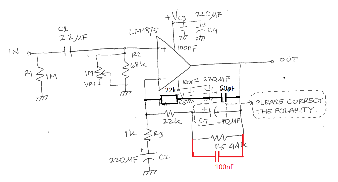

Report on Cherry's NFB LM1875.
It's the zobel network that I missed!
Another note on Zobel for this attempt, put that Zobel network as close as possible to the chip (well, this has been recommended previously by senior members of this forum).
This is different from my previous build with 12-0-12 tranny, I put the zobel at the speaker terminal instead of near the chip.
Any further thought on the optimum Zobel network values?
Thanks for your suggestions.
(Edited)
Checking the gain.

Neville Thiele (according to the Cherry article) gave two versions of his Output Network.
Cherry tells us they both work.
The Two versions are:
a.) R+C in series shunting the Output Back to the Output Stage. Followed by a L and R in parallel to feed the output to the load.
b.) L and R in parallel to feed to output onward. Followed by a capacitor shunting the output back to the Output Stage.
Cherry expands on this and his article is well worth reading.
Note that in b. that when the inductor is at high impedance the R and C are effectively in series. They still operate as the conventional Zobel snubber .
Many say that b. version cannot work. Balderdash. It's their implementation that prevents b. from working.
The output Zobel depends on low impedance at high frequency and this demands that the Zobel uses short compact routes to tie the Output back to the Stage (effectively back into the local decoupling).
If b. is located at the far end of 12" cable that is not close coupled to the return cable, then you have added at least another 200nH (and more probably >400nH) of inductance before the C

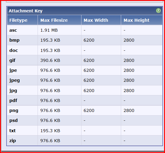

Can anyone see my attached .xls file?
I attached and when I look it is not showing.
So I went in and attached again and still it is not showing !
Solved.
.xls is not on the list of attachable files types.

Currently I am using 10R + 10 nF for my Zobel. Is it too low? But it works in improving the sound, I mean, without it the sound just got distorted and those are the components I have.
I wonder what makes the zobel network is so important in this implementation.
Please note, when I removed the zobel from my recent 22k/1k (not the one I gave as a gift, that one is not mine anymore to play with), it sounded terrible too. Perhaps it is due to the speaker? Or the transformer, perhaps the E-I type tranny is used for this experiement, while the previous build with 12-0-12 toroidal transformer was less-demanding of the zobel. Or is it the rail voltage of higher than 20-0-20 v?
What I noticed that without the zobel, using E-I tranny, the speaker lead from chip output to speaker terminal seemed to work as an antenna.

Most chip amplifiers run more stable/pleasant when if undervolted/derated.Please note, when I removed the zobel from my recent 22k/1k (not the one I gave as a gift, that one is not mine anymore to play with), it sounded terrible too. Perhaps it is due to the speaker? Or the transformer, perhaps the E-I type tranny is used for this experiement, while the previous build with 12-0-12 toroidal transformer was less-demanding of the zobel. Or is it the rail voltage of higher than 20-0-20 v?
It was probably the voltage difference.
Thanks Daniel. I'll check that later with a toroidal transformer of similar voltage rating.
And I am happy to report schematic of post 510 works well as expected with better bass response. A zobel network is a must which was not there in the schematic.

I use a dual cap (back to back) in that position (sometimes a quad if I have the space).
An inverse series connected pair of 10uF+10uF equals an effective 5uF that is resistant to AC voltage.
Or a parallel pair of 10uF+10uF for a final effective value, using 4 capacitors, of 10uF.
BTW.
that polar electro with the +ve to the left suits a BJT input stage that has PNP transistors for the LTP.
For NPN LTP the polar electro needs to reversed.
But consider using the back to back instead.
BTW.

plgsekip, you can use the RC calculator at my startfetch.com RC Calculator by firstly putting in the component values for an RC that worked but wasn't strong enough, such as that 10R-10n example, and then write down the frequency and proceed with increasing the load, involving a smaller resistor value, while maintaining the same frequency. This comment assumes that it was the frequency you liked, but the load was too tiny for effectiveness. That is likely the case with the very small value examples.
For example, 4.7R with 22n pulls a lot more current than 10R with 10n, although the RC frequency is quite similar.
Likewise, if you've altered the voltage of your amplifier so as to produce 400% wattage, then could be reasonable to assume that many of the resistor figures will have to be current adjusted to compensate for that rather astonishing (and potentially destructive) difference of scale. That 20-0-20 transformer voltage is a bit too high.
