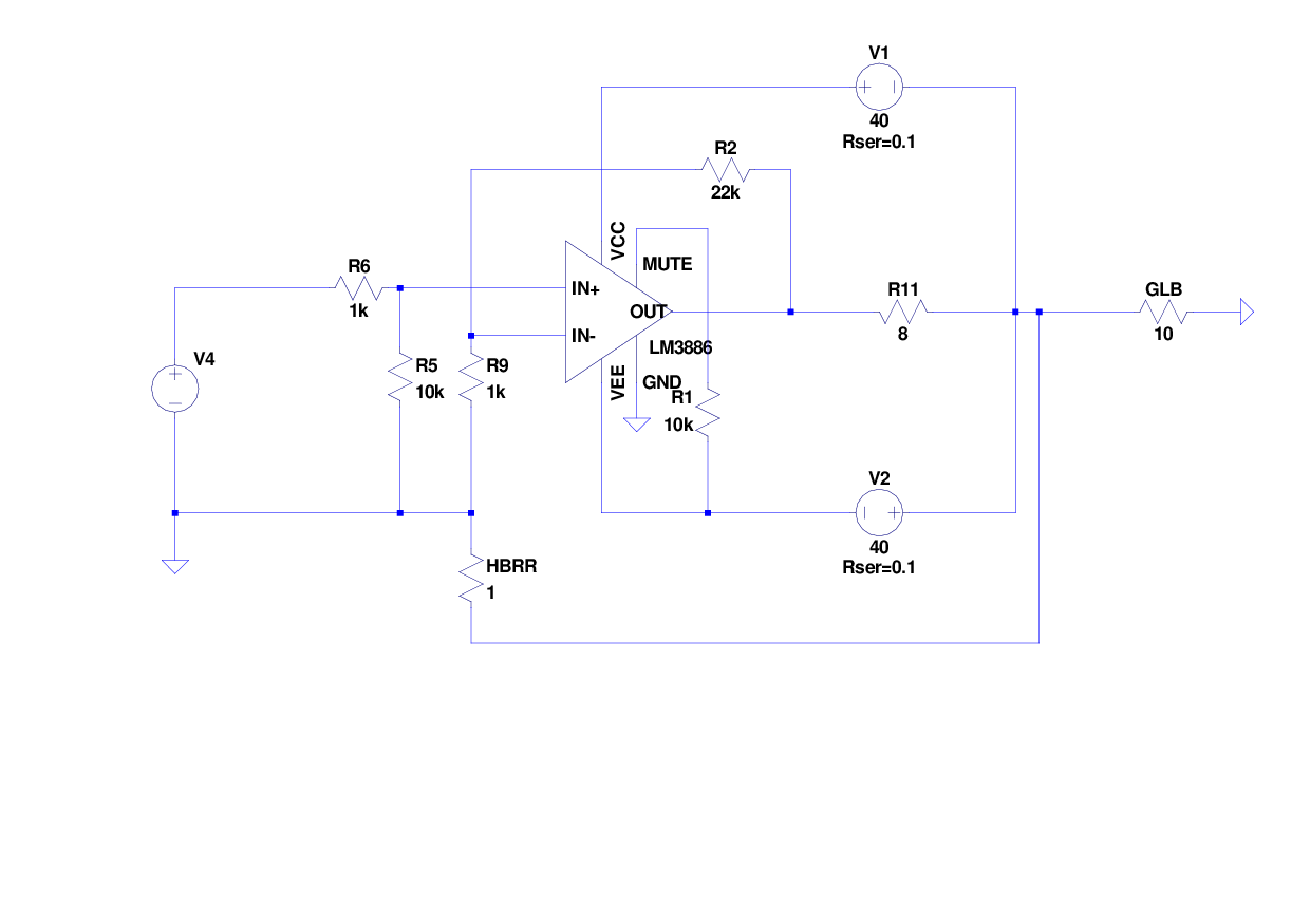

Mark, the three "grounds" in your diagram are all different.
Could you show three different symbols?
triangle, three bars and the E with a legend describing which is which.
I like the E for the Chassis, since in my head E = Earth, as in Protective Earth.
I use the three bars to indicate Power Ground. This tends to be the most commonly used by Members.
I use the empty triangle for the Signal Ground/Return.

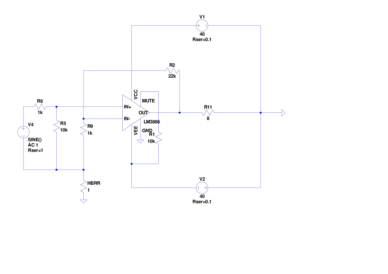

Schematics are made with LTspice and therefore more about doing stimulations than (ground) layouts. I also wanted to connect the resistors to a single point and make a star ground at the output but this was not possible.

post 561 shows three ground symbols. They are all the same. They are all Power Ground.
Post562 also shows three ground symbols. In this case they are all different.
One each of Signal Ground/Return, Power Ground and Chassis.
The GND of the opamp should have connected to Power Ground, the other two are PE. The source is connected to PE and the amp is connected to PE.
yes.The GND of the opamp should have connected to Power Ground,
no.the other two are PE.
The source ground symbol is actually signal return. It does not get connected to the PE protected chassis. It's because it is the signal return that I recommend that it deserves a different symbol. That avoids the confusion caused by adopting the same general "ground" for everything.The source is connected to PE and the amp is connected to PE.
The one one the far right is on the other isde of the GLB. This ground is actually the PE protected Chassis. Again it avoids confusion when a different symbol is used to define it's uniqueness.
AndrewT, you are not understanding the schematic. The signal return has already been drawn, it runs from V4 to HBRR. The source has it own connection to PE as it is CLASS I and has its own chassis.

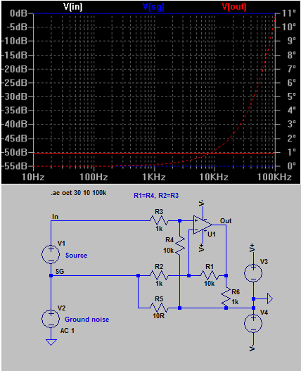

What Daniel has done is to add a voltage in the ground loop to simulate the hum at the output. It would be interesting if he could do simulations of the different configurations.

V4 (the Source) should not be connected to PE.
That is fundamental to all our projects. We see the same recommendation often. Do not connect the RCA barrel to Chassis. It is our rule.
Not connected at the RCA. The output of the source is connected to 0V of its PSU which will be connected to PE for Class I.
No, you could use a GLB at the source between power GND and PE. The HBRR goes between input GND and power GND.
If the source is a pre-amp, you could just copy the schematic of the power-amp where output GND connects to power GND.

There is no current drive aspect to this design. Only a control of ground loop currents and voltages.
If all Class I AV equipment was designed this way there would be a lot less ground loop problems.
Just connect the output returns to 0V (GND) with a GLB to PE and a resistor separating each input GND and 0V (GND).
or try both options.
put a GLB resistance in series with V2 with R4 as at present. Compare
move R4 and compare
reduce GLB resistance to 1mohm and compare.
4 results to compare.
move R4 and compare
You can also see if there is any difference with higher values for GLB.
R5=1 and GLB= 1 or 10 or 100.
Daniel, I could not replicate the results from post #557, can you post or mail me the sim?
