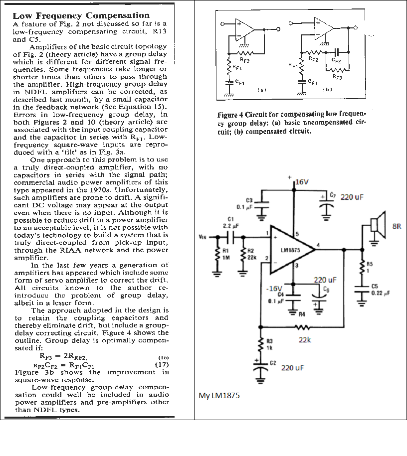

Hi AndrewT and all other members,
Here is the schematic for my LM1875 as well as extracted materials from Dr. Cherry's publication on LF comp.
Please help on finding the "correct" value. 🙂 Has anyone done a simulation on this LM1875 with Cherry's LF comp?
Thanks in advance.

starting with R3=1k and C2=220uF.
Gain is 23times.
The added resistor is 44k (use two 22k in series) = RF3
The added capacitor CF2 = R3*C2/RF2 = 1k*220uF/22k = 10uF
Change R2 from 22k to 66k (use 68k and add a 1M or 2M parallel trimmer to set the output offset to zero mVdc, then replace trimmer with the nearest value fixed resistor).
C1 = C2 *R3 / R2new / sqrt(2) = 220uF*1k/66k/1.4 <= 2u38F (use 2u2F)
Your LF bandwidth has increased from 3.3Hz to 1.1Hz
You could reduce all the capacitors by a factor of 2.2 to
C1 = 1uF, C2 = 100uF & CF2 = 4u5F, for F-3dB=2.4Hz
or reduce by a factor of 3 to
C1 = 0u68F, C2 = 72u6F, CF2 = 3u3F, for F-3dB=3.5Hz
In these latter two cases you are allowed to use capacitors substantially smaller than the original and still have adequate LF bandwidth.

Thanks. Please allow me some time to build this. 🙂 I am interested to try it, especially on the trick of making zero dc offset. And I suppose all the capacitors are of the electrolytic ones, except for the C1 (input cap).
BTW, the 10k pot works better than 100k or 20k.
Certainly. We don't know whether your source will perform better with a lighter or heavier load. So, you'll need to try, to find out.Hi Daniel, I have read the post but could not find the reason why you changed 22k to 15k. Could you elaborate more on this?
If your feedback resistor is 22k and feedback-shunt resistor is 1k, then it is possible to use a range of input load from 4.4k to 21k.

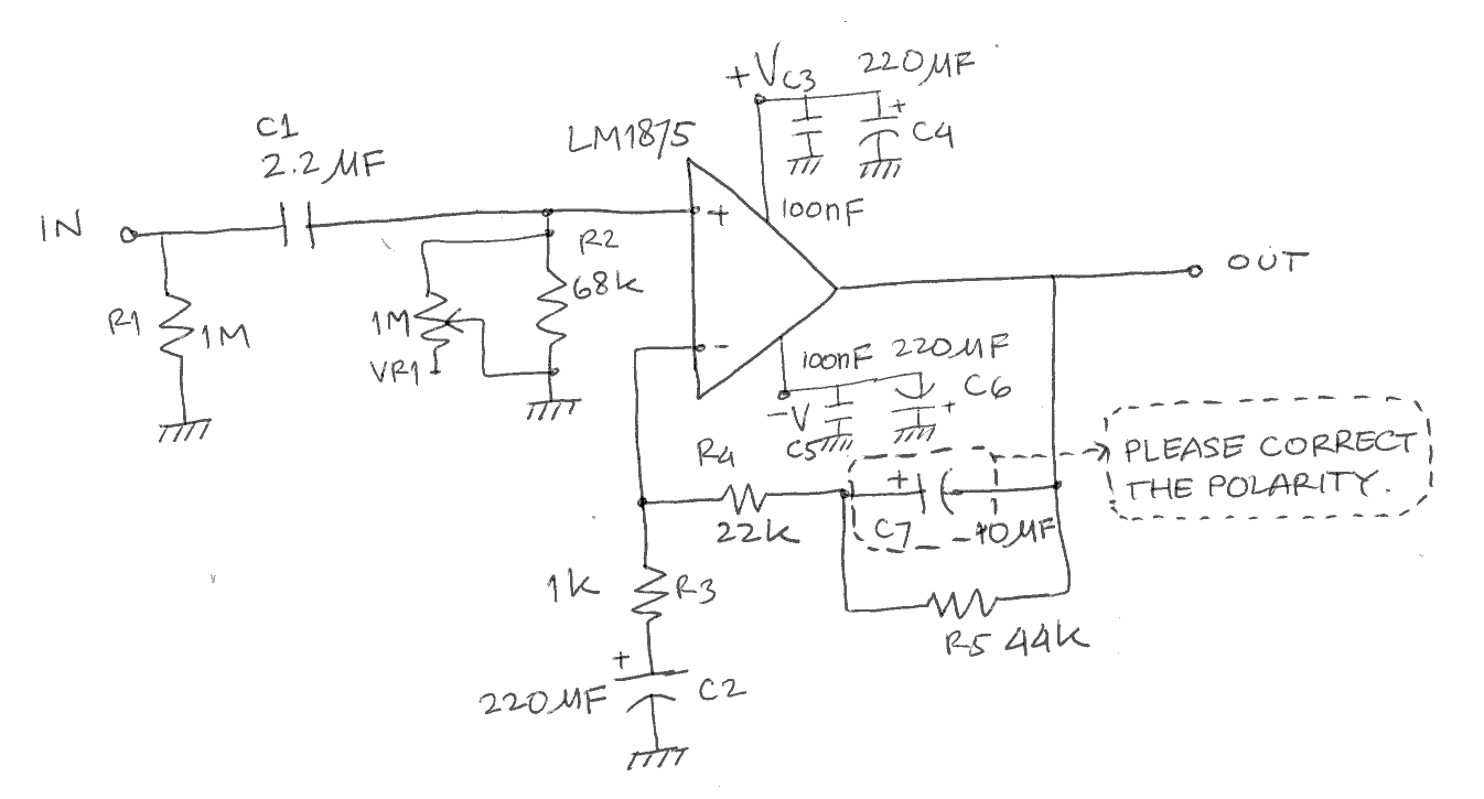

LM1875 + Dr. Cherry's LF Compensation
As promised, this is the schematic. Please help checking the component value especially the polarity of capacitor (C7) in the LF compensation feedback. It is a 10uF and I guess it should be of electrolytic type.
As the total feedback resistor is now 66k, isn't the gain of my amplifier now 67 times?
I assume that the input impedance Rin should be equal to total gain feedback capacitor. 22k Rf and 22k Rin, now 66k Rf and 66k Rin, and if one manages to equalize them (Rf = Rin) then zero mV of dc at te output. Is it correct?

the 44k is in parallel to the 10uF.
The feedback is dependent on 1+{upper impedance / lower impedance}
At VLF the 10uF has an impedance and affects the gain.
But using the formula given by Cherry, the impedance of the 10uF is much smaller than the 44k through the whole audio passband range.
It's the same for the lower capacitor. It too has a VLF impedance, but in the audio passband range it's impedance is much less than the 1k.
Measure the DC across the electros. They will be in the mV range. You can then orient them in the correct polarity.
But I used back to back electros that I reformed to the full 50Vdc before installing.
They will hold a very low leakage for a long time and are tolerant of a small DC offset as well.

Thanks.
I forgot that cap impedance varies with frequency. So, assuming 1 kHz, then the upper capacitor's reactance is 1/(2*pi*1k*10u), i.e. ~16R which is in parallel with a 44k still yields approximately ~16R which is in series with a 22k and the total upper impedance is ~22k.
The same rule applies to lower impedance, lower cap reactance is 1/(2*pi*1k*220u), i.e. ~0.7R which is very small value. Hence the lower impedance is about 1k. Interestingly, because the impedance at low frequency, say 20 Hz, is approaching 1k, then it will affect the gain at lower frequency and leave out the higher frequency. Very clever.
So for 1 kHz and above, the gain setting is about the same as the original circuit. I am planning to use a bipolar/non-polar electrolytic, I think it's easier. 🙂

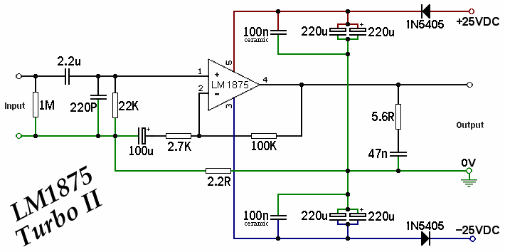

can someone please explain the purpose of the diode on the 25V power rail. Thanks.
Do you mean the top schematic?
There are two diodes, one in each supply rail.
these will protect against reverse/wrong connections of the dual supply rails.
I prefer to install the protection diodes (1n4002) across the first set of capacitors on the PCB. These don't lose any voltage. They also pull current through a wrongly connected PSU and turn on the Mains Bulb Tester. WARNING !!!! something is wrong !!!!!
Then check voltages and you will find the amp and the capacitors are limited to less than 1V of reverse voltage, equals no damage.
The diodes have a second function. They act like a veritable resistor between the PSU and amp. High resistance for low current demand and a low resistance for a high current demand.
I have been experimenting with a parallel diode and resistor combination that works very well too.
Hi Daniel,
I just create single layer pcb layout based on your LM1875 Turbo II with little modification.
for C NFB, I prepare to use bigger value, so I add C9 --> C8 || C9
for R NFB / Gain, I use R5 20K with R6 1K.
and I remove the diode in V+ and V-
I need some opinion, suggestion on this layout before I make the pcb
That's not a Turbo II at all.
Most problematically, the lower gain shown (of the datasheet schema) can cause the need of lower voltage (not more than 17+17vdc rails) and you'll need all FOUR output filter pieces mentioned in the datasheet, the output RC (from the datasheet schema) and the L||R (in the stability chapter). So, because of copying the datasheet schematic, you'll find your output RC values also in the datasheet, but what they didn't mention is that the cap for it is a polyester dip or mylar dip cap (green or red blob), not a box cap.
C9 and C8 are clever that way; however, the odd "V" shaped space in the ground track between the caps, needs filled up solid. Also, the 100u value is too small (because datasheet schema's 1k) so use, conveniently, 220u (or preferably 270u) for all of the big electrolytic caps.
The 100n caps are shown a box shape; however, it is more likely that you'd want a Ceramic X7R or even inexpensive ceramic disc could work better than a poly at that location.
Also, you need a separate track for the speaker return.
The Turbo II did need an update to show a "groundlift" resistor, which doesn't do much for or to audio but REALLY helps with layout.
2.2R groundlift is shown. The value is plenty big enough to help with layout. 😀 However, if a larger value is used, such as 10R~390R, parallel the groundlift resistor with a little cap to prevent treble droop.
