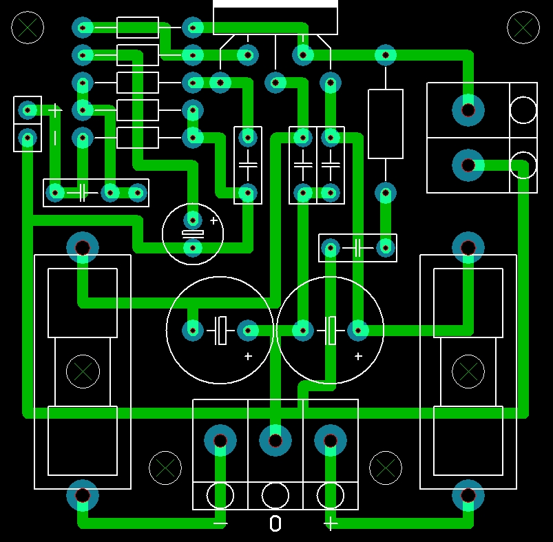

My lm1875 has a dark voice,not very energic,what could i try to do?
I bet that Daniel will have some ideas.
What schematic did you use?
Check that you haven't accidentally made any low-pass filters, either at the input or with the feedback.
Make sure that you have some smaller electrolytics very close to each of the chips' power pins, with short paths to ground. At least 470 uF for each power rail is recommended by National. You might have bigger ones, already. But also having some smaller ones, closer to the power pins of the chips, could help the highs, and the transient response, and the imaging. Two or more smaller ones, in parallel, should also be slightly better than one larger one.
Also make sure that you have a very physically-small 0.1 uF (probably X7R ceramic) cap right AT each power pin, directly to a very close ground. Otherwise, you could get ringing or oscillation at RF frequencies, which could also change the character of the sound. (You should also have RF protection on the input. Just make sure that the low-pass filter for the RF is not accidentally set TOO low.)
If you have all of that, then the problem would probably be in the feedback network or the input network, with something making a low-pass filter, somehow.

Comments on PCB design for TDA2030a
Dear All,
I have designed a PCB for a stereo TDA2030a chip. This PCB is already made & I have built one prototype...it is not working as expected! (made this long time back before knowing about this forum 🙂)The chips get heated too much & i get 60-70 KHz on output on my DMM.😕 I have gathered that this chip is very similar to LM1875!
Can all of you please comment & help me improve this?
