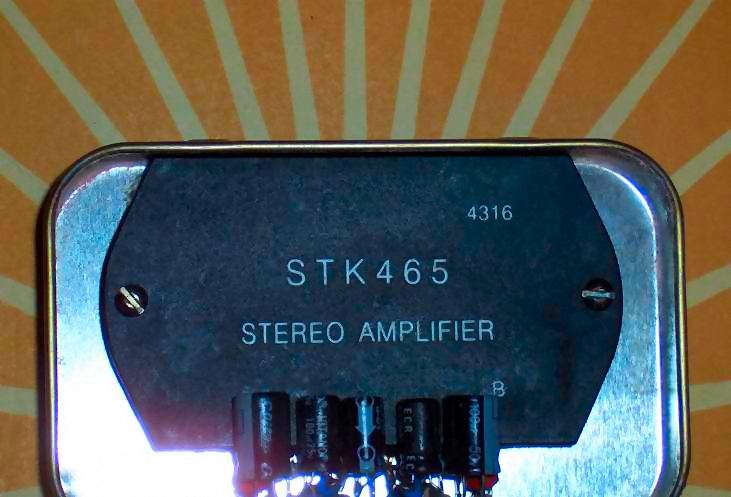

Actually I don't, so howabout the fun puzzle of an STK465 point to point instead?
With so many pins that the soldering will be more fun than LM1875's simple 5 pins.

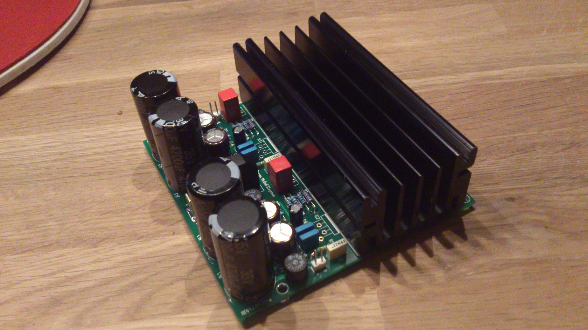

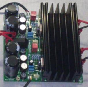

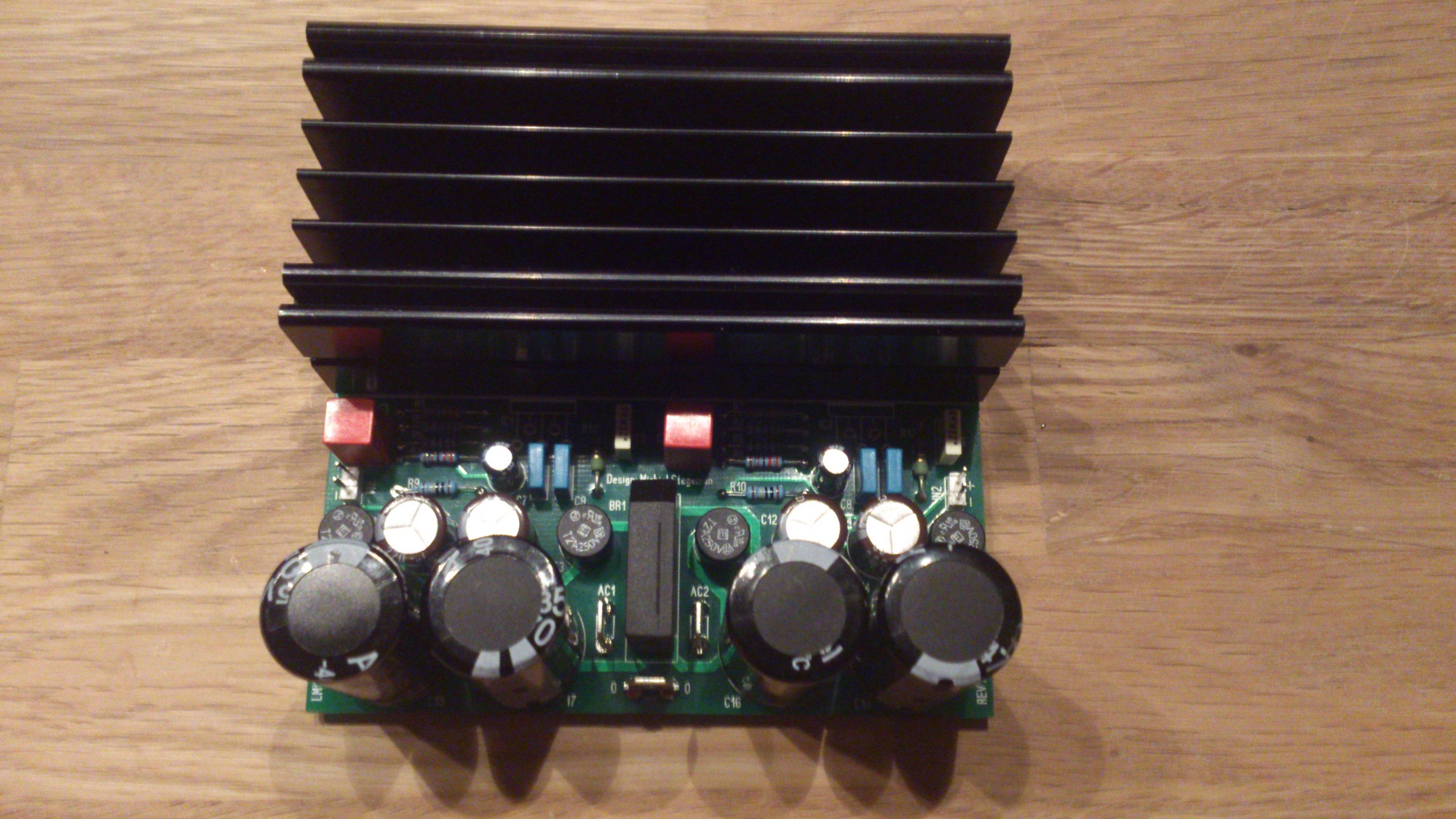

I have almost finished my version of the stereo LM1875 amplifier with onboard powersupply and cooling. I still need some M2.5 bolts for mounting the LM1875s. In the PCB design there are holes under the heatsink for improved heat dissipation.

Looks like you are about to bolt the chipamp to the side fin of the heatsink.
The heatsink is designed to reach thermal specification when the device is bolted to the backplate and uses the whole backplate as the interface.
Each time you reduce this the chip will run hotter.

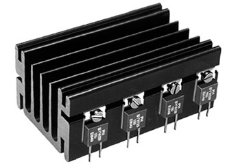

I use this heatsink and they connect the transistors also on the side.According to the website this heatsink is designed for PCB mounting.

Yeah, that heatsink is not quite big enough for 2 LM1875's at full blast.
However, my idea of full blast is very scary.
It might handle 2 LM1875's with normal use.
But, I've never tried that. :D
I demonstrated the amplifier on a DIY audio day here in the Netherlands for several hours at pretty high volume and it never ran warm (15-0-15V transformer / 8 ohm speakers)
People were really impressed by the sound quality of this small amplifier, especially when taking into account the total cost (25 euro for PCB / heatsink / components)

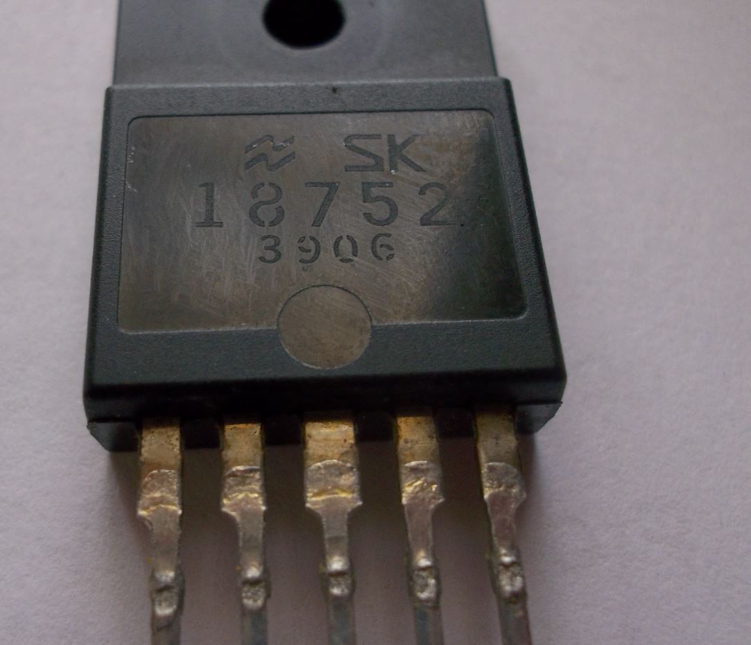

HI .. I like this thread .. I don't have any lm1875. I do have SK 18752 Rescued from a sony A/V surround amplifier . I have searched the web and from what little I found the pinout of this device is the same as lm 1875 . Is this IC A lm1875 in a top3 case.

According to Sony and Denon repair manual schematics, Sanken SI18752 is pin compatible, a little faster and a little stronger, so it is probably not an LM1875. You may need either really high gain or extra work stabilizing. This high gain schematic may work with the SI18752 if you increase the 100k to 115k. Anyway, this one is fairly close.

the double wave logo is not National Semi.
The coding is not lm1875.
Both the SK18752 and the lm1875 are 5pin devices.
That does not make them the same !
