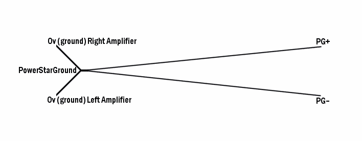

Thanks guys- Well I have it wired up and working 🙂
I'm not sure that it is wired correctly; especially the ground connection. It's measuring 24.7acv at the amps. One concern is that the LM1875 is getting pretty hot after only a few minutes of playing 😱
Any advice would be most welcome.
Are the little horizontal heatsinks at the top left and bottom left your chipamp heatsinks?
If so, they are far too small. They have less area than the bare rectifier diodes which only have to get rid of less than a couple of watts in total.
Use the National datasheet guide and then double what they recommend.
In regards to the mind blowing photo above, firstly, please keep all metal scrap at least eleven feet Away from your workbench.
And,
That is NOT a power supply board--that thing is a dual bridge rectifier board, same as 2pcs KBU1004 except for price. Where is the 0v?
It isn't on that board.
A problem is 0v tap for the power supply is either missing or not readily identifiable. See attachment for a remedy. It shows simplified grounding for Stereo builds with Audiosector power.
