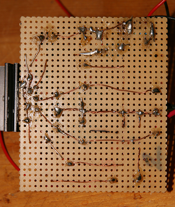

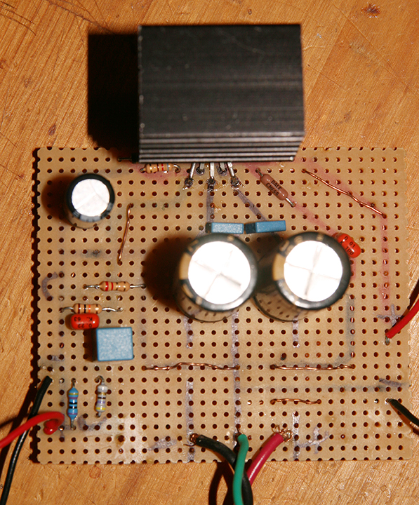

I need you help again- it seems I have screwed one of the boards up again 😱
After installing the pots one channel is working good. The other doesn't do anything at a lower volume and crackles really loudly when I turn it up. The music is playing. When it first happened I thought it was the pot so I took it off. The noise was the same. Then I put the pot back on- same thing.
I have looked at this thing for hours comparing it to the one that works as well as this pictures you posted but I can't see anything. The circuit checks out ok. Power at the amp is 24.75 with 0 dc offset at the speaker. I've tried 3 different speakers but it's always the same noise.

Well, I've stared at it for a good half hour and didn't see anything. But I could not quite identify all of the connections near the little red and blue caps. So, I've got to ask, if you measure between 0v and Pin1 with your ohmmeter, does it do 10K or. . . something else?
Thank guys- In measuring between pin 1 and OV i get 9.9K.
I've looked at the board carefully with a magnifying glass and can't see any broken connections.
The 9.9K is okay.
I see some solder quite close to the heatsink--we don't want it touching the heatsink.

Is the noise like a radio static crackle or is it like "flip, flip, flip, flip" sort of noise?

I have uploaded a shot video to youtube so you can listen to what it sounds like. There is no solder on the heatsink.

That wasn't the slow stead rhythm of the overload sound. Oh, much different!
Be sure to drain the power caps (by applying 50R resistors, not fingers) measure to assure the absence of voltage, and then make really good use of the ohmmeter to compare the board that works against the board that doesn't. Note: Don't modify the working amp board--Just measure it.
You might want to check the feedback and feedback-shunt resistors as well as the nfb-shunt cap and ground--trace around that whole area to see if it matches up with the other board.
If that's all good, then trace all over the input circuit to see if it matches up with the other board.

Re-heat all solder connections that are on the bad board. Check with some swapping resistors and caps to see if you can "move the problem" preferably away from the amp board--for example, the ohmmeter won't spot bad caps, but you can swap in some different caps, one at a time, to see if they work differently.
and then,
If you've eliminated all of the other possibilities, then a chip might be broken.

The type of copper used there appears to be coated with a clear insulating material (else it would not be so shiny). If, perchance, a solder ball is merely laying atop the copper, it might not have penetrated the clear coating. Applying some Gel Flux and then tinning the copper a bit to be sure the solder really sticks to it, might help assure that a connection exists rather than just the appearance of a connection.
So, while you're re-working the connections, don't forget the Gel Flux. 😀
