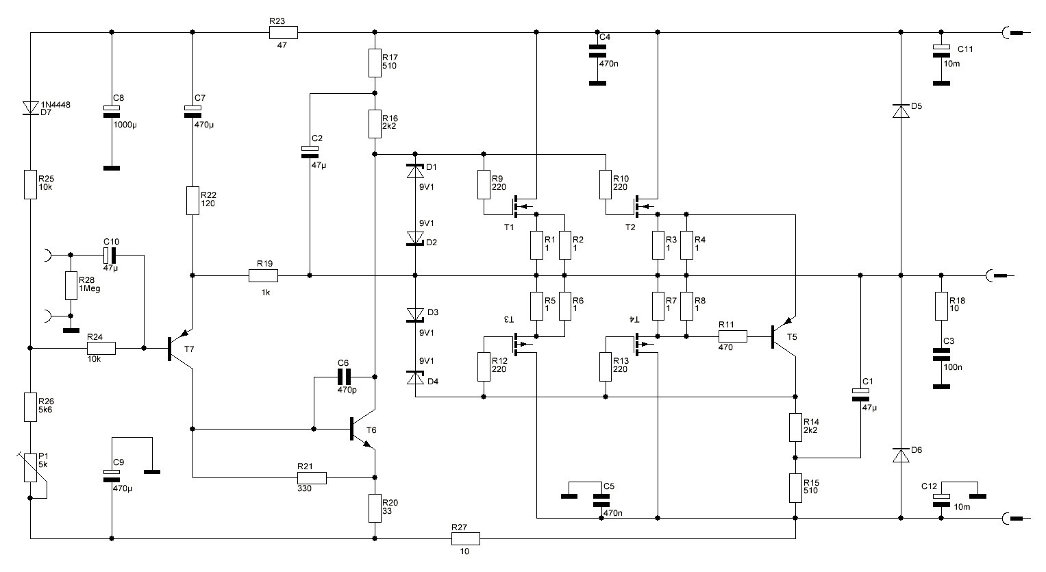

T6 need an emitter follower buffer or else the distorsion will be gigantic, we re talking a 20dB or so higher THD
and IMD with the current schematic, beside the IPS current is uselessly high wich mandate a uselessly high
compensation capacitor that increase distorsion
This topology shortcomings are well know at this point and one can design a much better sounding amp than
the Black Devil wich was a popular such design in the 70s.

What will the designed rail voltage and why is R21 so low and connected to T6's emitter rather than the negative rail?
Good question, so that 25W are possible, i.e. +/-25Vdc.
I will leave the second part of the question to speculation - for the time being.
I hope this doesn't upset you - I'm in a bit of a hurry.

I ll throw the thing in the simulator once i ve some time left, but a question, do you want to keep the IPS
current at about 2mA.?.
And when i say gigantic THD i mean something that is 0.03% at 1KHz, sure that class A help a lot to linearize
the OS but what is the point to dissipate something like 90W, like in the AlphaNirvana, while lower THD can
be achieved with a cautiously designed AB class amp even when using this Black Devil inspired topology.?.

Good observation.I ll throw the thing in the simulator once i ve some time left, but a question, do you want to keep the IPS
Not necessarily, of course. But I don't want an LTP. However, the choice of BJTs is completely up to you.

As you surely often experimented it the devil always hide in some details, and here it s in the current limiter.
If the load is too low and that the negative side saturate because of lack of output current then the recovery
will be awfull, to improve the thing a 470pF capacitor must be connected from base to collector of T5.
Even without saturation it is necessary because otherwise this transistor create a pole at high frequency,
i guess that in the AlphaNirvana this is also tamed by a random serie of lead capacitors wich in principle shouldnt
be necessary if the thing was well designed, wich in my opinion is not the case, that s not all to find a fancy name
to make an amplifier performing well.
Also, what is your pojected transformer s AC voltage.?.
In principle this kind of connection should help increasing the VAS input impedance and hence the input stage gain,
but here it s not of big effect because the VAS has low gain and low input impedance anyway, also the value of this resistance
set the input stage current since the feedback will set the voltage through this resistance at the necessary value to reach the VAS Vbe voltage.

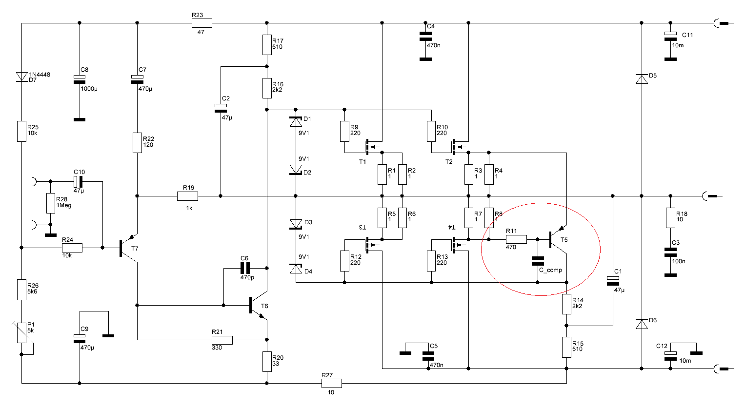

I'll have to think again about an additional C_komp parallel to the base-emitter path of the T5. But its installation, should it actually be necessary (and that is not at all unlikely), can also be carried out on the object itself at any time without any problems.As you surely often experimented it the devil always hide in some details, and here it s in the current limiter.

Thanks Wahab for this reminder, let's not forget Beelzebub is an incredibly quick thought and also a reaction to the nice sounding Alpha Nirvana stuff - whose compensation scheme I (personally) find completely off the mark.
AC-Voltage? min. 2 * 18Vac!

base-collector-pathI'll have to think again about an additional C_komp parallel to the base-emitter path of the T5.
sorry 😢.
