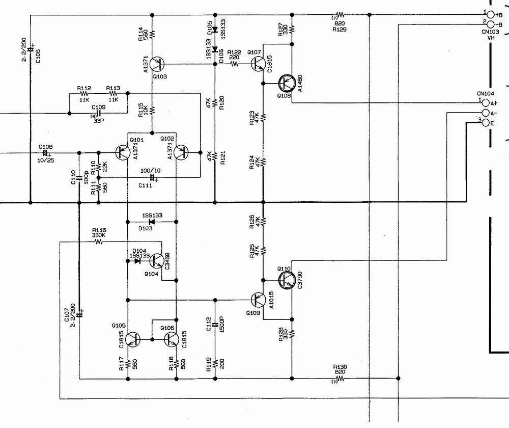

This schematic uses superpair for VAS and VAS load. Will this oscilate?

Hi peufeu
going back to the start of this thread ...
the Baxandall pair is an inverter ... so perhaps you just need a small resistance in series with the input with a small Miller capacitor connected from the collector of the output device to the base of the input device.
I'd suggest 1kohms + 10 pF ...
cheers
John
