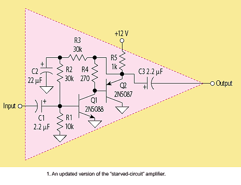

in this case this URLs also of interest:
The "Starved-Circuit" Amplifier Is Revived In A Transistor Version
and
Compound vs Darlington
and
