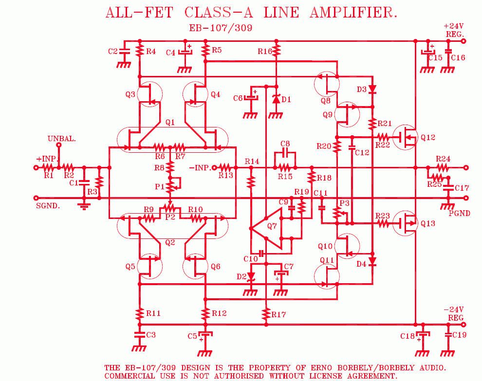

Most people seem to reference the cascode voltage to GND,
but the best thing, IMO, is to reference it to the source/emitter.
Is is easier to reference it to GND. Even Hiraga did that in his (and his buddies') "le Monstre" class A power amp.
Attached is Borbely's way of using a high Vp JFET:s own voltage for cascode DC voltage. Very elegant!
Not sure that only 2-4V is optimal as cascode voltage, though. I often use 10V (for 2SK170/SJ74).
Sigurd

Walt - driven cascode is a nice way of putting it. One might want to add telescopic for even more detail. Ie,
driven telescopic cascode (DTC).
Attached is a simulation I did on different telescopic cascode circuits. Both cascodes with the cascode transistor referenced to GND and also DTC.
Rather interesting to see how much better it is to use driven cascodes when high BW is wanted. Almost 10X more BW with a driven cascode compared to a cascode that is referenced to GND
Sigurd

Walt,
Great to see you here again!
Erno, if you read this, any additional comments to this concept?
Jan Didden

Back to the questions at the beginning of this thread:
I'm finding in sim, and supported so far in breadboard, that a single small output capacitor to common as suggested by Jan is quite effective. Things can get messy if lead/trace inductances get significant, so a tight layout is recommended. And as something to be embedded in the middle of a feedback amplifier, especially one that may locally load the output with a frequency-dependent impedance (like a compound e-follower), especially one that can present a negative impedance at some frequencies, the required compensation will necessarily change. See jcx's remarks earlier about this situation.
As a single stage, the output C loading seems to have a disproportionate effect---it is not just a "brute-force" single-pole rolloff. Undoubtedly this would emerge from a proper analytical treatment. Odd that such has not yet shown up in the literature I've seen.
These results hold qualitatively for the various superpairs and variants, whether used as voltage amplifiers (well, really gm cells driving resistive loads) or as current conveyors driven with current signals, or as static current sources in which they are used as a compound common-base-like stage to buffer a simpler current source, or when that latter circuit's output is "probed" for output Z peculiarities by a current generator applied to the output node. However, the optimal output capacitor to common varies in each specific situation.
In cases studied so far, the capacitances required with garden-variety medium-Ft devices are so small as to be likely contributed by most anything the circuit connects to. One breadboard current source for a triode plate supply used a pair with the NPN a 2SC1815 and the output device an MPSW92, with a few hundred uA in the NPN and a few mA out of the 92.
I wish I could help with more bibliography. My thanks to all for this thread and various private communications.
