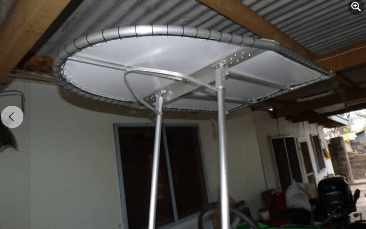

A kite/canopy about 8' tall would give good shade on board and on a patch of water and if mounted on a pivot system then can be used to take advantage of any wind to cruise to maintain a mooring stance. I picture a two part delta shape. A long frame on top of the booth roof holding the solar panel array and a wing either side of it that can deploy outwards for use as sail or extended shade. The frame on a pivot that can change angle of attack. The foils can be used to adjust craft trim. The pivot would be adjusted by the rear bimini pillars, which would have independent wind up and down action. Just a simple hand crank on each rear pillar
I have stockpiled all the carbon shafts and fabric and such for this purpose, as well as most of the aluminium for the super structure and bridge deck

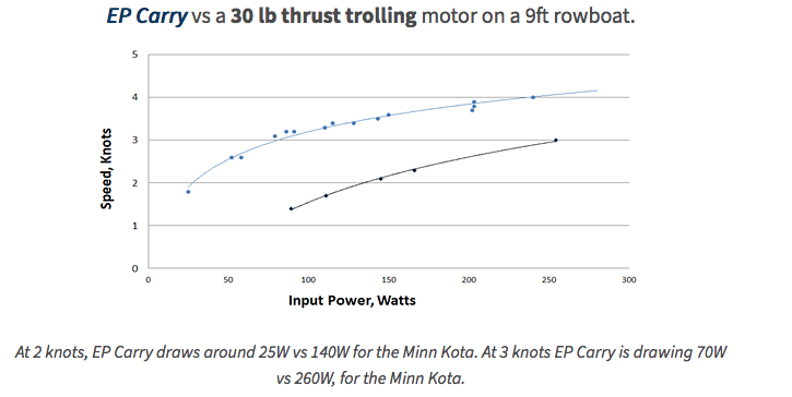

Yes.I feel that just alone, the 500w panel might keep the sounds and prop ticking along without loading the battery too much. Does this sound feasible?
In 2011, I used a ~120watt "Electric Paddle" on my FoldBote.
By the map we covered 5 miles out and back in 2 hours, so the speed was 2.5 mph, about 2.17 knots.
The Electric Paddle (no longer available, updated to the EP Carry ~220 watts) is far more efficient than a trolling motor due to using a high aspect ratio airplane style prop.
https://www.electricpaddle.com/ratings-epcarry.html

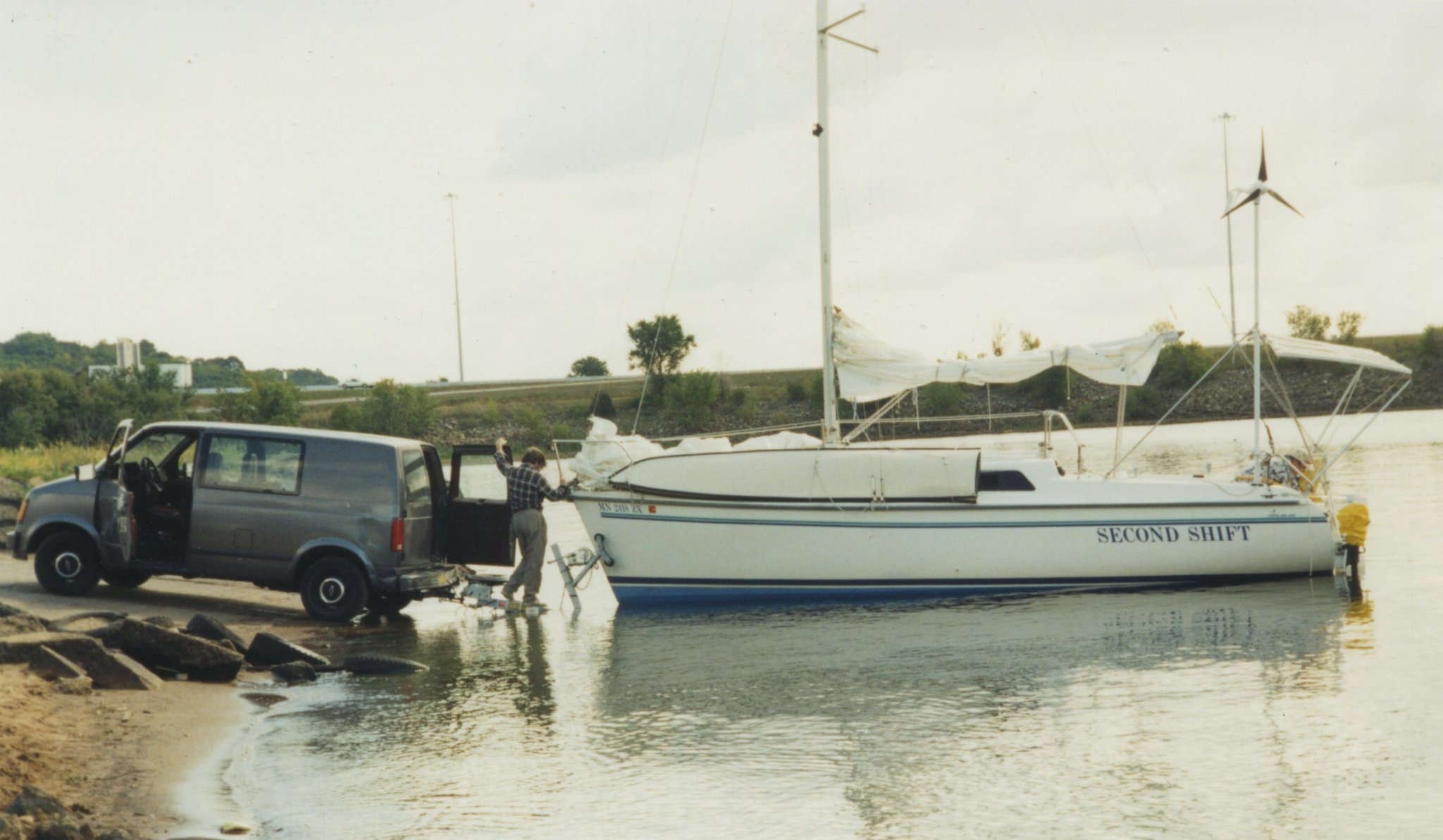

The FoldBote is folded up on the side of the "Second Shift", a Catalina 250.
Back in 1996 I used a 3/4 Hp (560watt) electric motor (under the yellow bag) on my Catalina 250 (25' foot, well over 4000 pounds with water ballast, speakers, two motors, batteries, solar panels, wind generator, passengers etc.). As I recall it did around the same speed, a bit over 2 knots.
The motor was probably not actually drawing a full 560watts, the outboard motor prop it was attached to did not load it fully. I had used the same motor on an electric bike in the mid 1980s, and a trike in the mid 90s, then a motorcycle around 2011, it could do 25mph on flat land at 560 watts.
Anyway, if your boat isn't fighting a headwind, it should be able to amble along with music blasting at two knots or so with 500 watts.

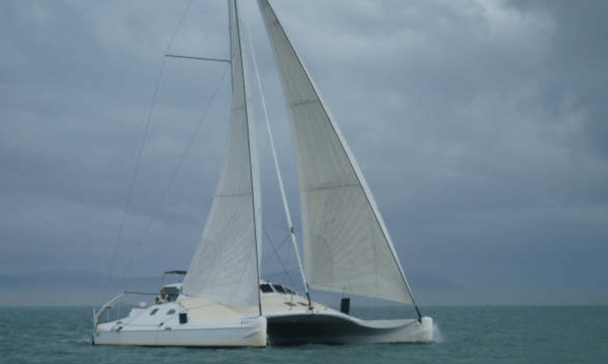

Found a pic that shows the type of sail deployment. Not huge like in the pic but general idea. I would have them as crab claw looking awnings either side of the solar array. To be raised to form bi-wings. Will be played with once craft is fairly well advanced in the build
This one shows a booth on a pair of hulls. My intention is to not have that permanent back wall. And the front wall to be plumb. The Roof pillers will be on 4 corners of the booth. If I make the back edge of the roof fold down, then it can cover the opening once the roof is brought down to be a lid. I suppose the same can be done to the front. So lets say a 1.2m wall height and 2.4m full roof height deployment and able to be inclined by shortening pillar height with shear pins
I think I might have enough aluminium on hand to get those two crossbeams up with a bit of tramp in between
The booth will sit on the deck similar to as shown in the pic above and secured with shear pins through brackets on the sides like those orange blocks. Since my motors will be on the sides on the back of the hulls, the booth can be taken off and placed on the grass as a land based booth complete with the solar system. Booth length is looking to be around 2m and width 1.8-2m
