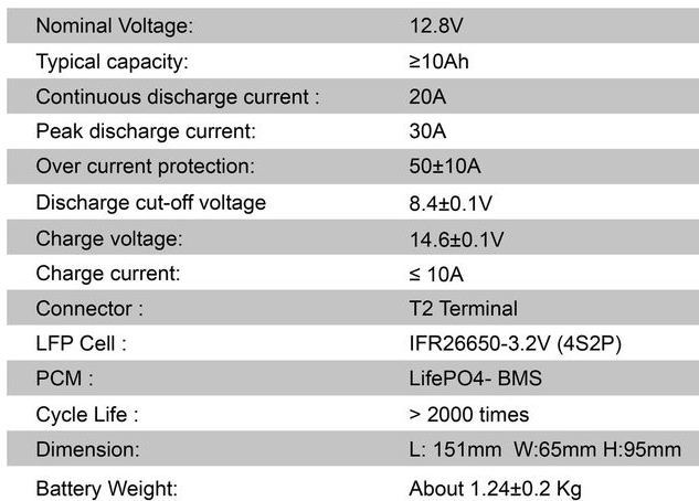

The battery
What do you guys reckon, will this be sufficient to drive the head unit and build in TPA3221 or similar amps for a few hours at polite volumes? Looking for recommendations for a charging interface from a lid mounted solar panel as well as a 12v DC port. An interface that would allow me to charge it while it's being used. Very confused as to the correct type of charging system. I am able to add another batter later

The battery
No. 1 hour at 7 amps draw. No documentation on that Android head unit as to how much current it consumes.

Depends on the battery and the load.Does an extra battery add another hours use?
To figure watt hours, just take the battery voltage times amp hours.
12v x 7AH = 84 watt hours.
Your system will have a quiescent load, the power used whether the music is playing or not.
Quiescent may be 5-15 watts.
Class D amps are generally in the 90% efficiency range above quiescent.
Music generally doesn't average more than 1/8th of the peak power.
A 96dB 1w/1m system would hit 106dB with 10 watts, so might only average 1.25 watts, under 1.5 watts figuring amp losses.

I think I will stick with the battery model linked earlier. It's nice and light and the proportions match the intended use. I am able to fit three of those in. The supplier is an Australian UPS builder, so this is a trusted source and free of quality issues and worrying about if it is a fake and thingsDepends on the battery and the load.
Load? You must have twigged on to the fact that I am floundering 'a bit' here!
Allow me to lean on you here a bit, please. Is it better to get those 10 watts from a small chip amp like a TPA3118 type or the TPA3221 that I picked? Maybe I am imagining this, but that dry short kick feels a lot more credible coming from a larger amp, even at very late night volumes. I keep wondering about whether this is about dynamic peaks. Or managing the back EMF from the big motors. Apologies if this sounds inane, I just spent the day in the sun on the beach with the baby and a litre of coffee!A 96dB 1w/1m system would hit 106dB with 10 watts, so might only average 1.25 watts, under 1.5 watts figuring amp losses.
I don't think we had the 1/4" conversation before, I had to look up the specs to see how low they actually are.
Switchcraft makes a 1/4" TRS with a nylon ring that can avoid the shorting problem. I used them in the 1970s after shorting problems before going to high power connectors that could not short-circuit amps.
Low power amps reduce cost and the quiescent load, but it's better to size an amp for the use, if you clip a small amp it sounds like crap and will draw more power with peaks getting no louder.
You could fit 3 of these batteries in the same space as the 7AH model, and have 30% more power.

That said, a single larger frame battery would have better power density and more AH per $$, using less space.
And the larger batteries use decent size connectors, those T2 (1/4" 6.35 mm) connectors are only good for 24amps using 10AWG (2.59mm) wire,
not enough to safely handle the amperage three of these batteries can produce, ~150 amps.
Use fuses or circuit breakers on each battery to be (more) safe.

The seller offers a free upgrade to the 10AH, which is what I actually have here. I didn't take it out of the box again, so forgot about the upgrade offer.You could fit 3 of these batteries in the same space as the 7AH model, and have 30% more power.
I might stick with the TPA3221 for now and see how much the case draws. Would I need a clamp type meter for this? Would a 50Hz sine wave overlaid with 1khz be the right way to send the test signal through the line in and have the system do work splitting that up to the channels. Can this load up the amps/system to a steady draw at 96dB and max volume?

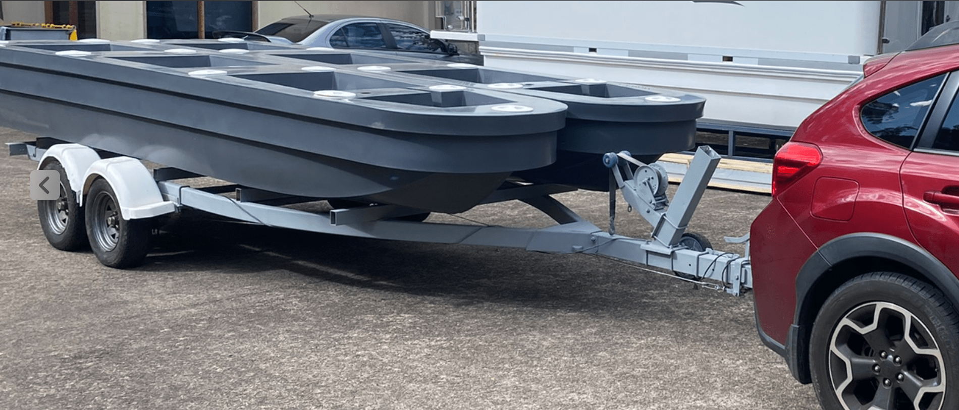

Not my boat, online image used to illustrate the hull type for the tender. My hulls are in storage. This will be a very wet boat. Not only spray but dripping human traffic. This vessel will also need an efficient music system. Again, the largest load will be the subs. Also in physical terms too. The vessel doesn't have a great deal of displacement for large subs or battery banks. It will already be loaded with the 72v hybrid electric/petrol/solar drive system. I need to build in the audio performance of the JBL BB3

Pic, picking up the hulls after getting them filled with survey grade foam. I bought an old trailer for its main frame and converted that to hold the pair of hulls, and I also converted it to dual axle. Maybe I can just build this to 2m and have the tender pulled up the side like a floating porch?. Lots to work out, big project
