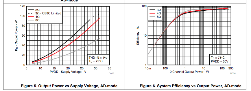

I might stick with the TPA3221 for now and see how much the case draws. Would I need a clamp type meter for this?
Some multimeters can measure up to 10 amps, others ~300ma (.3amp). The TPA3221 probably draws under a watt (1000ma) at idle.
Since you are going to have loads (boat motors etc.) that draw far more than 10 amp, probably invest in a clamp meter that can read up to 600 amps.
Would a 50Hz sine wave overlaid with 1khz be the right way to send the test signal through the line in and have the system do work splitting that up to the channels. Can this load up the amps/system to a steady draw at 96dB and max volume?
Pink noise would be more similar to the dynamics of music than sine waves.
Without a speaker load the amplifier won't draw much current.
The speaker's sensitivity will determine how much power used to make 96dB at one meter.
An 86dB 1w/1m speaker will draw 10 watts to make 96dB, about all the TPA3221 can do at 12v with an 8 ohm load.

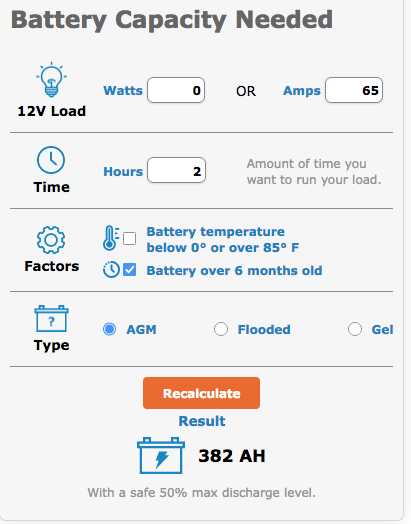

Determining the draw at comfortable ambient and max levels will help to work out the LiFePO4 bank. I think I can fit 4x 100AH in series, but this only gives me 100AH @48V total. Would need 4 more packs to double that capacity, and that would be impractical (pardon any incorrect use of jargon)
Struggling with determining if 100AH at 48v would be sufficient to run a quiet ambient volume at night without the EVRE kicking (EV range extender)Can easily carry 600w of that eBay panel linked earlier. I wonder how much can they help unload the battery during day use? Let's assume a pair of those Polks and two of these boards linked below for the subs and mains for marine use. I can make a waterproof housing for the amps
That is the amp for the portable audio bench cab
The marine booth use would be two of those 86dB subs on the linked dual-core board and the 48v 100AH bank. Struggling with the draw for that 96dB max ambient. Does 10w sound about right?
100AH at 48v is 4800 watt hours, you could run 480 watts average for 10 hours with no sun.
480 watts average could peak at over 3000 watts. Your neighbor complains at a few watts..
Two subs gains +3dB 1w/1m, so 89dB +10dB=99dB, under 10watt peak, ~1.25 watts average unless you are playing sine waves.

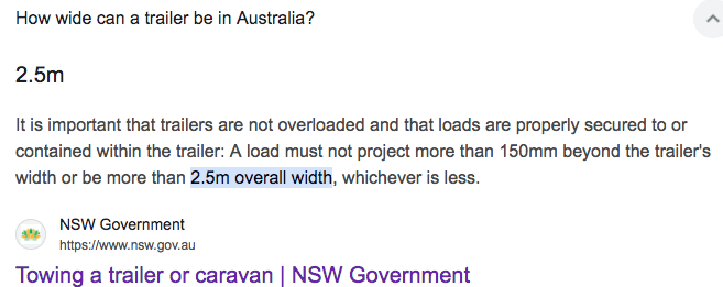

The overall width will be a road legal max 2m. The length of the deck will be set after some flotation tests but expected to be at least 2.4m long.
The beachcat looks fun, but not much displacement, and with almost no rocker, the hulls dig into relatively small waves.
Still have memories of flying through the air on a wire after a friend pitchpoled my 16" Prindle cat.
Everything I've read (and saw while in Australia) says 2.5 metres is a legal trailer width not requiring any other special considerations.

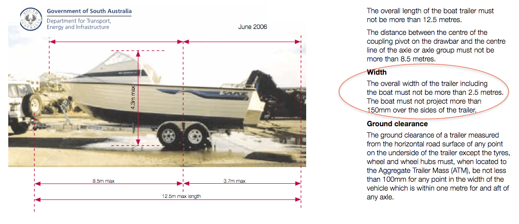

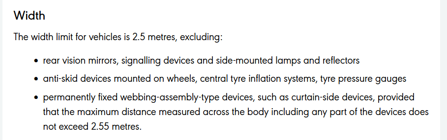

Bugger, I went to the transport office to register the big trailer a while back and was told that it was at limit at it's 2m and the hulls couldn't be built any wider. I have been working with the spec from a bush turkey for the past two years. I didn't even bother to check up since the info had come from the source
Cool, 2.5m makes it easier to work with

Am I working this out correctly? 50A max draw and 12v supply, so 600w?
Yes, though the Peukert effect will limit the amperage available from a 120AH AGM, and discharging below 50% will age your battery considerably, limiting it's potential storage capacity, further reducing the amperage available.
https://www.batterystuff.com/kb/tools/calculator-for-load-specific-run-time.html
