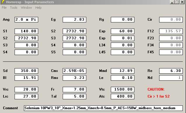

Hi epa,

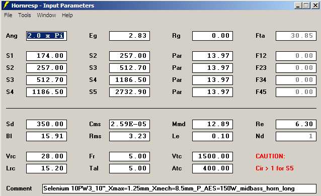

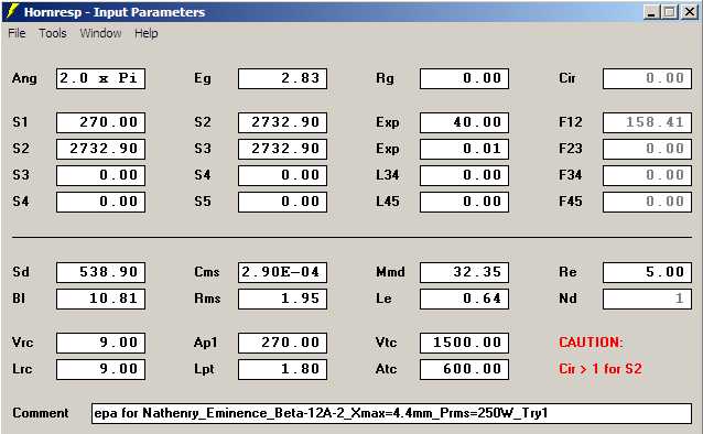

My only attempts at building front loaded horns with regular cone drivers have been with a throat area between 0.5xSd to 0.7xSd. Nothing close to 5.4:1.
I'll attach a Hornresp input screen that shows what I came up with for the Beta-12A-2 around your idea. I just don't have any experience in trying to increase the throat compression ratio beyond 0.5xSd.
Obviously, drivers do get loaded a lot harder in tapped horns and front loaded bass horns, so your idea may very well work. It sure would be nice if one of the guys that have actually build this kind of horn would chime in here with their practical experience.
One of the reasons this interests me is that I have a few Selenium 10PW3-SLF on the shelf that I wanted to use in a similar application.

i have no douth the driver wil take the high cr,if its crossed @ 150 hz(it is cut off before the horn unloads and excursion go's up)
however the high cr might choke the driver a bit.
in your last sim the horn rols of quite steep upwards,nut sure if the selenium connects.

Hi epa,
Post #166: "...nut sure if the selenium connects."

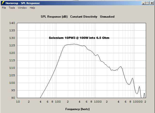

Don't get what you're trying to say. With the Selenium 10P3 I was just looking for a "filler" between a woofer and a 2" horn, but it has nothing to do with this thread. I'll attach a simulation of the selenium in a horn with the 22"x22" front just for fun, it would be fine from 200Hz to 2kHz, I guess.

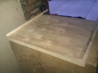

Hi Nathenry,
Very often PA subwoofers will not have any damping material applied. You don't want to stuff a bass reflex box completely, that might interfer with the internal action of the box. Always keep the damping material away from the port entries.
Hi Nathenry,

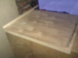

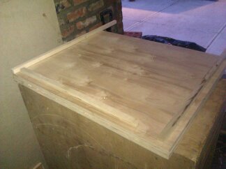

Post #175, picture 1 (1339806373497.jpg) looks OK to me, but the pictures are all so small, that I cannot really tell the difference. The braces (or cleats) belong into the corners between two boards.

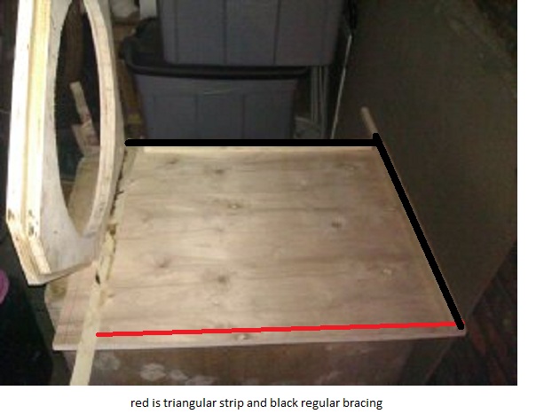

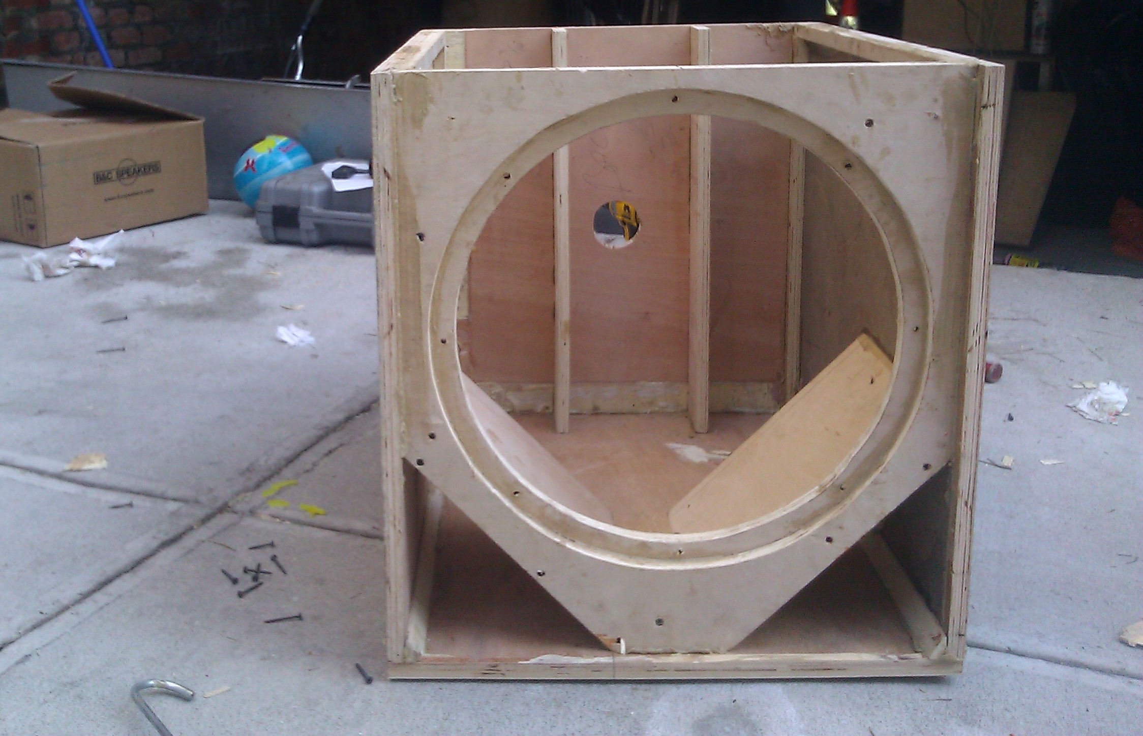

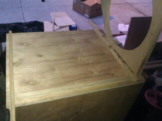

Hi Nathenry,

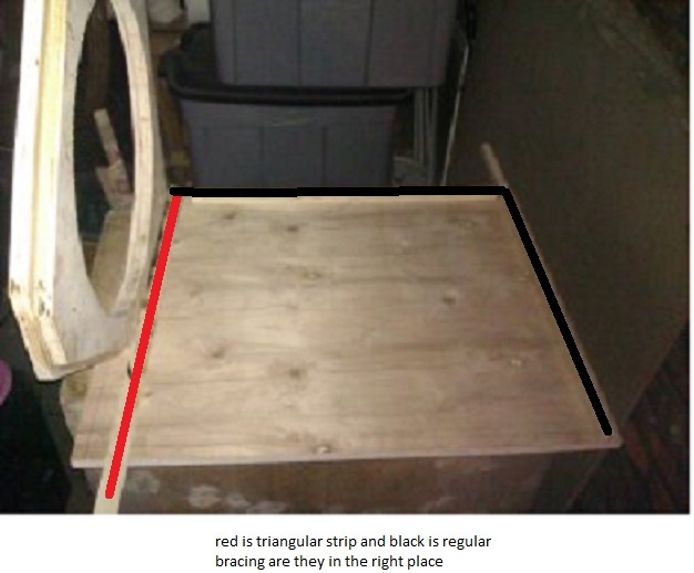

Post #177:
Top picture: the red line is wrong, as it goes across the port, reducing the port opening. (It wouldn't reduce it enough to matter, but anyway.) The black lines look OK.
Bottom picture; that looks like the correct place for both types of bracing, the red one should go all the way to the left edge of the side board. The black line should be inside the rear and top panels.
The main purpose for this type of cleat (or batten) is to help in sealing the box (especially in the long run), they also provide some additional stiffness. You want to make sure that y'all remember the side-to-side and top-to-bottom and back bracing.
Post #177:
