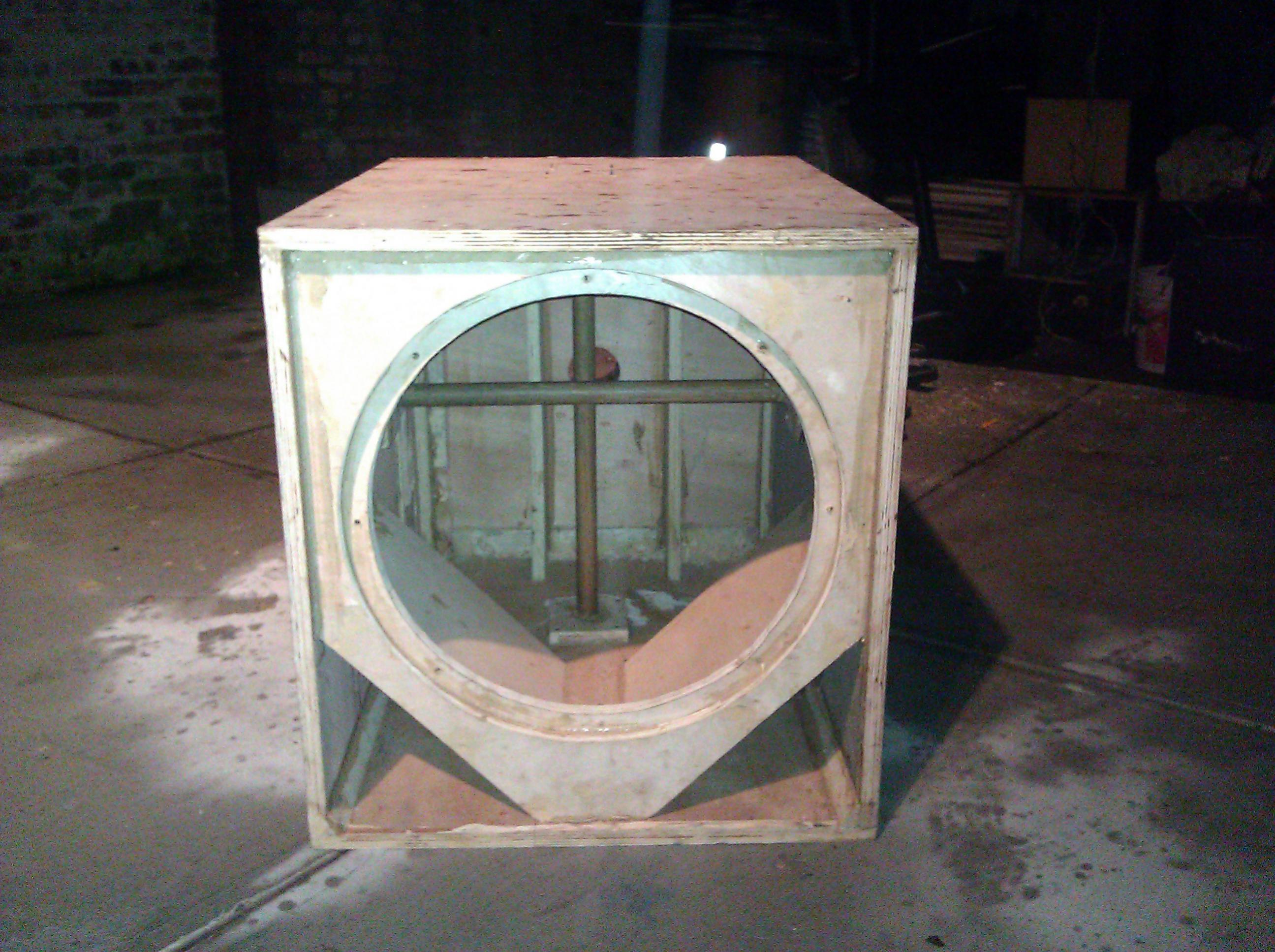

Nice. I hope you are happy with them. Are you going to use stuffing?
Yes, they will be stuff.
Start with a nominal amount and if it sounds a little boomy add some more until you are happy. Rockwool insulation works well.
