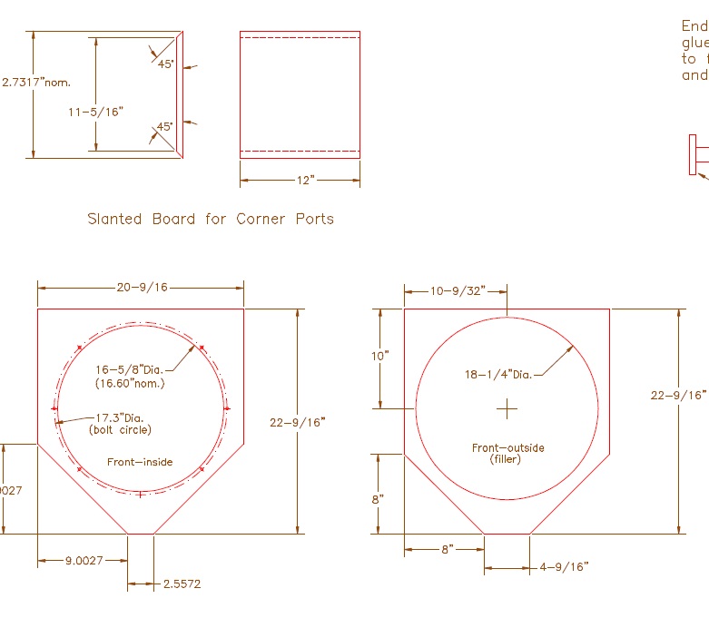

i updated the pic to make things more clear.
1,bild the square box with the speaker baffle in it.(left,right,top bottem and speaker baffle)
2.put the top and bottem brace in
3 put top and bottem of the horn pannels in
4 put the left/right side brace in
5 put the left/right horn pannel 1a/b in
6 put the left/right horn pannel 2a/b in
to be continued...
to be continued...
ok here it is,im sure not all is clear in the beginnig,but feel free to ask.
outside boards are 3/4"(18mm)
all inside boards are 1/2"(12mm)

Sorry to say this but we are having a hard understanding your layout.

Epa can you add some measurements to the above animation layout that would make it 100% for me to understand and answer any question if ask. This is great.
drwaing updated
top/bottem 22x20.5/8 3/4(18mm)
left/right 22x24 3/4(18mm)
back 22.5/8x20.5/8 minus 1/16 (removeable back pannel) 3/4(18mm)
speaker baffle 22.5/8x20.5/8 see drawing for cut out 1/2(12mm)
for the horn pices you best use the drawing.
the rear chamber is to large as it is now.
whe have to come up with a solution for that.
before you put the cross in,whe need to measure the eminence precise to make some final adjustments.
also whe need to cut from the front cross to fir the horn/driver.

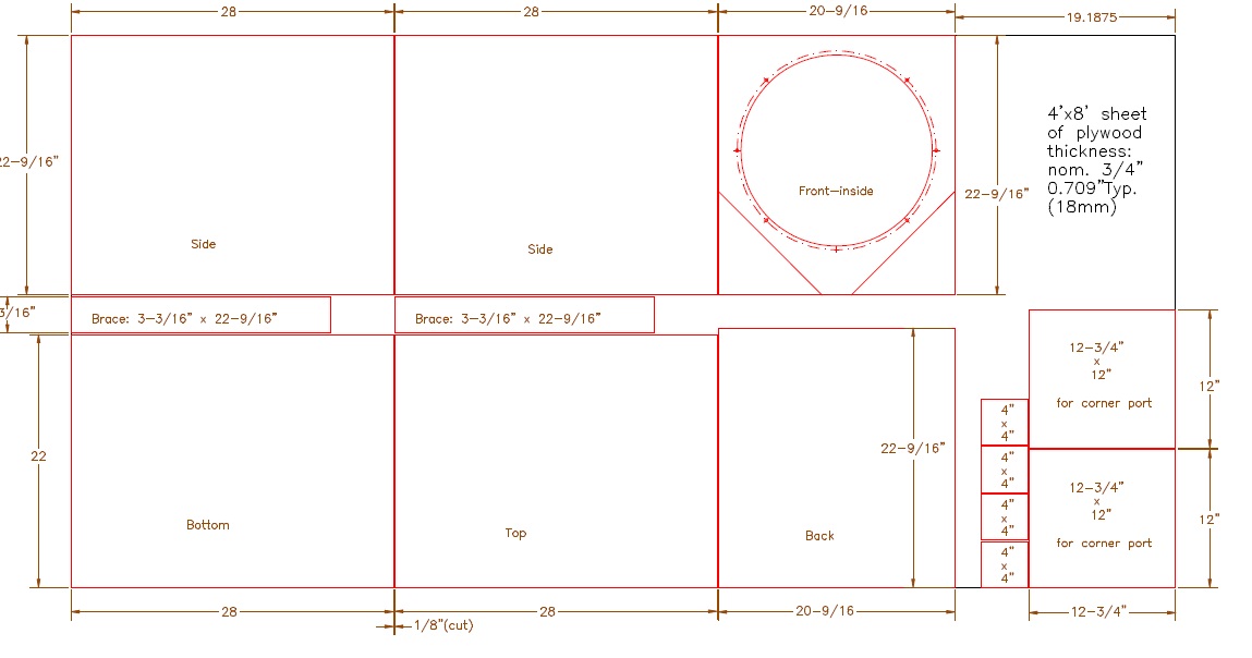

Can one sheet of 18mm ply and one sheet 12mm plywood build 2 top.
Don't forget the cutlist layout that makes it easier for the carpenter to cut the plywood without wasting it.

as whe can see from the cut sheet,we are shy the back pannel (3/4) and the speaker baffle(1/2) to make 2 boxes .

Thanks for the cut sheet, I am going to try and add the measurements to your cut sheet and pass it on to the carpenter, hope I get the measurements right.
My order from PE will arrive tomorrow. I understand 90% of epa layout, still trying to figure out how to add the measurements to the cut sheet

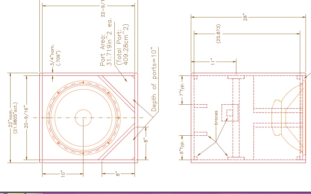

The top and bottom brace center cross 21 5/8 x 151/2 where on it must be cut at 65 degree angle.
What should the size of the speaker chamber be if it is too big as we speak.

15.1/2 is correct but you need to add 2 sawcuts thickness to the 21.5/8(best to cut it 1/2 bigger)
this also go's for the left /right brace/center ,15.1/2 is ok but add 1/2 to the 19.5/8 for the cuts.
chamber must be between 7to 20 ltrs (10 is best)
you could use hard foam blocks to fil up the space ,or make a square chamber,in the chamber.
13x13 wil be ok
edit/using degrees is not so acurate.
when you have cut the board 15.1/2 top/bottem/center,draw the line 7.1/4 to the corner.
