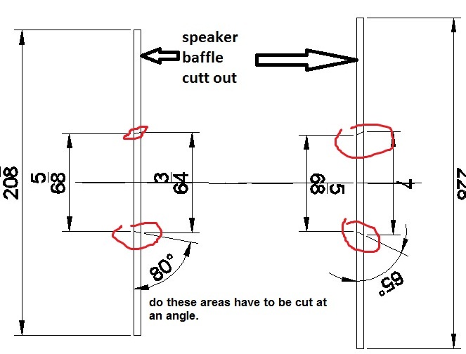

as edited above.65 degrees could be 64.5 0r 65.5 degrees better us the measurements.they are more acurate.
as whe can see from the cut sheet,we are shy the back pannel (3/4) and the speaker baffle(1/2) to make 2 boxes .
Something like this with measuements will help a lot when the carpenter is cutting up the plywood.

this aplys to the top bottem left right braces and center cross.

Should the horizontal dimension below the top left rectangle be 21 5/8 instead of 22 5/8ths? The dimension seems out of place with the others in the image.
This top seems like it will need a tweeter/compression-driver for the higher frequencies (above 5k?). Is this correct? If so, where does it mount?
Is there a specific reason, other than for durability, you used 3/4 inch plywood for the external box? I'm guessing with the driver installed this top will weigh around 70 pounds. (the bracing seems to be very well thought out, and that seems to provide strength, but it does add weight.)
Using 1/2 inch plywood for the outer box instead of 3/4 inch plywood might drop that weight by 10 pounds. Perhaps that additional thickness is only needed for the speaker compression chamber?

to make it clear when the cuts are done ,the size is 21.5/8
its just a bit bigger to allow for the saw cuts wich are usual 3 to 4 mm.
so you cut a board off 22.5/8 *15.1/2 ,draw as shown,then cut,then draw again,then cut, then draw again and cut.

to your first question,yes you could make it al 12mm,but were talking 8kg difference.
and the rear chamber needs to be 18mm anyway.

could you give me the exact measurements as shown in the pic ,where the arrows are.
Give me a hour and a half to get home
