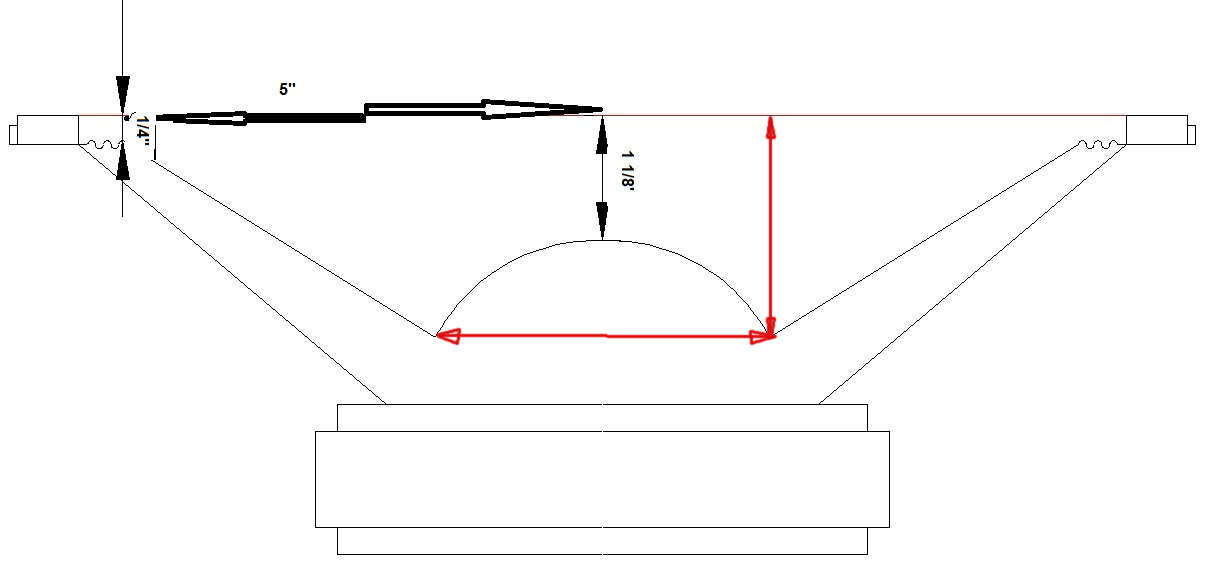

Thanks for the added dimensions. As to the angles, in epa's design you should be able to cut all the angles as complementary to 90 degrees, e.g.: 65/25 or 80/10.
Hi Nathenry,

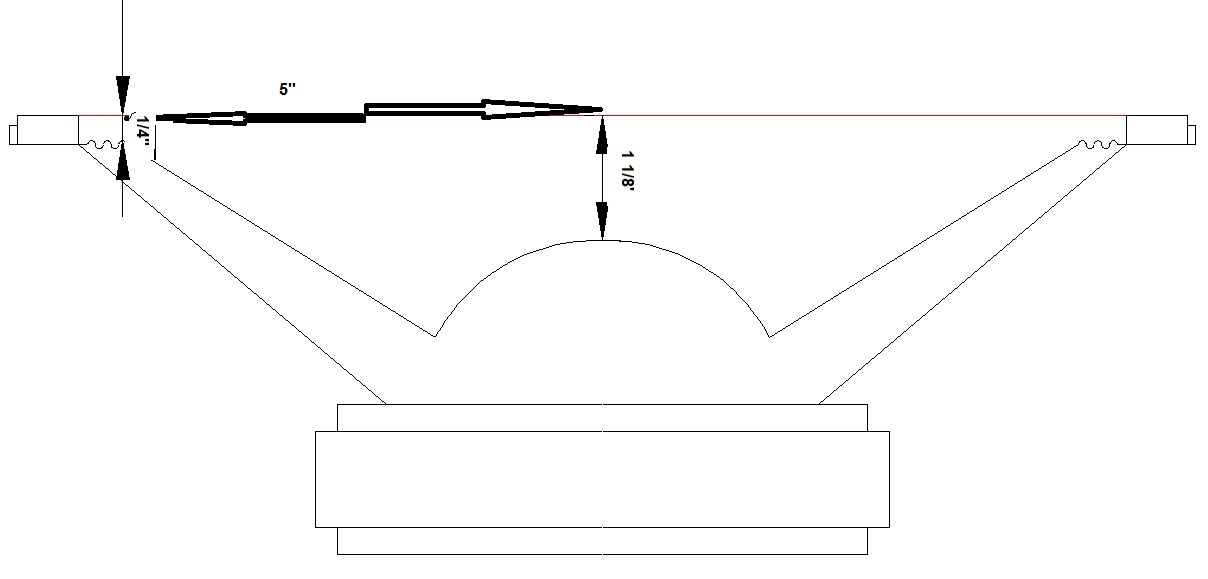

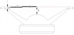

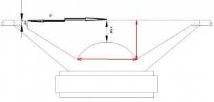

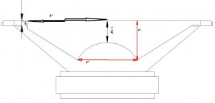

Are you sure, that 1-1/8" dimension is from the mounting gasket to the dust cap?
Found a reference for angle cutting: http://www.diyaudio.com/forums/full-range/180217-sachiko-project-66-deg-angle.html
Hi Nathenry,
Oliver I did the measurement back over and I get 1-1/4
Sorry
Hi Nathenry,
I think, that epa wants to incorporate something like a phase plug into his design, for that he will need to have these dimensions relatively accurate.
