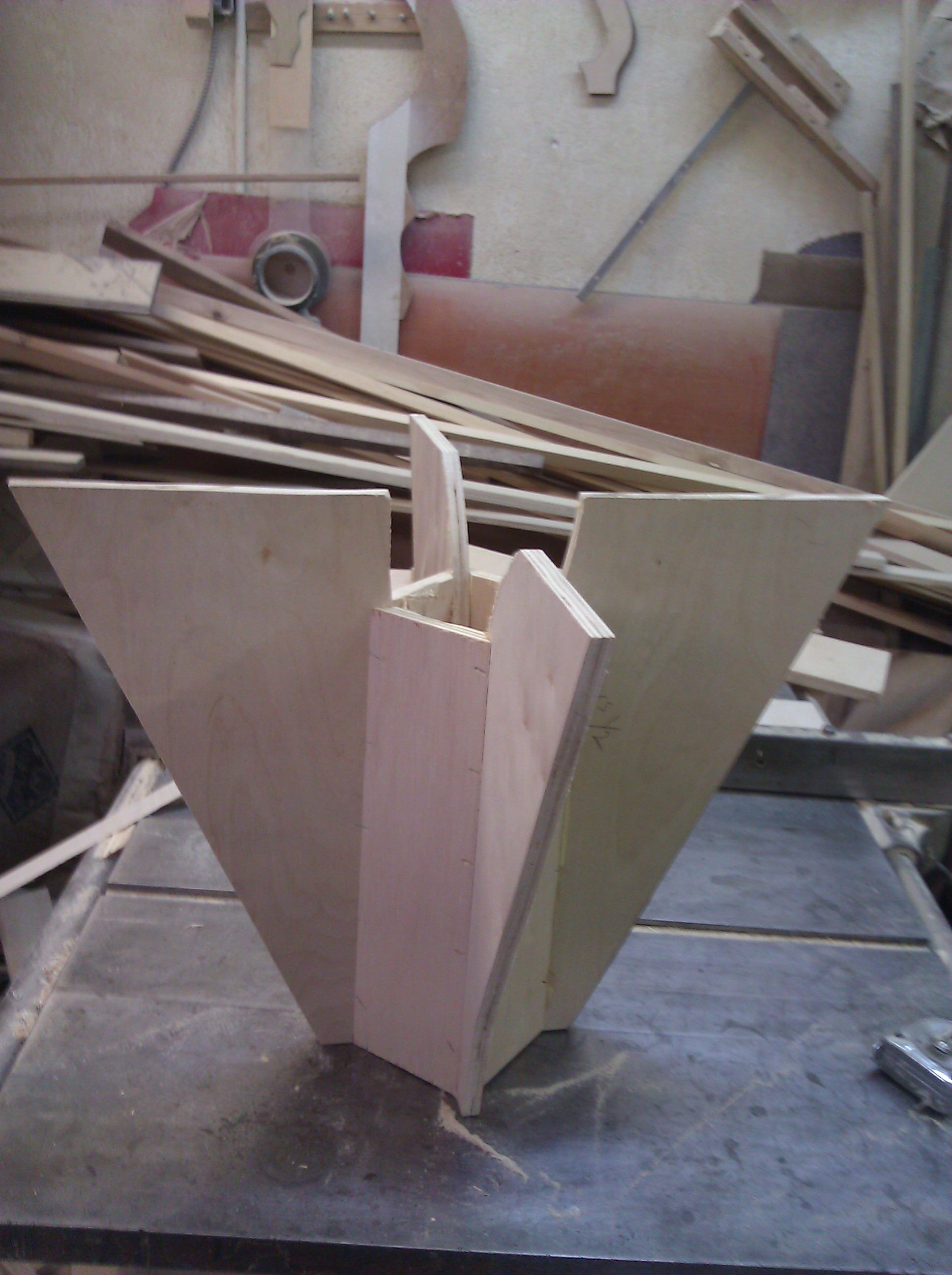

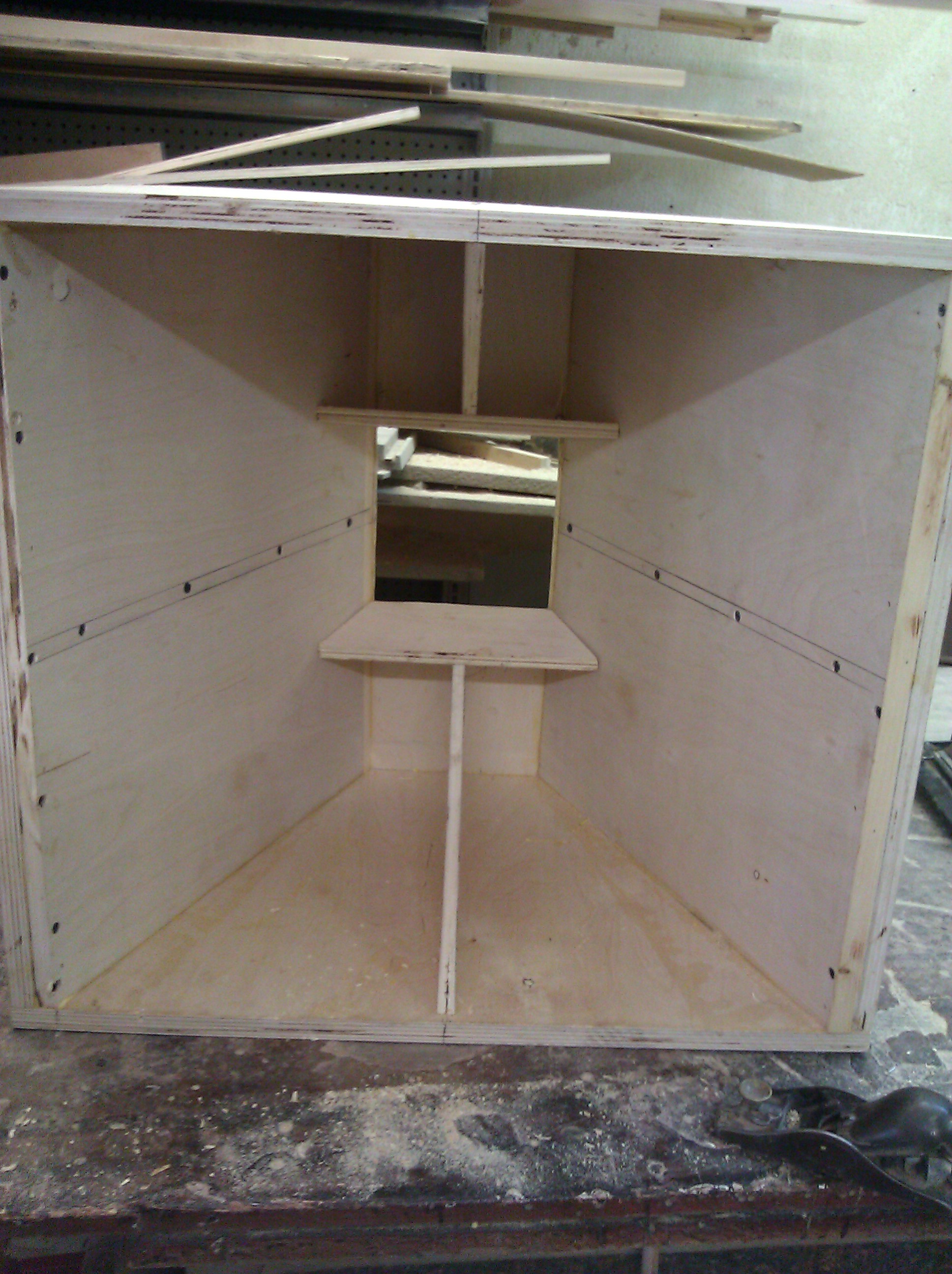

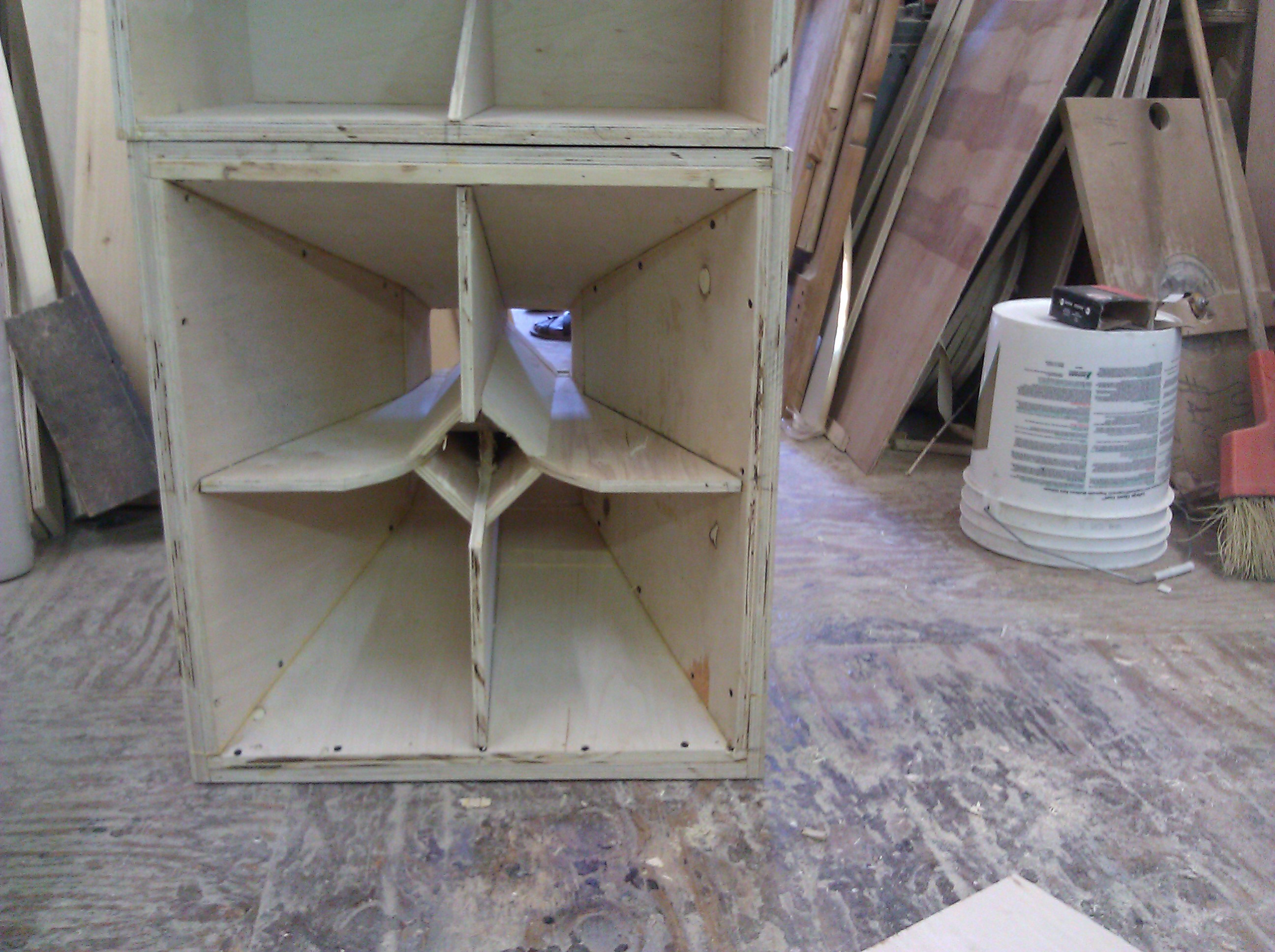

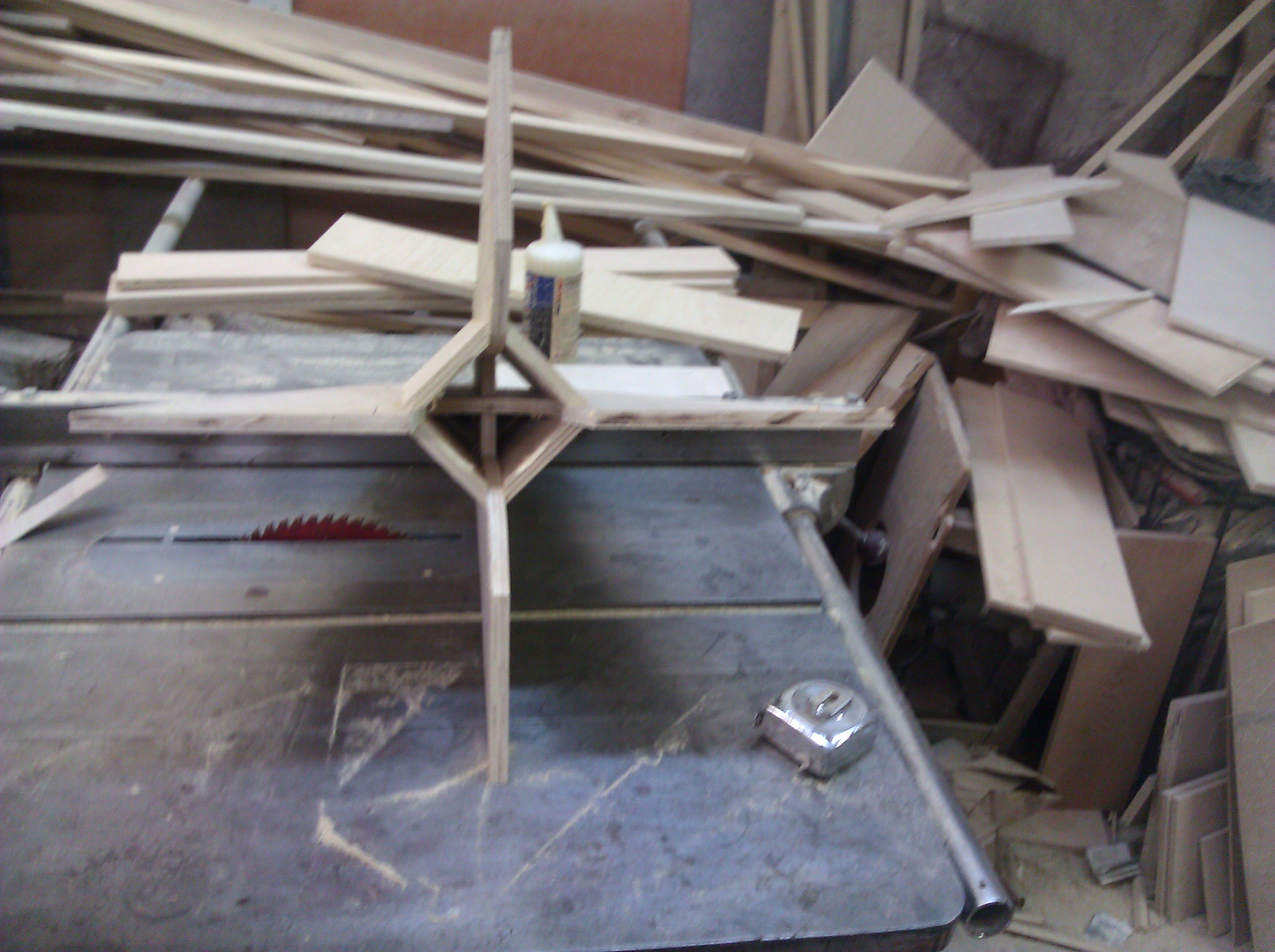

the white arrows show the position of the hf horn.
the yellow arrows point to the phase plug (center extension)
have you seen the print out post 303?
Yes i saw post 303 and print it out. what i meant to ask is if the phaseplug should be touching the beta12a speaker.

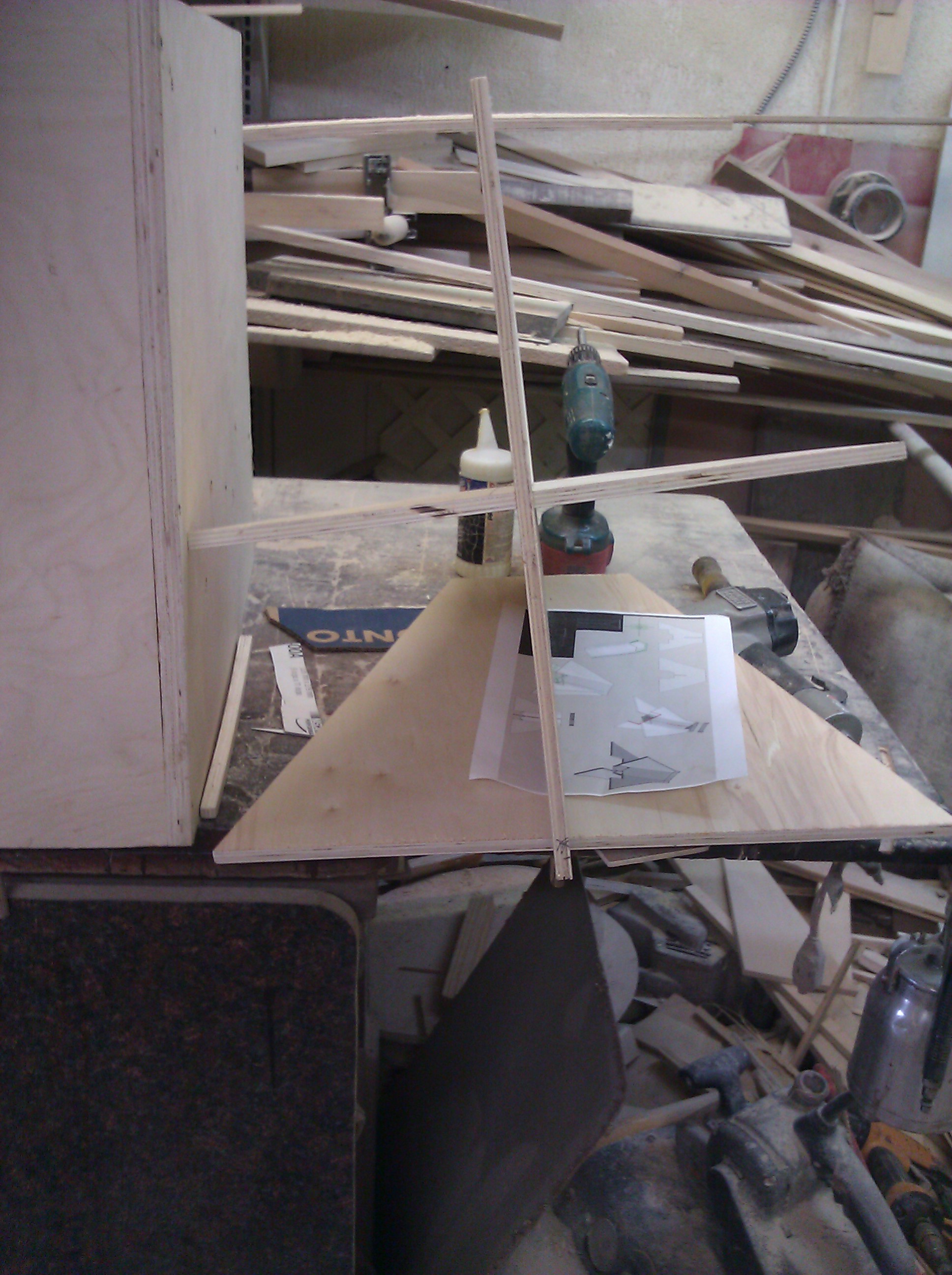

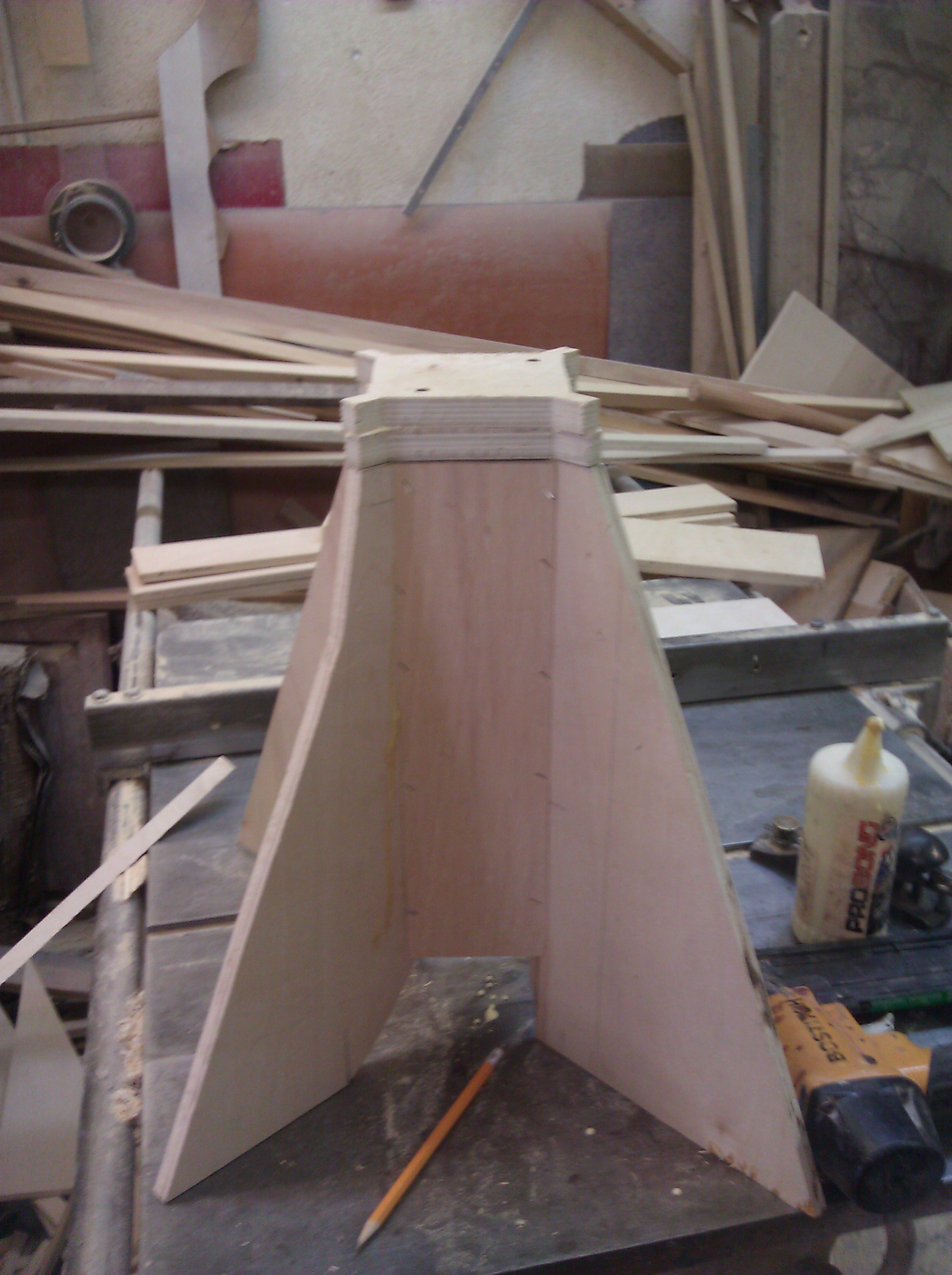

center pole piece eg "phaseplug" whe make of 2 pieces of 18mm(3/4)ply glueéd on top of each other and then to the center cross.
here is a printout scale 1:1 so you can put that on top of the wood and cut it with a jigsaw.
Epa Can I Get the phase plug in pdf or just draw the measurements on the phaseplug

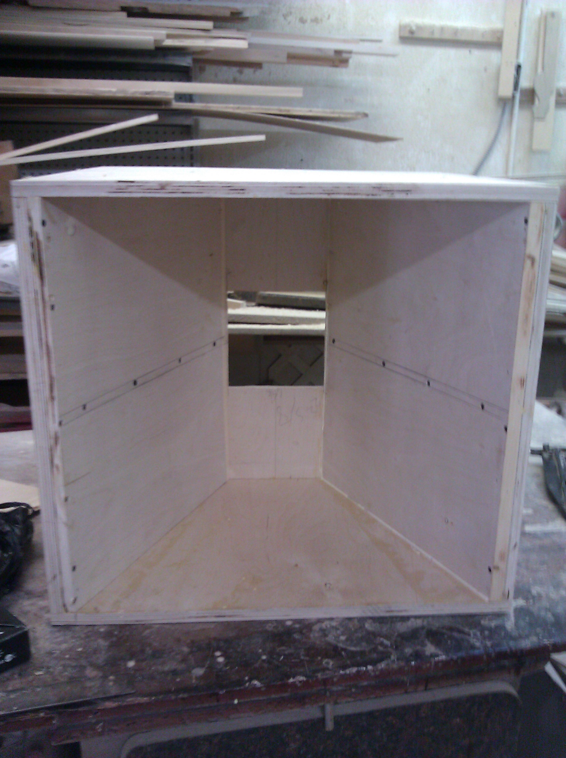

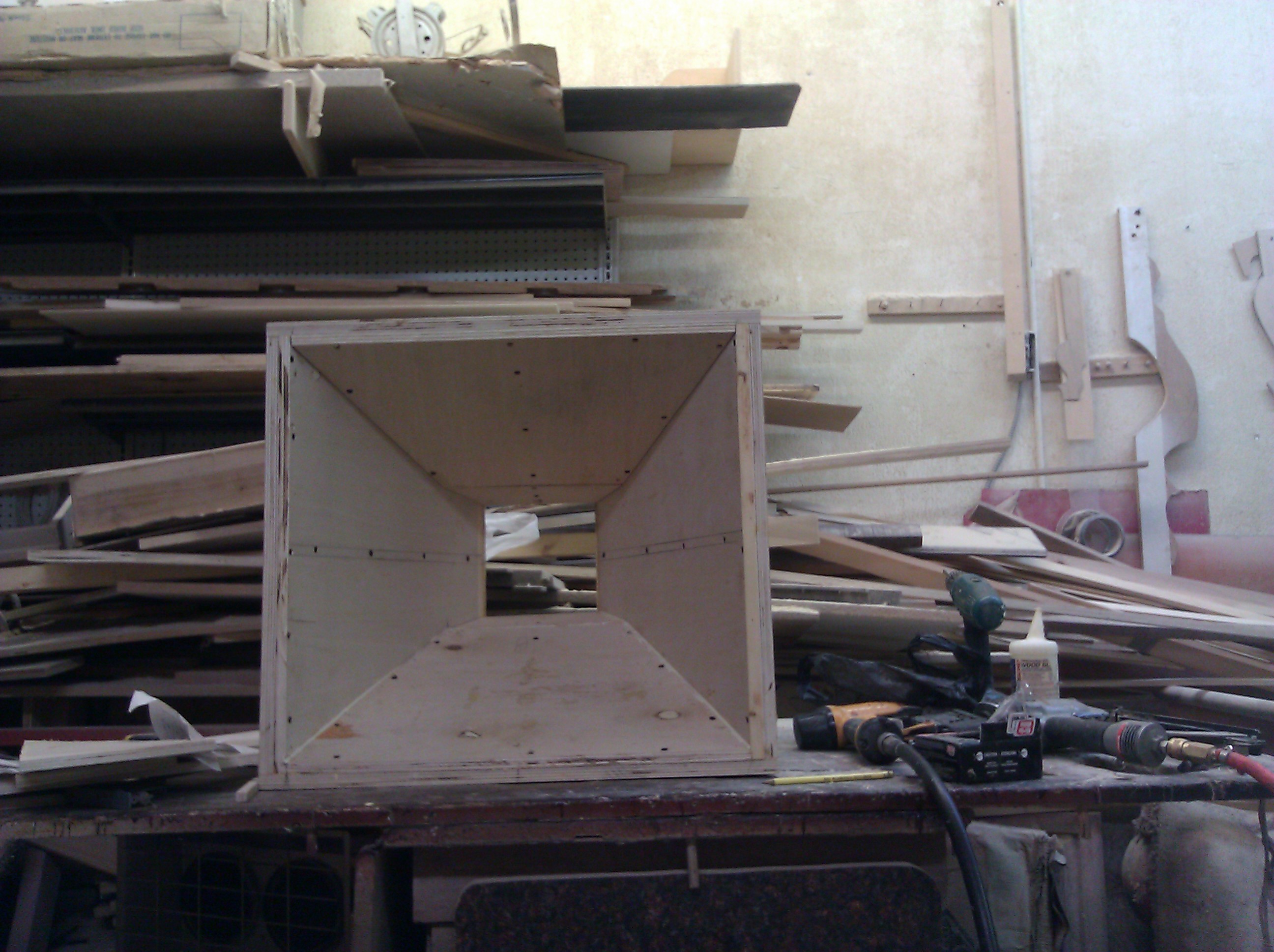

making progress.😀

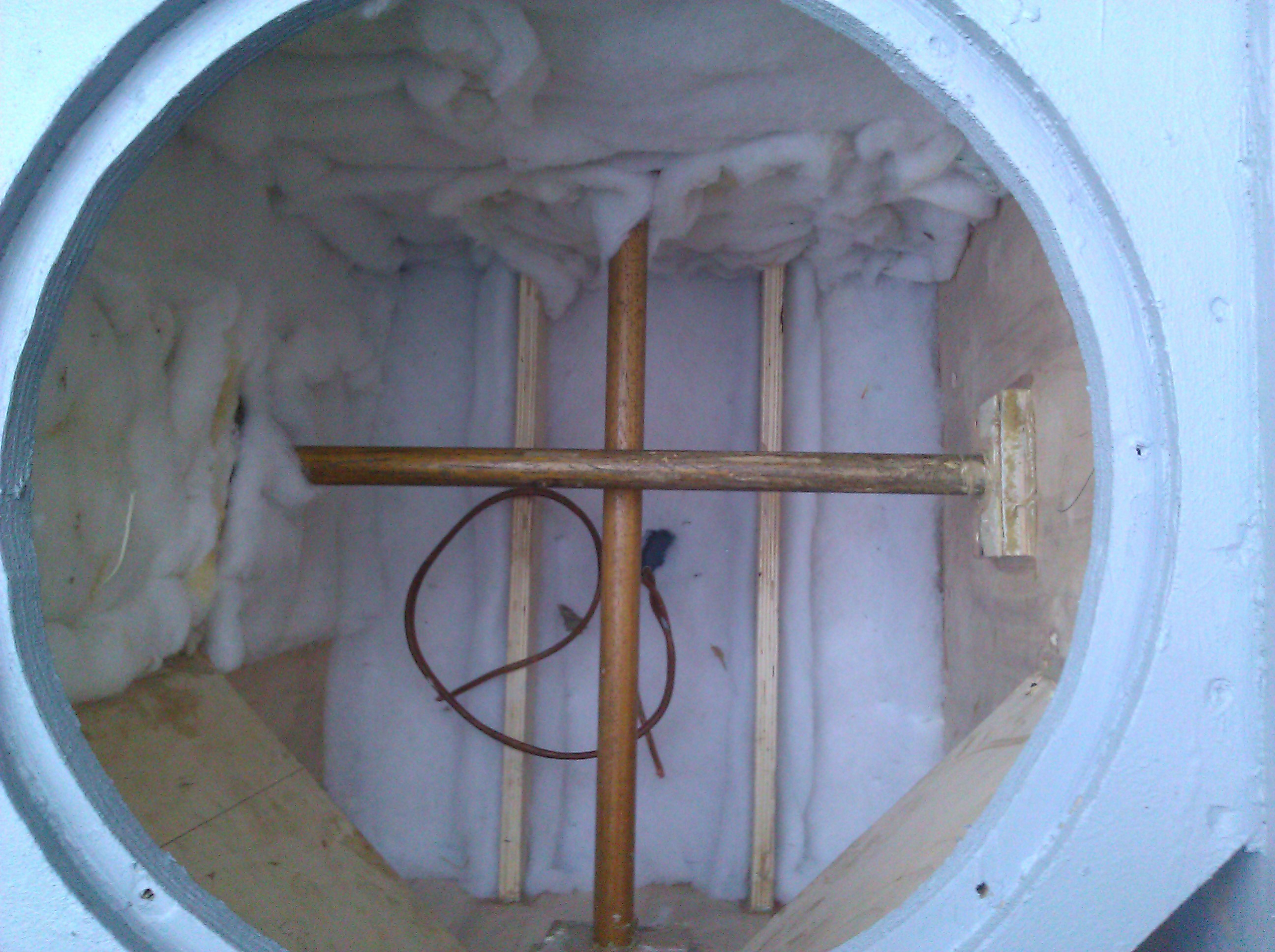

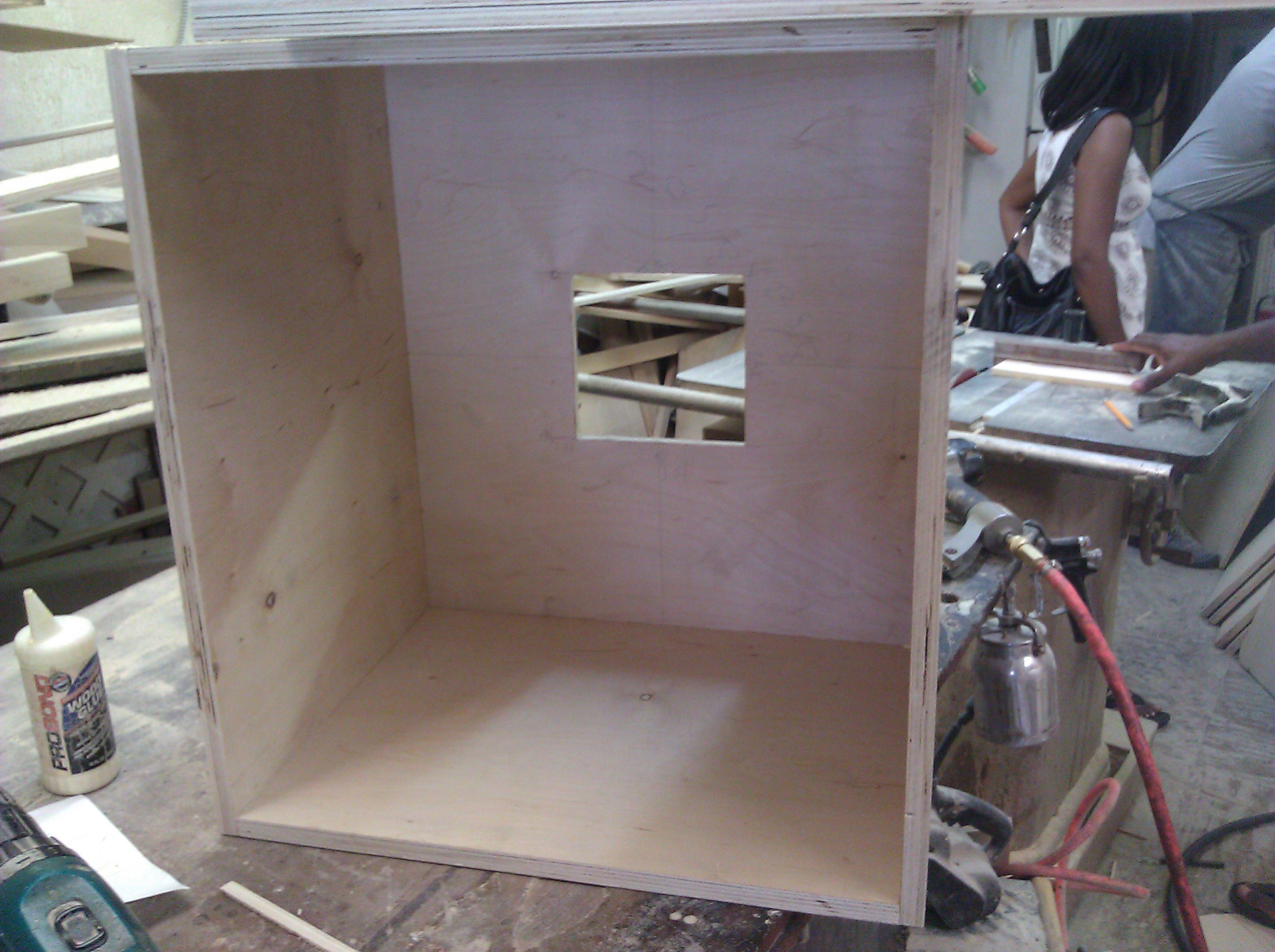

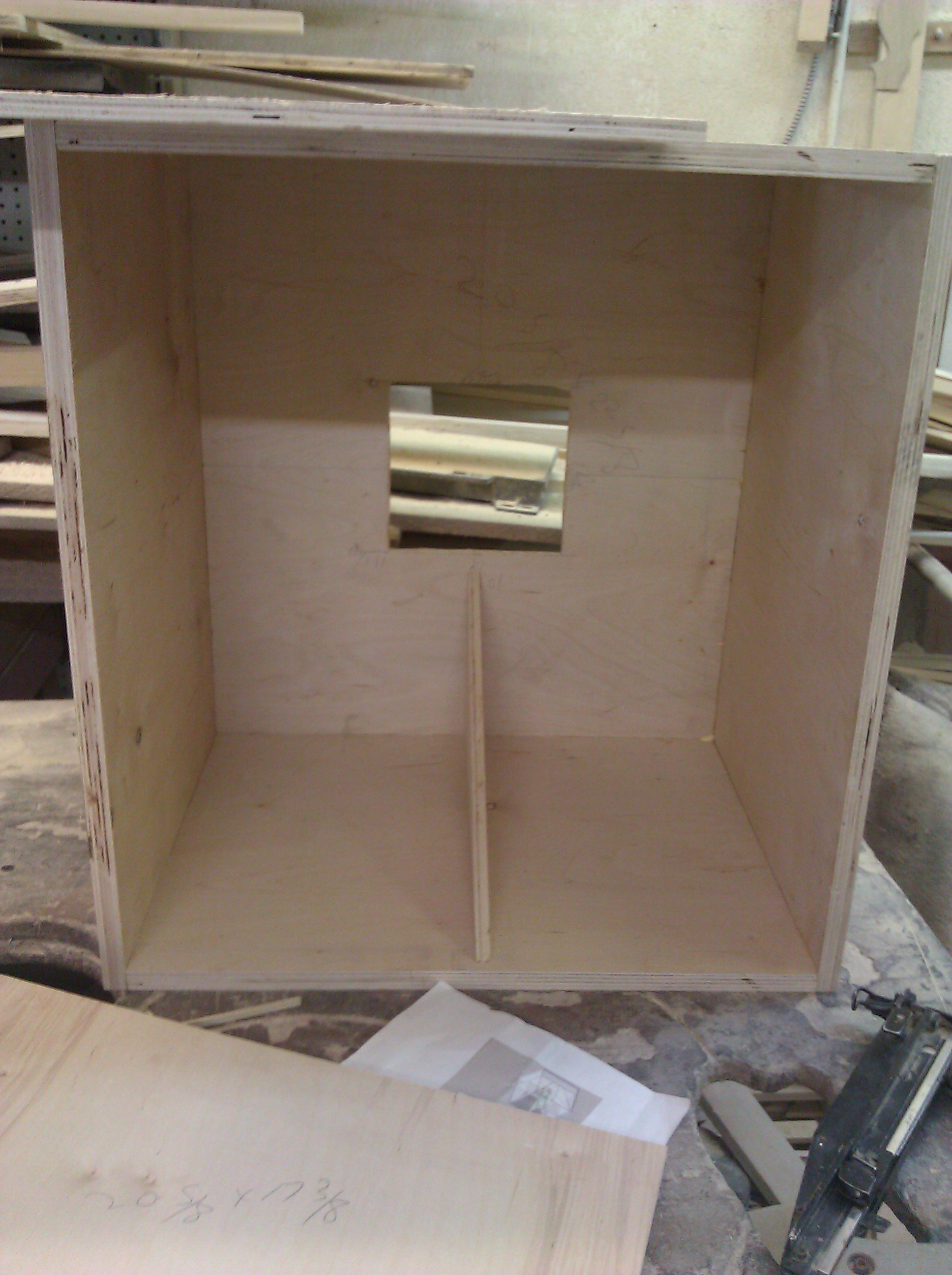

if you would make it 13*13 inch,and the same depth,it wil be between 10 and 15 ltr wich is perfect.
some lining against the walls of the rear chamber.

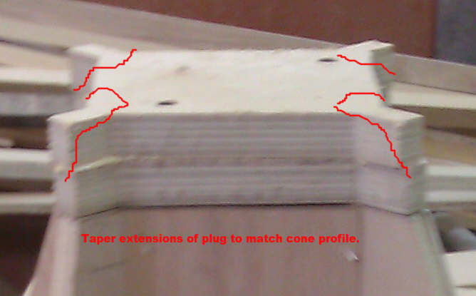

1 thing ,make sure to double check the distance between the "phaseplug"and the speaker.
i see the cross is about 3/8 back from the front,this means it sticks out 3/8 cm more then it should on the back..
this is not a problem as long as you double check that the cone has the clearance needed.
1/4" is ok.

Hi Nathenry,
eap, Post #335: "...double check that the cone has the clearance needed."
You can alway twiddle away at the extensions of the cross on the plug. A minimum of 1/4" is important, that's only ~6mm.
In the rear chamber you can always take up volume by lining the chamber with styrofoam, e.g.: from old packing material, or Home Depot. You could start with a few layers of closed cell foam (styrofoam), and then add a layer of open cell foam and fiberfill.
