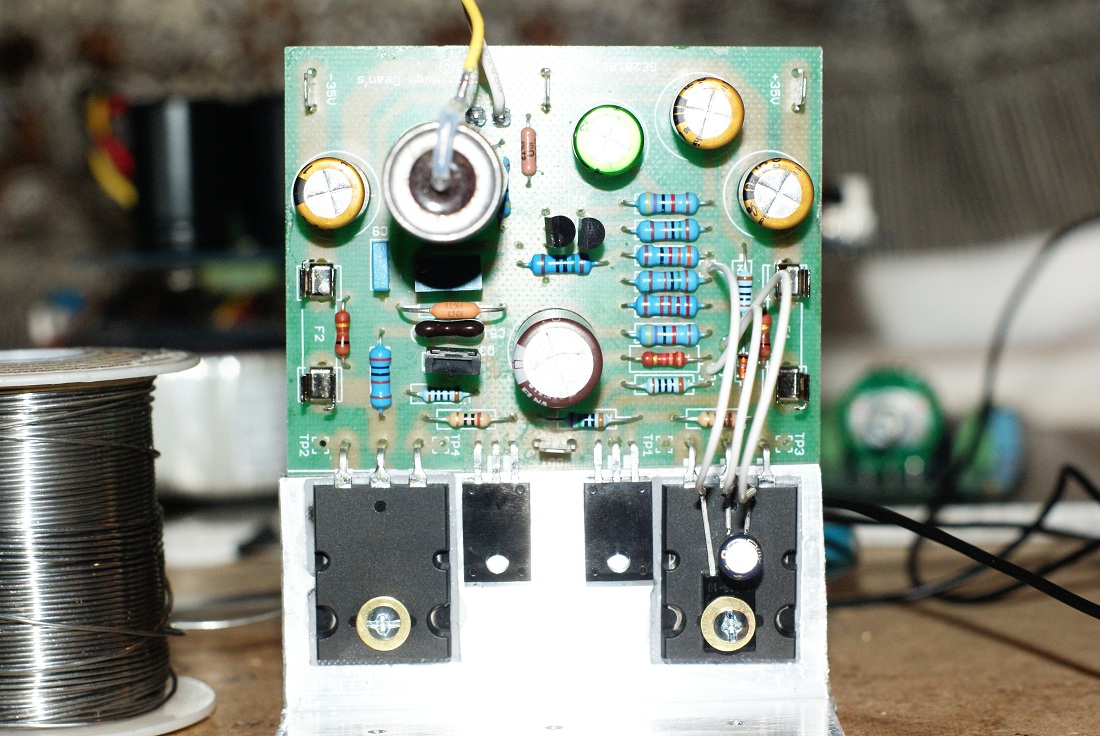

OK, I need some help with debugging the BAKSA.
I have been in contact with Greg over the past week and he suggested I post on here to get a few more heads in the mix. With the info I have given we have not come to a fix.
Greg has given a few voltages from his build to compare.
The following is what I sent to Greg
q1/q2 0.7=1.05v
r4/c5 0.578=-33.5v
TP3/4 1.252=35v (i have suckout cap here)
TP1/2 .059=34.5v
OUT? .019=34.5
BIAS Vce 2.47= 0
I checked all voltage referenced to ground.
Also, I did some B-E voltage readings and all transisitors are 0.4-0.6v with the exception of q1 7v and VAS 2v.
I did remove q1 and VAS and tested with my transistor tester and came up fine, there were no shorts. So, I see no need to replace maybe problem is with something else.

post the actual Vbe of each transistor and the corresponding schematic so we can identify which is where........Also, I did some B-E voltage readings and all transistors are 0.4-0.6v with the exception of q1 7v and VAS 2v.
Hi AndrewT and Wendell,
Here's is the latest schematic with typical voltages (in red) measured from the first BAKSA I built.
I have built 5 test amps using this PCB and BOM, (Rabbitz has built a couple, slightly modified) so we can assume that the PCB, schematic and BOM are OK. I have a feeling one or two of the transistors are swapped or reversed but can't tell from the picture.
It may be a solder joint but I understand Wendell has the same problem on both amps. Is the right Wendell?

Vbe
Q1 .633v
Q2 7.26v
Q3 2.61v
Q4 0
Q5 .448v
Q6 .448v
Q7 .503v
Q8 .504v
Hi Wendell,
Here's a guess. Here's the logic I used. Q1, Q5, Q6, Q7 and Q8 Vbe's are almost right, so I would assume they are OK. Q2 is probably OK because it is part of the LTP and Q1 is OK. Q3 VAS and Q4 Vbias values are bad, so one of these is causing the problem and they are both part of the middle section of the amp. Q4 looks OK in the picture assuming it is a BD139. So it must be Q3.
regards
If T2 has 7.26V across base/emitter, then it's damaged. Just why this happened is the question; excessive soldering heat maybe, incorrect alignment possibly.... Same is true for Q3; this is excessive and could also indicate damage.
Replace these devices, see what happens. LTP devices should be matched, however, so do T1 and T2 as a matched pair.
