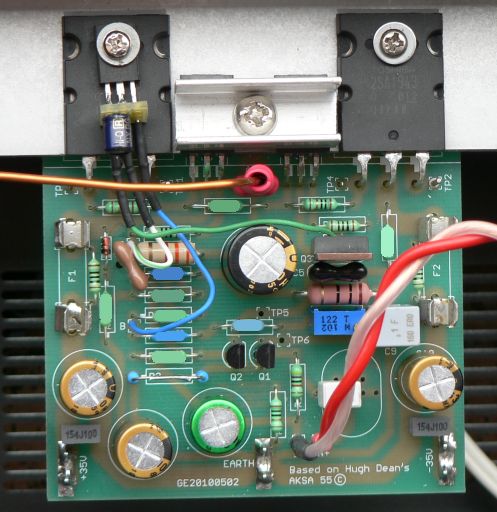

Q3 using the 2SC1819 is no problem but I want to check what you have done with Q5 (2SC4793) and Q6 (2SA1837) when reversing these. From your pic at post #3 it looks like the middle amp has them standing up not contacting the heatsink and the right amp looks like they are bent to the heatsink touching on the front face. From your experience in running these, do Q5 and Q6 need to be on the heatsink or just left in air space? If they need to go on the heatsink I can cut the tracks and run some links.
Good eye. Yes when I did the first one I reversed Q5/Q6 and left them standing. There were a little close to the output spade, so on the next one I bend them forward out of the way. They aren't screwed down so there is no real contact with the heatsink. They run a few degrees warmer than the output transistors. My current feeling is they really don't need a heatsink, the original AKSA 55 didn't and I didn't have a problem over 5 years. As an option you could put the output spade under the PCB.

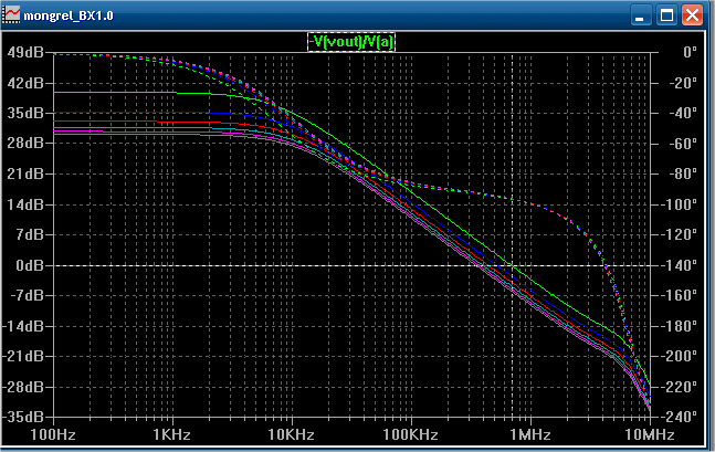

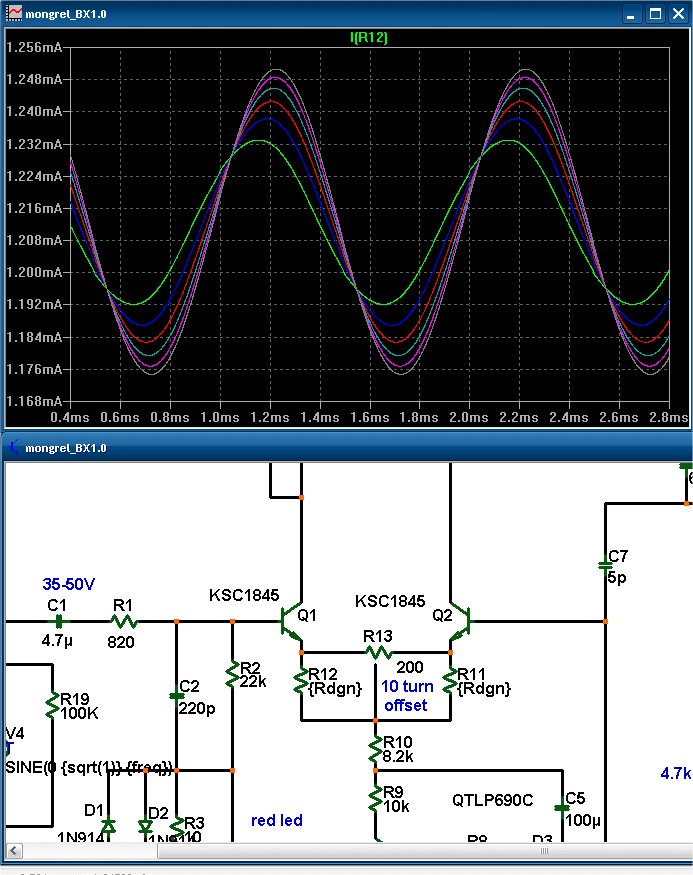

The degen resistors do not affect the LTP current , just the gain of the input pair (attachment 1). Plot shows 6 different degeneration R's {Rdgn), from 1R/20/40R etc. up to 100R.
Plot 2 shows how this affects the total loop gain of the amp with 42db at 1R and sub 30db @ 100R. What value you use is dependent on the beta of the input pair. My ksa/c's are best with 22r. MPSAxx or BCxxx are best with no resistors. Some zetex high gain pairs need 47R or more.

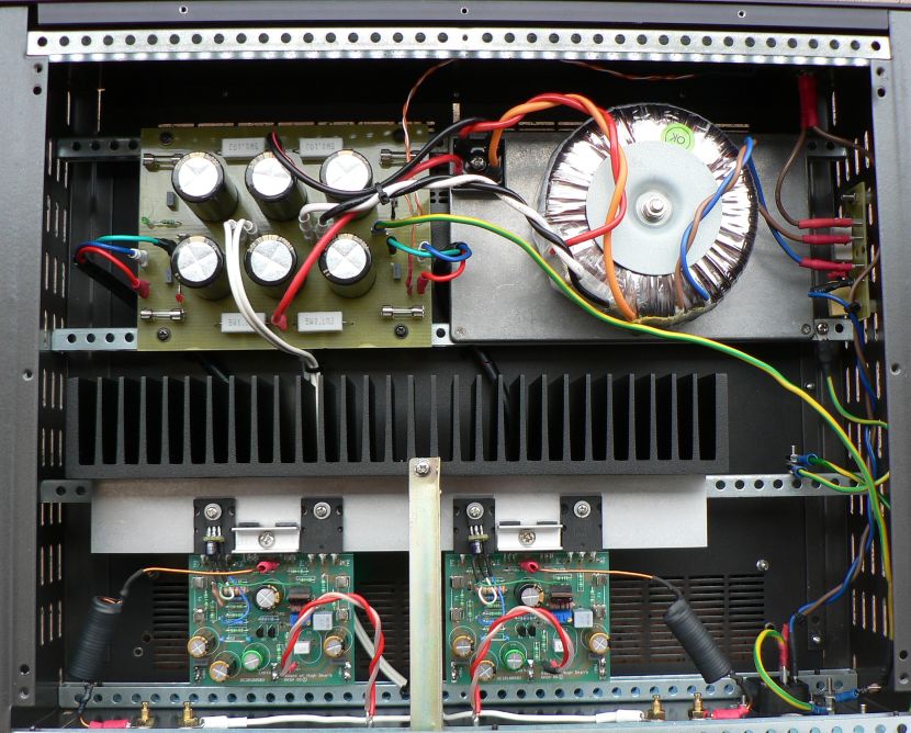

It's alive today!
More of a AKSA 55N than a Baby AKSA as I didn't use the BD139/BD140 devices for the drivers and VAS. Only different by a few component changes, a couple of my own preferred component changes and a few additional components (most have been discussed in the thread) and headed that way since I used the drivers and VAS that's in the AKSA 55.
I used a 1uF input cap as have noticed a difference previously on speakers with a low F3. All electrolytics are Nichicon.... ES (C2), FG (C3, C10, C12), KZ (C4), KG (power supply). Q3 is 2SC1819, Q5 is 2SC4793, Q6 is 2SA1837 and all are reversed in the PCB due to opposite pin out to BD139/BD140. Silver mica for the phase lead and lag compensation caps. R3 was increased to reduce a larger than preferred -ve DC offset so it became < 10mV. The zobel is on the PCB and the output inductor // 10R 2W resistor are off board.
For the 1.4uH inductor I used 1.4mm wire x 10mm ID x 23 turns.

There is a very gentle turn off thump and the amp runs luke warm. All voltages, bias etc came up trumps and more importantly, sounds like an AKSA right away. It has that special AKSA presentation, engagement and lively performance but retains smoothness. From experience, it will get better after 10-20 hours. It was run with a passive pre only and the performance surprised me as generally I have found AKSAs need a good active pre. The speakers used don't go that low (F3=60Hz) so probably helped the passive pre cause.
Thanks to Greg for the thread as well as supplying me his PCBs. I do have 2 of Greg's PCBs left over for anyone in Australia who wants them. Just send me a PM and I'll make it happen.

There is one concern I have for the design; offset is hard to trim, isn't it?
Even if the best values of R3 and R4 are picked, offset can vary. The BD139 is shown having near 100 Hfe, but a typical value is not specified implying that in practice it varies wildly. Current through the VAS is what, 8mA? So with a gain of 100 we'd have 80uA. 620mV across 2k makes 310uA, so in fact between an Hfe of 40 and 250, Q1 current can vary between 342uA and 510uA at DC (and this neglects Vbe differences), which becomes 0uA and 700uA if we assume a worst-case VAS output of +-8mA.
At DC this constitutes a 50% change in LTP balance, ouch. But we can change R3 to correct this, right? Anyways changing R4 will change VAS gain, using R3 is the most benign option it seems.
But wait, by the time we've corrected the imbalance, total LTP current is nearly twice it's original figure (remember the 50% balance change), and so the LTP's Gm is now halved, again we changed the circuit's characteristics.
Of course, in hindsight, correcting offset using R4 is better now because the decreased gain of the VAS will cancel with the increased gain of the LTP.
But still this isn't best because we still change the AC characteristics, by taking gain from the VAS and giving it to the LTP (and thus trade LTP distortion for VAS distortion).
This is a doomsday prediction of course. BD139's from the same batch might be reasonably matched, and if that is the case my preference would be to adjust offset using R4. Also consider the discussion on the effect of a balanced LTP on soundstage.

With over 8 hours on the amp it's a tad smoother but all else is the same. I don't think it will change much more.
The heatsink on the drivers seems to be cooler than the main heatsink (by touch) and that's only a little above room temperature. I'm sprung.... you caught me placing most items on the top of the PCB. I do it so I can spot any components getting hot or frying as well as I tend to bend components or leads under the PCB when handling during the build. There are only 4 components under the PCB.
I played with R3 again to reduce the offset to < 5mV. Even at it's worse was < 30mV at startup. The bias is rock solid with no drift. Each check was within 2mV of the set value.

Obviously, in this form the amp is highly non-linear, but it's an essential parameter if we want to know the details of the feedback loop. You achieve this by putting an infinitely large cap (10,000uF in practice is normally enough) from the feedback node straight to ground, then put in a small, say 1mVp signal, and then measure the peak output of the amp loaded.
