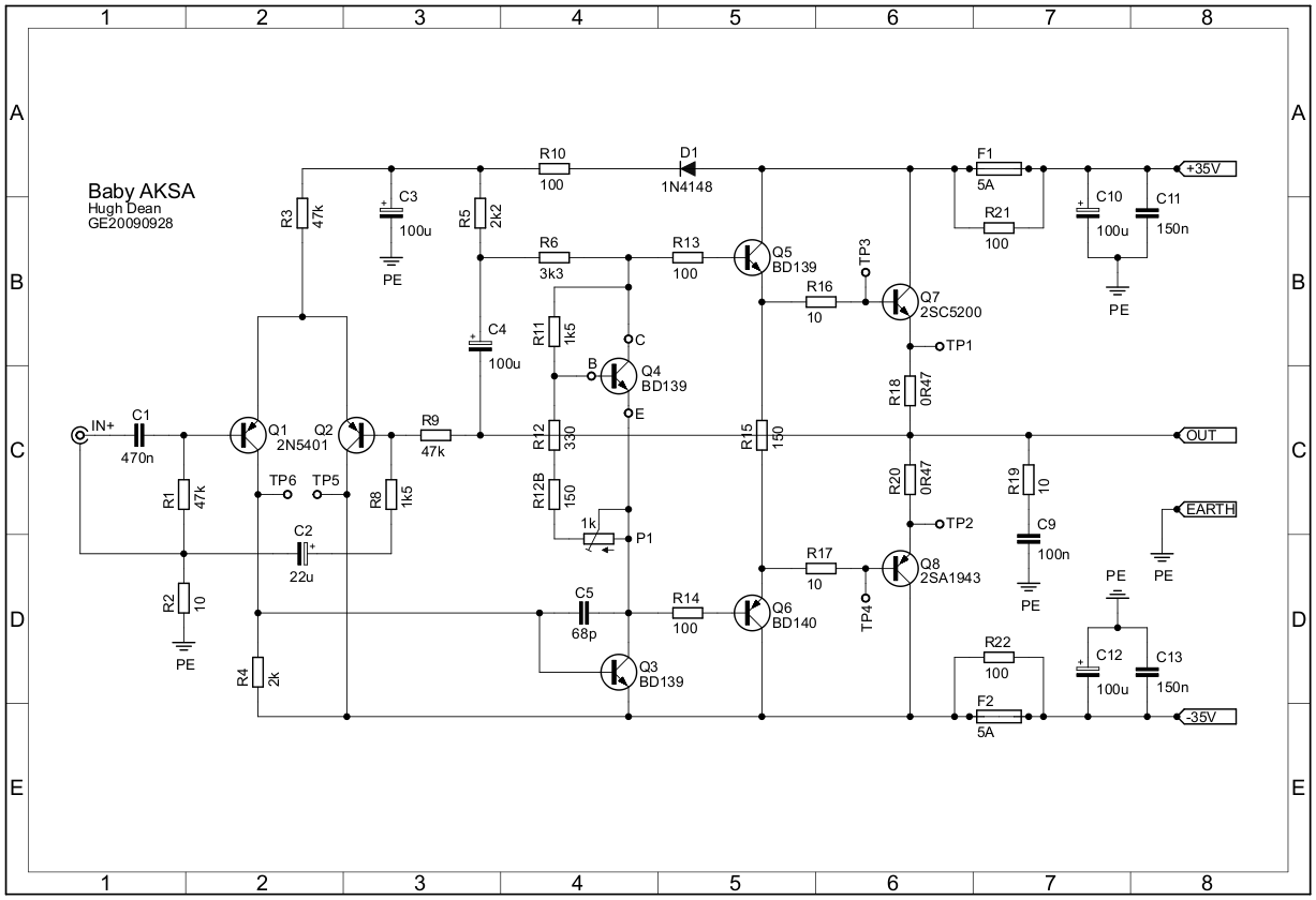

I've re-read all the thread for the Baby Aksa numbers to find an open loop gain of 75 db with a BD139 VAS and a close loop gain of 30 db, so a negative feedback factor of 40 db.
Using LTspice and putting an infinitely large cap from the feedback node straight to ground to measure negative feedback factor did work ok for the Baby Aksa schematic but it still not give realistic numbers wen using this method in LTspice with more complex amps schematic.

It should work..
Use a cap of 100 F.
A strictly infinite cap can create divergence calculus..

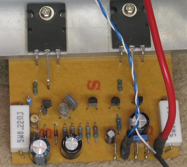

I've started stuffing the boards that I have received. Thanks to Rabbitz generosity, I am able to try the AKSA sound even if not 100%.
My question is do the drivers 2SC4793 and 2SA1837, need to be heatsinked. I've seen on the first page that Gregg has them freestanding and lying on the sink.
Hi wendell c,
I think this is one of those questions where you will get both yes and no answers.
Mine are all free standing. The ones lying on the heatsink are really just bent forward out of the way of the output terminal. Rabbitz has his bent forward over the heatsink and firmly attached with a small aluminum bracket.
Note when they are bend over the heatsink and are actually upside down.
My original AKSA 55 had the drivers free standing for years without a problem. On the later versions, Hugh mounted them on the main heatsink. The AKSA 100 has them freestanding but with an additional heatsink attached.

Wendell,
No heatsink required, but Andrew is right, cooler is better..... though dissipation on a robust TO220 package is 6.5 x 37 = 240 milliwatts at idle, rising to about double this at full tilt. Without a heatsink these packages will reliably go to about 1W continuous, even in a hot climate, so there is no concern either way. You can make your choice, of course, though in Vegas playing Hotel California in the hot sun at a drunken pool party, some cooling would be advisable and may slightly improve MTBF....
Ian is right, the Digi 125 was indeed an early influence, but the AKSA has a few extra features that make a marked, subjective difference to the sound quality.
Hugh
Hugh
Thanks for the clarification gentlemen. I guess I won't worry too much about it and will add the sink at my discretion.
Gregg, that is the whole reason for my question. Because it is mounted backwards, face down on sink, I was wondering what is the best way to mount a sink. Doesn't the sink need to be mounted on the backside for efficiency purpose?
Gregg, that is the whole reason for my question. Because it is mounted back wards, face down on sink, I was wondering what is the best way to mount a sink. Doesn't the sink need to be mounted on the backside for efficiency purpose?
Hi wendell c,
There are only face down because the PCB was designed for a BD139/BD140 drivers.
I like the way Rabbitz mounted them in post #388.
On the test bench, the free standing drivers run a few degrees warmer than the output transistors, below 40 degrees, so not much to worry about IMHO.
Also, this is DIY, part of the exercise is learning from actual experience, try free standing, add small heat sinks if they are getting too hot, finally mount on main heat sink, if it is the easiest solution.
regards

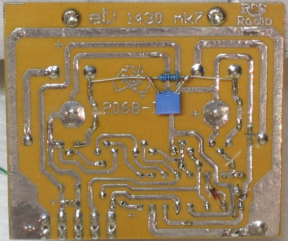

Yep, here is a picture of my DIGI 125 from many years ago, TO92 drivers and all. I have added a bootstrap, increased the bias, added base stoppers and changed the VAS transistor.
It didn't blow up or fail during the many hours of testing.
Hugh
Greg
Did you also add a collector resistor to the input pair, where the original went straight to the supply rail ?
If nothing else it helps to keep the transistors at a similar temperature.
Regards
Alex

Hi Alex,
No, I left it as per the original schematic. The input pair part of the circuit topology is the same on the DIGI 125 and BAKSA (there are a few component differences though).

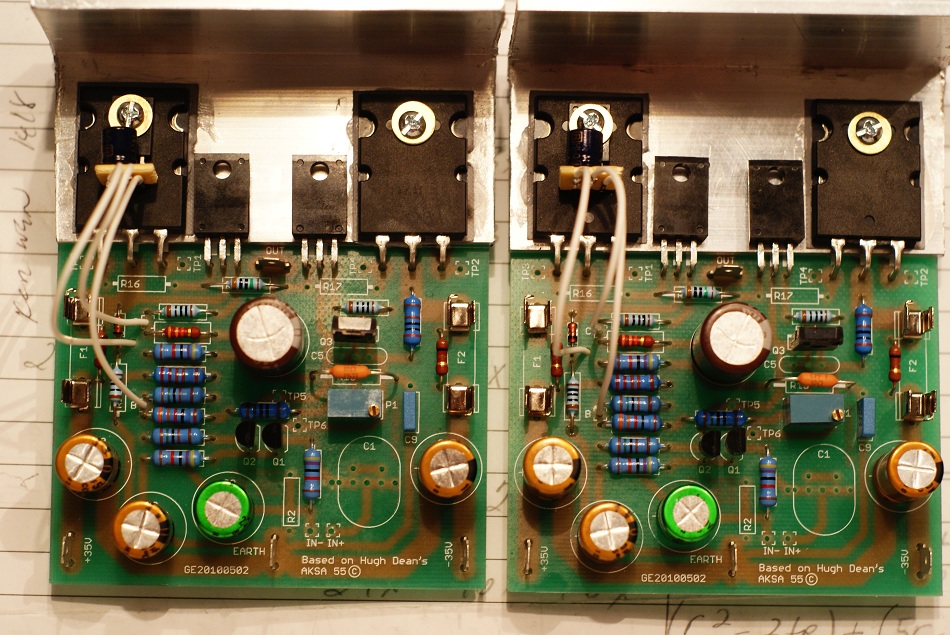

MY Baby AKSA Build
Here is my BAKSA, need some 10r resistors. Does the quality of the 10r resistors on r16/17 make a difference?
I've pretty much used KOA 1% metal films with some Vishays. I have some cheap 10r carbon films from Radio Shack 5% and will use them just to get this going and replace if you folks tell me it will degrade performance.
I have 2sc3423 for VAS, and drivers are 2sc4793/2sa1837.
Need to get some silver micas, the values I have are 100pf and up. I do have some polysterene in 33/47/68pf, are interchangeable for c5?
I did not get the recommended nichicon KZ for the c4, I got a silmic ii instead since that is what DK had in stock.
I pretty much went with the recommended values on Greg's BOM as well as Rabbitz recommendations.
Rabbitz, on one of your pics I see that you have a silver mica cap near the row of resistors. What does that do?
