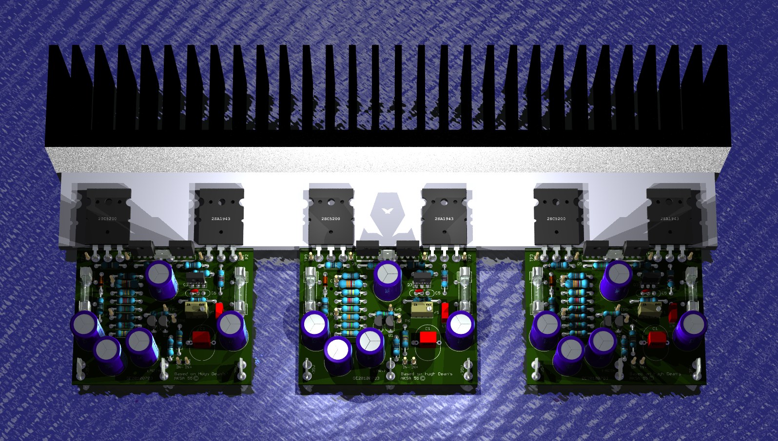

I've been playing with Eagle3D and POV to generate a nice 3D image of one of my BAKSA 55 test rigs. It's the first time I was able to generate a model with multiple boards and a Conrad heatsink (with flange). I plan to create a POV model of the case and include things like the power supply PCB and toriods etc.
It not a "real" advance with the project, but it has been interesting.

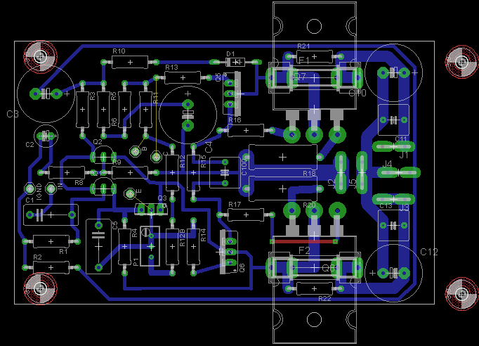

Hi pinkmouse,
I really like those off-board mounting holes.
There seems to be a problem with the spade pads but you probably already know that.

Hi Sound_Buster,
Nice build .
I have noticed some extra components, are they for DC offset adjustment?
What transistors have you used for the drivers and are they mounted face up or upside down? Just checking.
regards
Nice build .
