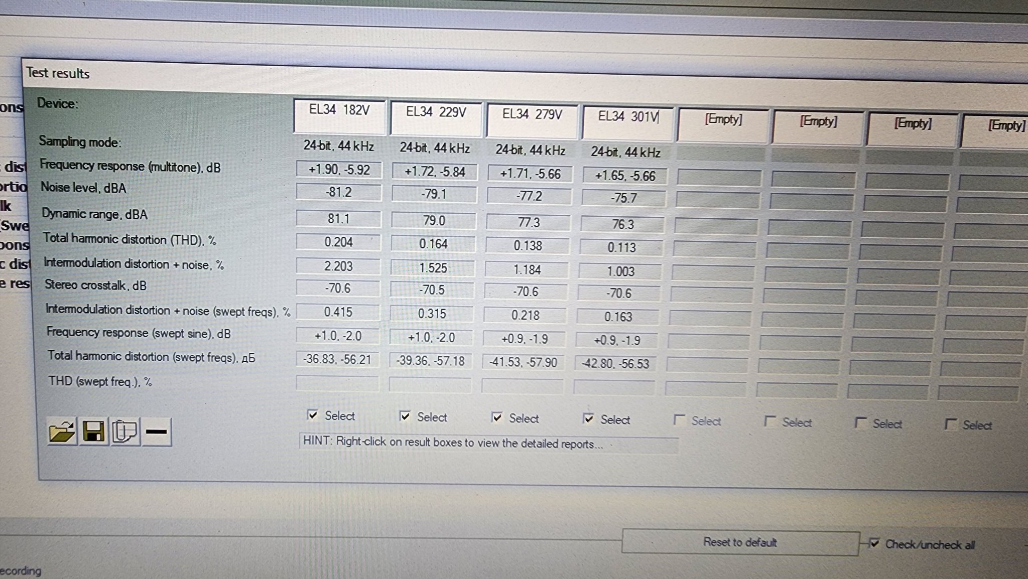

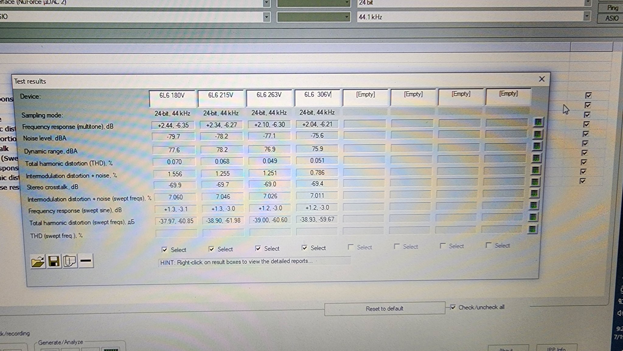

Old thread i know, but why start new one.

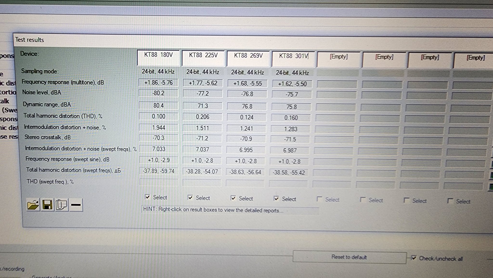

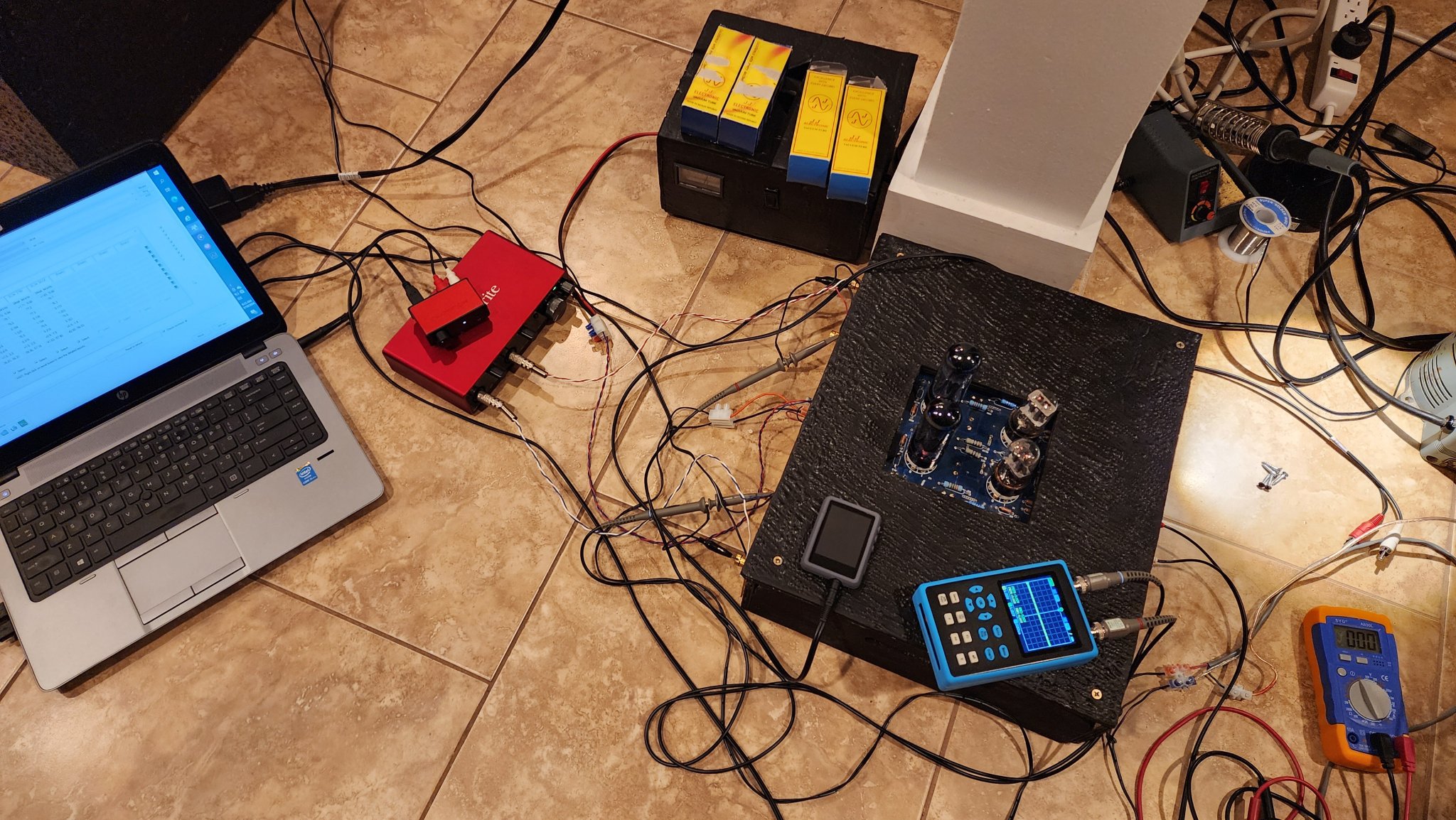

I have been having fun swapping output tubes on se tube amp. It has 6sn7 front, and i was mostly using kt88 on output. Small 5 watt edcor ot.

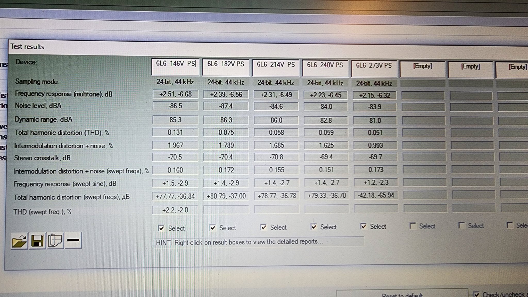

Just for fun i measured distortion at various power supply voltages. I just used variac before my normal hv power supply and adjusted between 180 to 300 volts. Here are some results, some surprising for me.

Nice measurements.
What surprises me is that the noise goes up with higher B+.
What would be the cause?
Edit - why is that IMD so high? That doesn't make a lot of sense.

Most surprising is that 6L6 have lowest distortion, offcourse draw less heater current, and with increasing hv power supply, distortion goes down to sweet spot. And it sounds great too. Well, they all sound good, but 6L6 fits to this little tube amp.
Not sure, i need to work on my power supply. Probably needs more filtration caps. Minus 75dB is not ideal i know.Nice measurements.

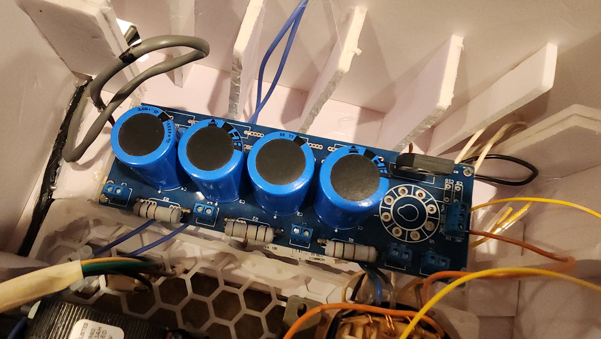

I have replaced CRC with CRCRCRC and noise went down a little. There is more voltage drop, so my power supply does not reach 300Vdc now, but its ok.

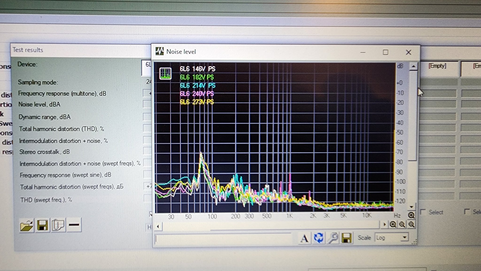

So i remeasured 6L6 output tube, from 140V to 240V. As expected, distortion goes down with increasing the voltage.
The noise goes still little bit up, overlay attached. Not sure why. At minus 84dB its not a problem.

Imd is relatively low itself. Imd + noise is high.Nice measurements.

Isn't the IMD measurement FFT based?Imd is relatively low itself. Imd + noise is high.
Jan
No idea how RightMark measures it. But there are two imd + noise, one looks reasonable, other does not.
