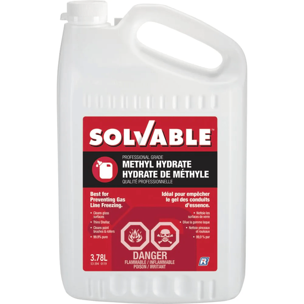

From Canadian Tire. 🙂Here, we use Methyl hydrate - 99.9% methanol.
jeff
Otherwise known as denatured alcohol.Methylated spirits ('meths') must be British I suppose. It is ethanol (95%) and methanol (5%) and died pink, to create something not drinkable so there is no excise durty.
Tom
Or the paint section of whatever home improvement warehouse you prefer.From Canadian Tire. 🙂
I'd think that isopropyl alcohol would work too. You can get that at any pharmacy/drug store. Get the 70+ % version.
