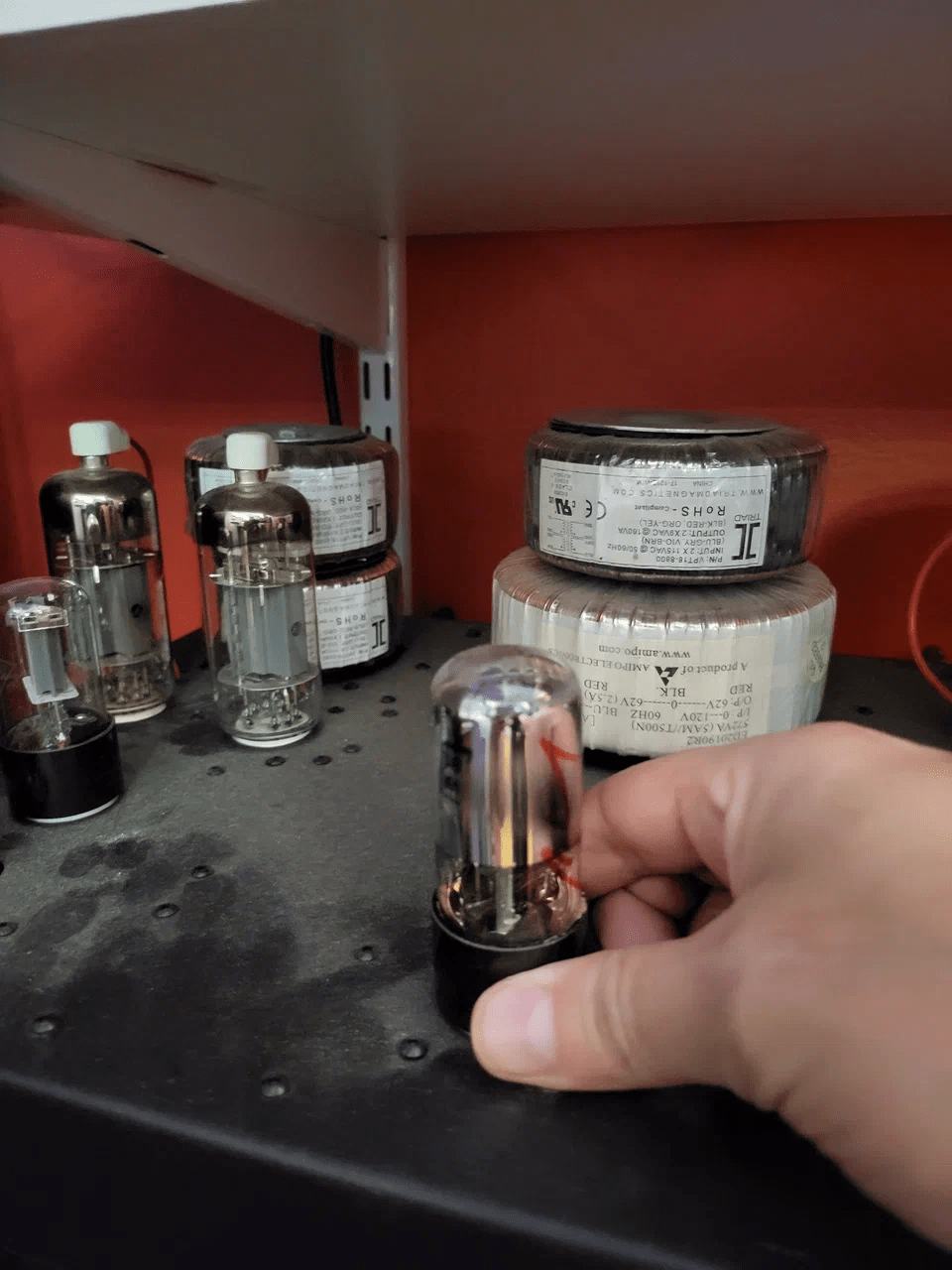

I use "Wasserglas", sorry i only know the german wordHi tube friends. I got question. Have been playing simple kt88 se amp, great sound, having fun swapping various kt88 brands. However, i noticed one tube is slightly loose between the glass and base.
Any remedy?

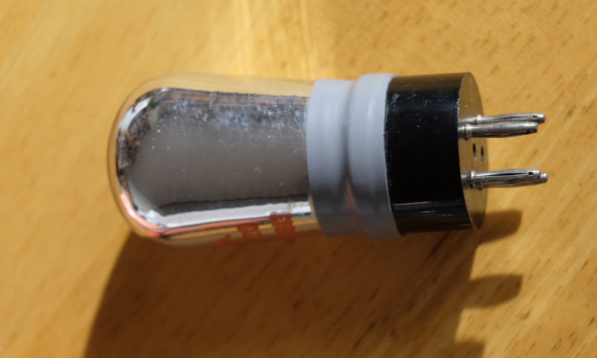

I just did four tubes this afternoon that had slightly loose bases. I used Krazy glue and let it "bleed" into the crack between the base and the glass. It worked very well. I have not tried the tubes in sockets yet. I suspect they will be fine. I used a mini tube of glue.
I hope this helps
I hope this helps
