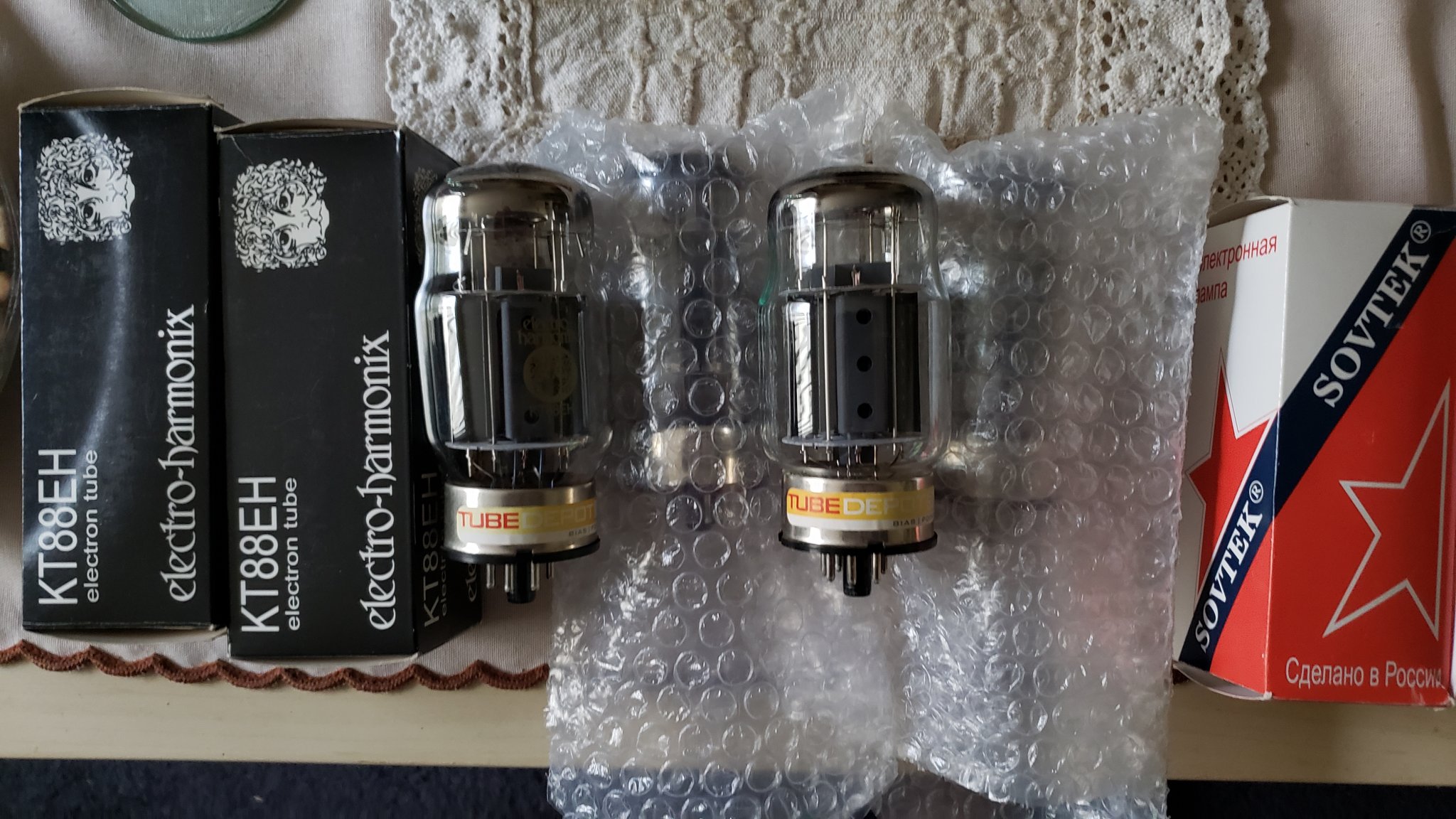

Use petrol or gas as they call it in the US. Suck some up in a syringe then dribble it into the base, leave to sit for a few hours then push and twist, seat the base, then leave to dry. This "melts" the original stuff.
Andy.
Andy.
It did not work for you, but was recommended from the UK Vintage radio site, and has worked on the tubes I tried it on. So not 'BS'; it is an easy option before the other options need to be considered. Maybe this is not a NOS tube, and the glue that fixes the base is different composition?Perhaps its the same bs as a alcohol idea. I tried pure ethanol for one and a half hour soaking. It did not work.
There is a useful video about this issue on the "Tube lab" youtube channel of valvesnmore - they sell NOS tubes. They use shellac injected with a syringe and cured with a heat gun, after wrapping the base in blue tape to protect from spillage and excess heat. Apparently, there are two main adesive compounds that have been used for the purpose: the older one is sensitive to alcohol and does bear some affinity with shellac, the "modern" glue is syntetic and insensitive to alcohol.
Current production kt88.It did not work for you, but was recommended from the UK Vintage radio site, and has worked on the tubes I tried it on. So not 'BS'; it is an easy option before the other options need to be considered. Maybe this is not a NOS tube, and the glue that fixes the base is different composition?
Absolutely no BS. I first tried mentholated spirits with no success but tried petrol on a completely loose base of a 866A MVR, the petrol dissolved the gunk. I re-seated the base, soldered up the pins and put a big elastic band around the valve overnight. It was still a tad loose so I moved the valve to somewhere warm, it stuck.

I used krazy glue on a 6SN7 and it's been find for months. Of course, 6SN7 doesn't get as hot as KT88.

I will try that high temp epoxy, give me day or two.

I also tried black silicone for high temperatures but it remains very elastic and making it uniform is a mess. Most of the epoxy resin is in my opinion to be avoided due to the different thermal expansion compared to glass.
Suggest you apply the epoxy to a warm valve/tube as it will make the glue more fluid and seep better, and/or use a hair-drier.
Since glass is a particular material I would try a specific glue for glass like this (just as an example)

taking care to try how it adheres to the material of which the base is made by placing a droplet on the outside of it and only then by carrying out a gluing.
