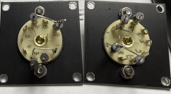

Thanks for the reply. Resistance measures the same, bias voltages the same, anode voltages too. After swapping the tubes, with a proper meter, still have less on one channel than the other (tube swap not affected measurements, 35mA vs 75mA respectively). A bit confused, yet such a difference would really be audible.

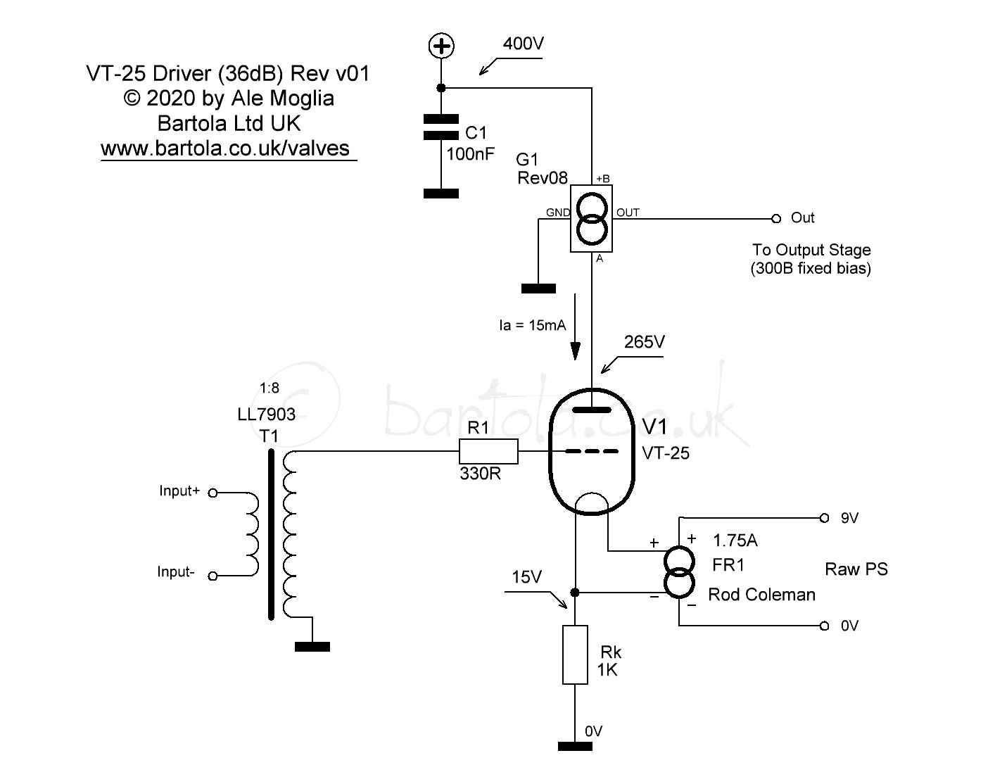

Hi Paulius,
Ale's schematic show the FIL+ connected to the 1,0Ω current sense resistor. This works for the older version of my filament regulator, but the RC-V9 (that you have) connects the negative side. Please check that FIL- is connected as the cathode in both cases.
Another check:
Please be sure that the Filament Raw DC in both channel is truly floating: disconnect the output and measure to chassis and to anode supply zero-volt return.
(DMM on 2kΩ range, or similar).
Film resistors canget unreliable if they get overloaded. If you have a spare, you can replace it.
Are you sure, that oscillation was not created in one channel?
It should be checked with oscilloscope.
Try to brake apart D3a VAS section and source follower (lift the coupling capacitor).
If measured difference is disappeared, the D3a may oscillating. As Ale wrote: ferrite beads on all pins.
I always use 100R carbon composite resistors instead of shorting (8, 9 pin to anode).
Be sure, that 1, 3 pins connected together.
Small correction, the driver is VT-25.. should I NOT be hearing this oscilation? I am Pretty sure regarding Rod’s comment on the floating supply and the resistor connected to the Negative regulator output, but will double check tonight
Thanks on the input.
Performed checks and found a mistake - grounds of left and right fillament raw dc supply connected though a solid brass pcb post - fixed that with plastic spacers, and now can measure actual plate current, both tubes at 60mA. Would I benefit from running them any hotter? Anode voltage +390V, grid bias -80V.

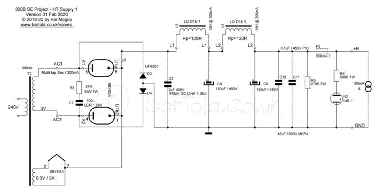

2) HV power supply - could be upgraded to properly handle 230mA and 450V, together with going back to tube rectification (now, because of the need for higher voltage, using 4x Schottky diodes.
