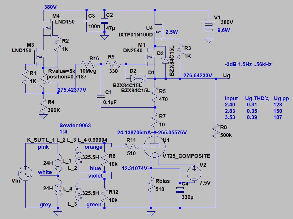

If you increase the 10Y current (circa 24..25mA, if you use 510R instead of 1k cathode resistor) , the tube will be working in more linear region, so THD of driver is reduced by -about- half.
sample:

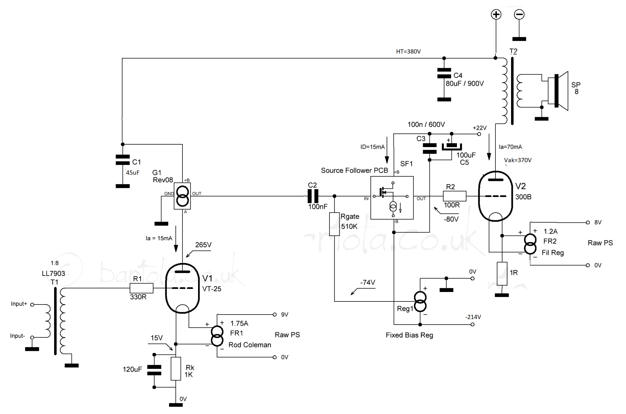

Hello,
I took the liberty to mock up a schematic using Ale's existing drawings. During the limited time for testing:
1) Substantial hum developed, I have shorted the input - to ground to eliminate that, yet need to investingate further.
2) VT-25 Rk is bypassed with a 120uF DC link, not sure if that's 100% needed.
3) Voltages for source follower are bit of from planned +22V and -214 instead of +25 and -200V respectively
4) Source follower LED is only dimly lit. It lights up brightly for a moment during HT+ start-up. Is that an indicator that I am barely reaching required 15mA?
Based on @euro21 , I need at least 395V on the Gyrator B+ (Currently 380V), to ensure 200Vpp swing (265V for the VT-25 +30V Gyrator headroom +(200 Vpp swing/2)
To increase that, I need to switch the tap on HT transformer, to go from 400V RMS to 475V RMS, yet then I need to limit the current though 300B and total current of power supply (Chokes are 200mA). Alternatively, I can try to modify the HT supply (remove one out of the two chokes/replace it with resistor ) to see where the operating HT voltage lands. in the HT supply I am using a 5u4G and a pair of C4D05120A
All in all:
Trying @euro21 modification on the Rk for VT-25 is easy, a pair of resistors and electrolytic cap, Current should be just borderline OK for the HT PSU.
Increasing the voltage on the HT PSU overall is a bit of a challenge, as have no variac to safely test. What could be the options? I am thinking of:
Cranking the 300B bias way down to be safe on the start-up,
Putting in a 5k Output transformer that I have,
Buying an array of 25W resistors (200-500R) to test,
Placing a 100mA slow-blow fuse in line with 300B 1R Rk,
Any advices to keep me (and the gear) safe are appreciated, thanks.

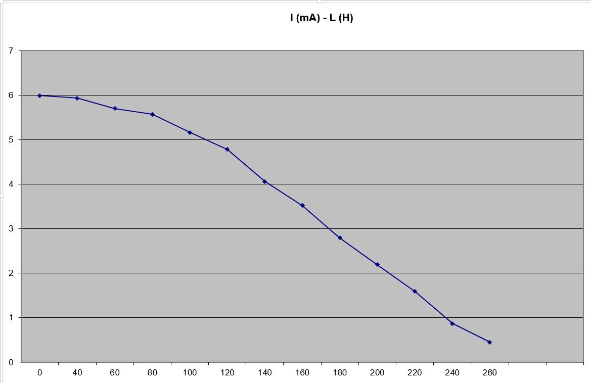

If you use 15H 200mA choke with -significantly- larger current, the inductance will be decreasing (and the dissipation increasing). If the current slightly exceeds 200mA, practically nothing happens.
sample: 5H 100mA choke at different current.

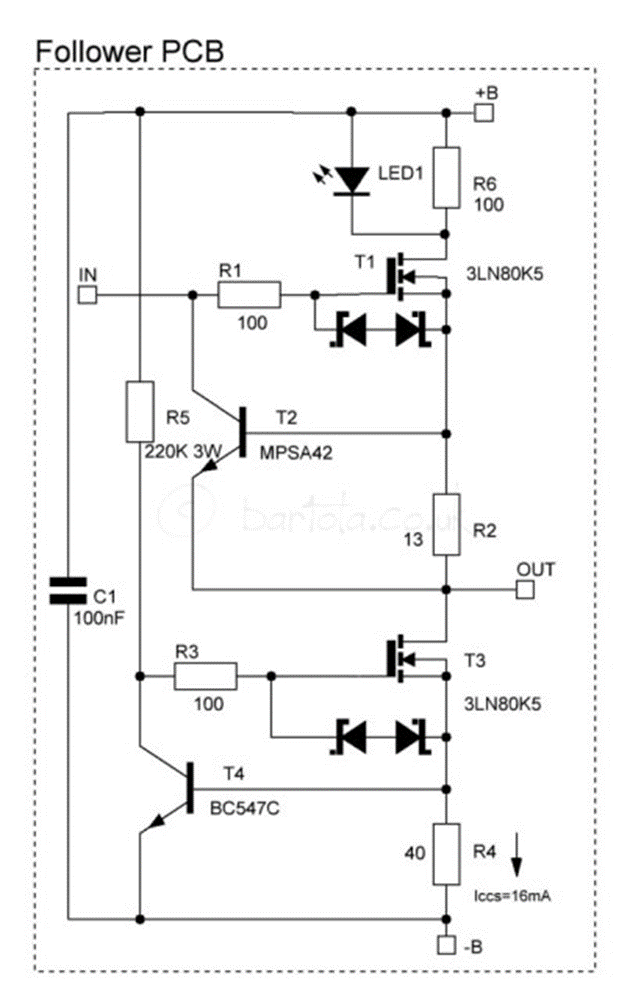

Then -this type- source follower need circa 20V headroom at both swing end, so +20V and -180V requiring.
If you want use 300B in A2, +22V is insufficient.
For A2 capable 300B amp I usually use FET/SiC FET source followers CCS or resistor loaded to -220V, and much larger positive supply: +220 ...400V.
