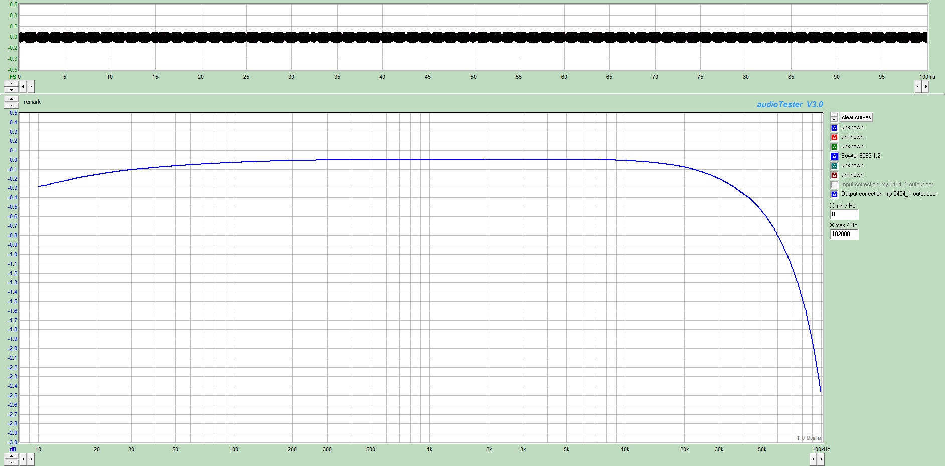

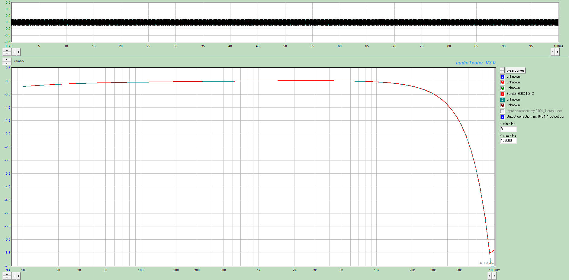

If you use these transformers with all primary paralleled (or half primary used) and all secondary connected serial (to reach 1:8 transmission) due to the transformer parameters (mostly capacitances) and source impedance, the high frequency response will be degrading.
For example Lundahl defined LL7903 10Hz..70kHz +/- 0.5dB at 600R source impedance and primary and secondary coils connected serially.
Look Ale measurements wired this transformer as 1:8.
https://www.bartola.co.uk/valves/2020/07/15/300b-se-amp-46-driver-part-ii/
It does not mean that this transformer not good, but not developed for such requisitioning.
If you use it as 1:2 or even 1:4, higher bandwidth expected.
Look -my- Sowter 9063 as 1:2

and 1:4 wiring.

Ok, so a slight degradation or high frequency roll-off is to be expected. Like you said, no free lunch, yet I guess there is no design without compromises - I need to start somewhere. Thank you for thorough explanation.

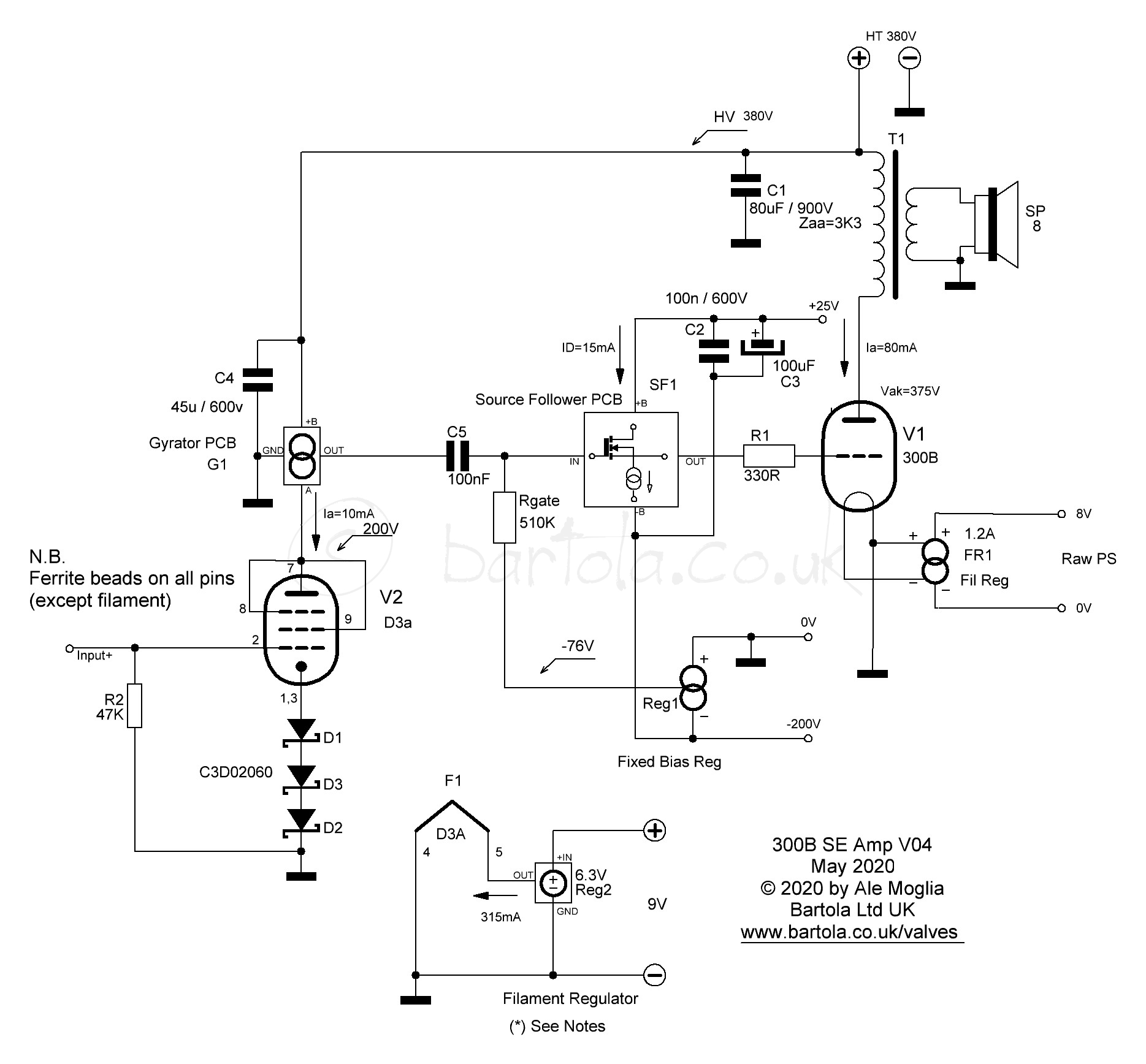

I use similar design (CCS loaded, green LED biased D3a, 100nF V-Cap CuTF capacitor, FET source follower, 300B SE, 5k:8 OPT) for more than a decade.
The quality of C5 is very important. Use there the best capacitor you can afford.
I mostly use teflon capacitors (V-Cap, soviet FT-2, FT-3) for coupling, but it's my taste. Any good copper or silver folie capacitor working well there.

Triode d3A is very good with gyrator. I like E810F as well. I use C3g triode connected with gyrator load (like Ale does) to drive 2a3. Also, there is E280F. And apparently there are soviet-era valves/tubes that are great as well.
I needed to use ferrite beads on d3A and E810F, but that is not a big deal.

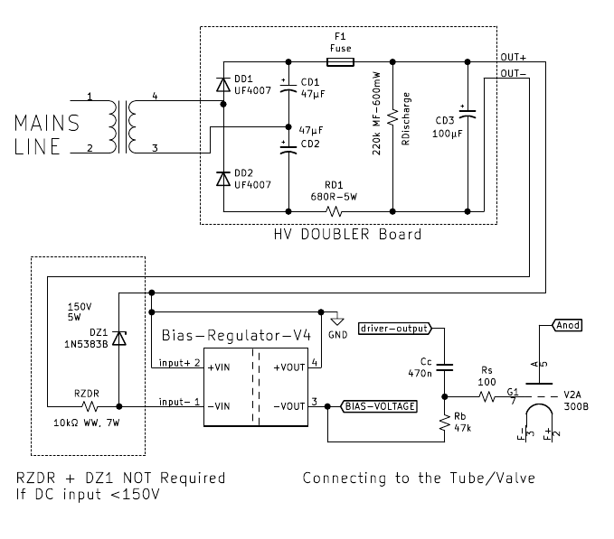

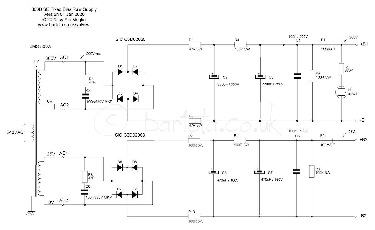

I am planning on using Coleman Fixed Bias regulator for this application - however, it has a max voltage input of 150V. Bartolas designs is asking for 200V for the source follower, however, Coleman guide allows for "any" voltage, as long as their is a suitable Zener (DZ1) accross the input together with an adequately sized (5kΩ 7W) RZDR resistor on the +.
Will this (Zener/Resistor) voltage drom will not introduce noise into my expensively filtered HT supply? Perhaps it would better to form a suitable resistor/capacitor voltage drop from the PSU?
Paulius, the zener on the input of the bias regulator will not generate any noise on the bias output - it will remain below 10µV.
The zener will see a small amount of noise, but this is RC filtered from the 200V supply, and rejected in-circuit because the source-follower has a CCS (high noise rejecting design) to take care of any that remains from RC filtering.
I would be surprised if you can even measure a difference, with or without the zener, but if you want to test it, please add another layer of filtering: use a 4,7kΩ resistor for the dropper, and add 330Ω in series with it. Add a 100µF 200V cap at the node between these resistors. Now try measuring noise with and without this capacitor (and let us know....)
Reactions: PauliusT

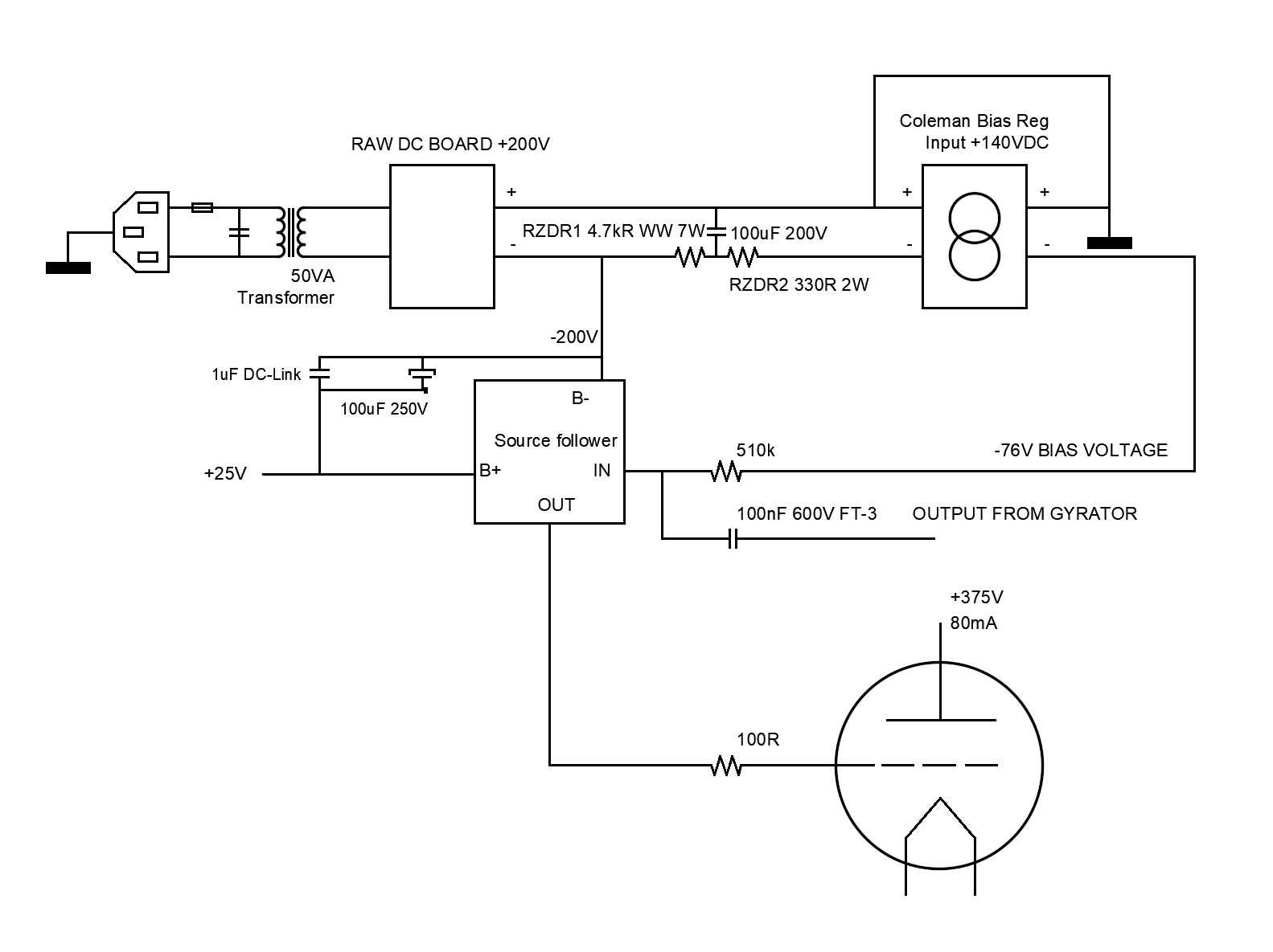

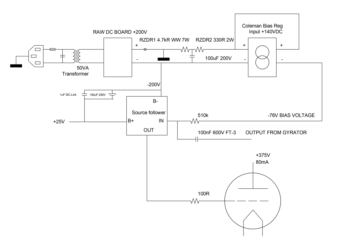

Thank you! So something like this below in the schematics?
It will take some time before I can measure, but surely I will, as its an easy and interesting (well, for me) test to do.
Also, should I add a 1R or 10R Rk resistor to measure the Bias point of 300B in the startup? Its seems to be running very got, I would definitely try to start up up with a strong negative bias...
Paulius
Paulius, Please connect the POSITIVE input & output of the Bias Regulator to Ground.
Then, the RZDR resistors are inserted in the Negative supply line, as per Post #30.
Yes, 1Ω current-sense resistor in the DHT cathode line can measure the cathode current. It's a good idea to measure it - some driver circuits can send positive-pulses at start-up.

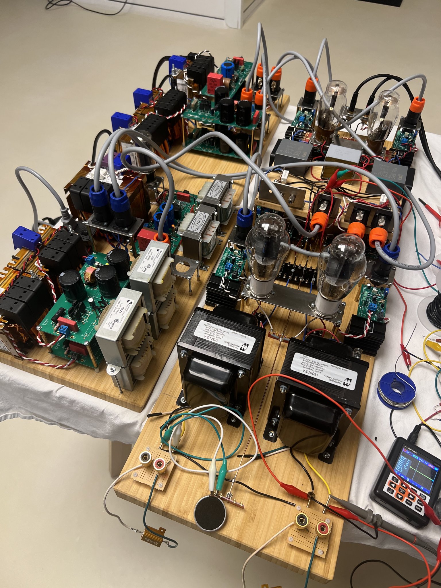

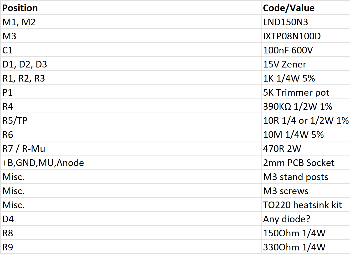

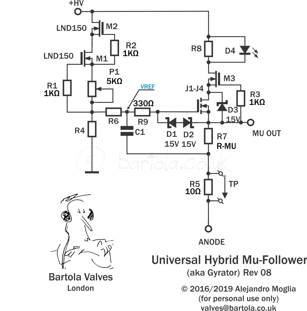

Just doing some tests on the driver stage assembly and noticed, that I have made some mistake in components selection - I cannot set the Gyrator Anode output voltage higher than ~210V. Input side I have got enough headroom, both boards are operating the same way, I guess that must be component selection related. Perhaps somebody has experience using them and could help me? Trying to reach a 15mA 265V operating point for VT-25 with 1kOhm bypassed Auto bias.
I am using:
CCS (M1, M2) generates required current. This current on R4 produces VREF, which is the "gyrator" reference voltage.
If I(ccs)*R4 is too low, this will be the limiting factor.
Required reference voltage range would be about 250..270V, so with R4=390K the required CCS current is:
270V/390k= 0.69mA
The CCS HV must be -about- 30V higher, than voltage on R4, so at least 270V+30V= 300V.
If you want to us this device as driver, the gyrator B+ must be:
265V (+ Rmu*Ia) + 30V (gyrator spare voltage) + required swing peek voltage/2.
Try to test gyrator with dummy load:
265V/0.015A= 17 667 Ohm ... 17.5 or 18k 10-12W resistor.
If gyrator fulfil the required parameters, it' ready to operate.
