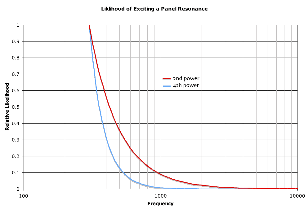

I suppose the lead would lower and even amplify the resonances. As far as i know the reason to use (strong) plywood in the first place is to get a light but stiff material to push resonances above enclosure/driver bandwidth.2mm layer of lead in between two sheets of birch ply?
Edit: the above is probably most valid for bass enclosures. Mid enclosures may be different, as the panel resonances are below useful bandwith. In this case lowering resonance frequencies and adding weigth may be useful.
Given that the amount of energy to excite a (potential) resonance decreases quite dramatically with frequency. So the technique has been shown to work with single FR speakers. I would not do a mid enclosure any different.
