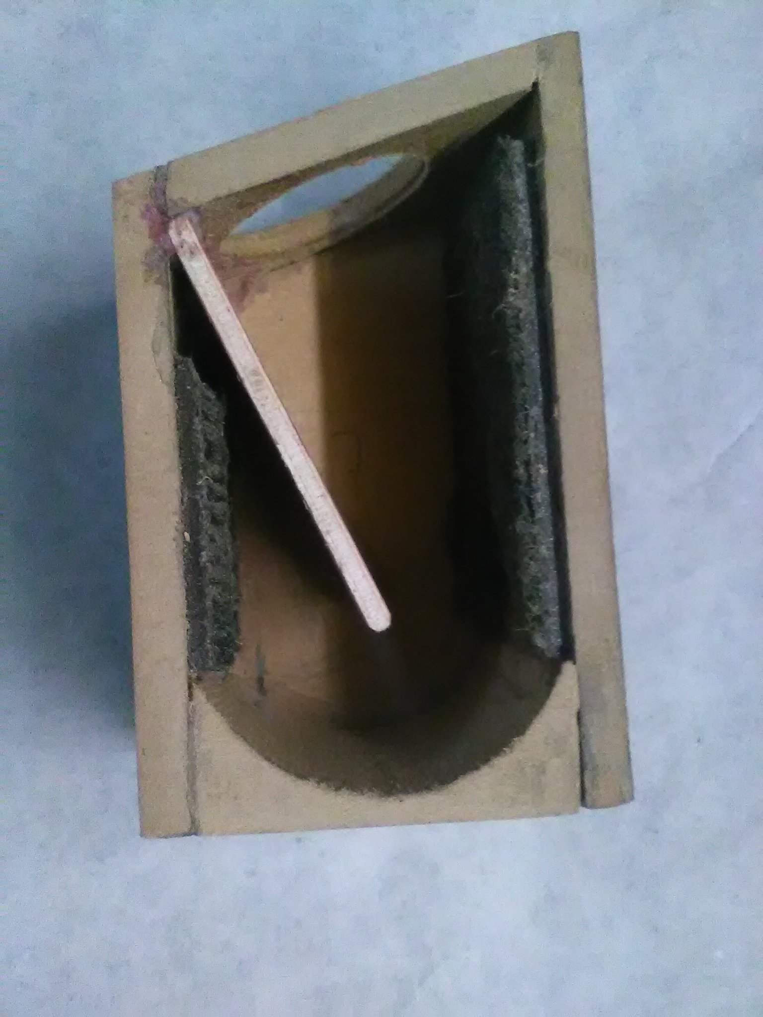

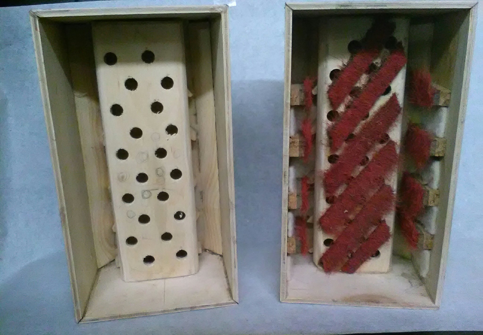

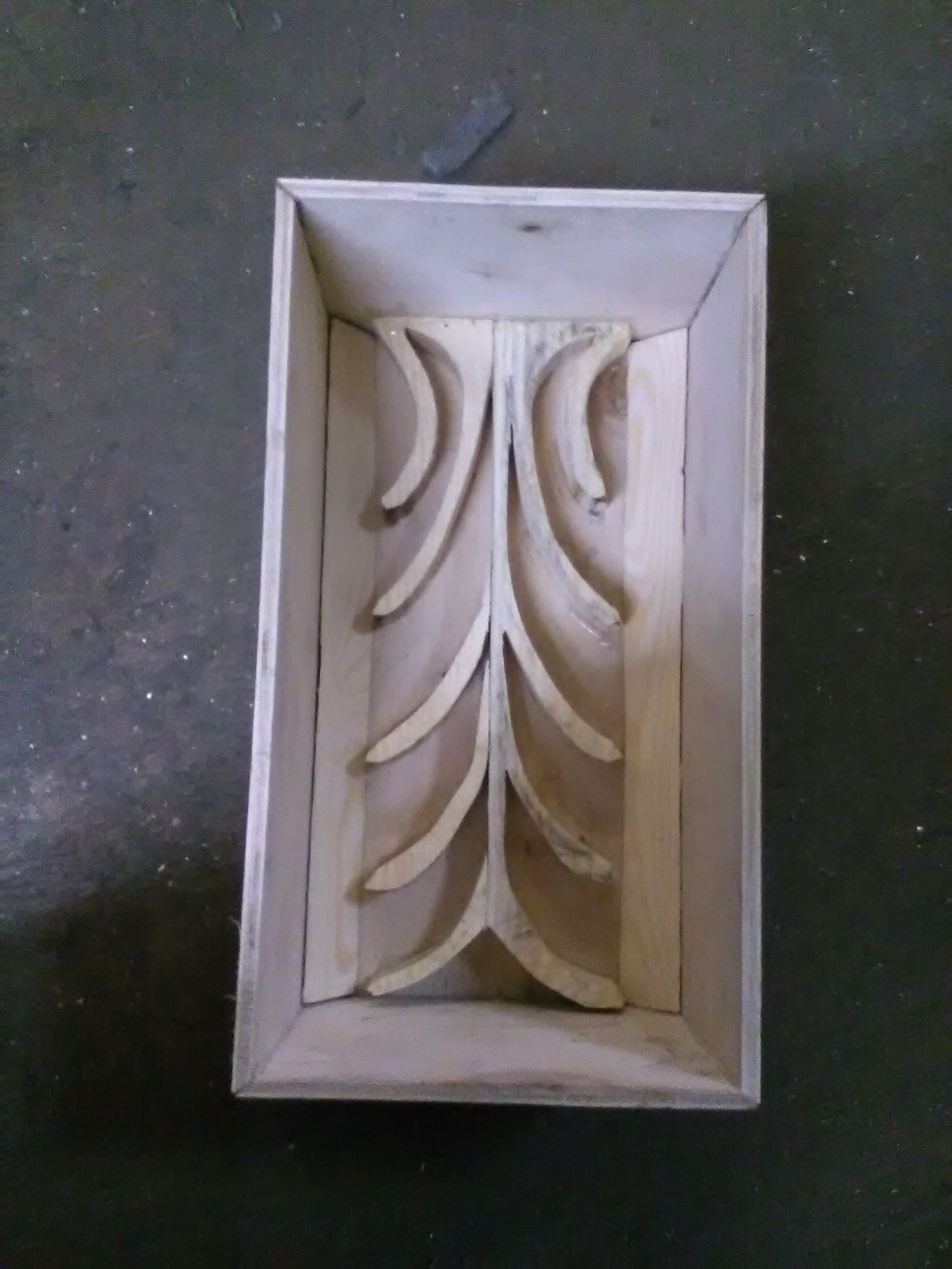

I've always wondered about this, everyone is so engross in building a dead cabinets but I don't think I've read any thread on
preventing sound within the cabinet from reflecting onto the back of speaker cone. Isn't this far more important ?
I've done all-sorts to stop the rear reflection, the pic on the left is the most simple, the two other pictures are of a "Christmas tree" diffuser. When I started fiddling with speakers, I use a steel mass to isolate the vibrations from the driver from the rest of the cabinet, and it was remarkable how this highlighted the echo's from inside. My favourite speaker that I've made is a "box in a box" design, both the mid/bass and cone tweeter are in their own enclosures, inside and mechanically isolated from the main enclosure, the mi/bass enclosure is so short front to back that a wave/reflection can't form within it's frequency range.
