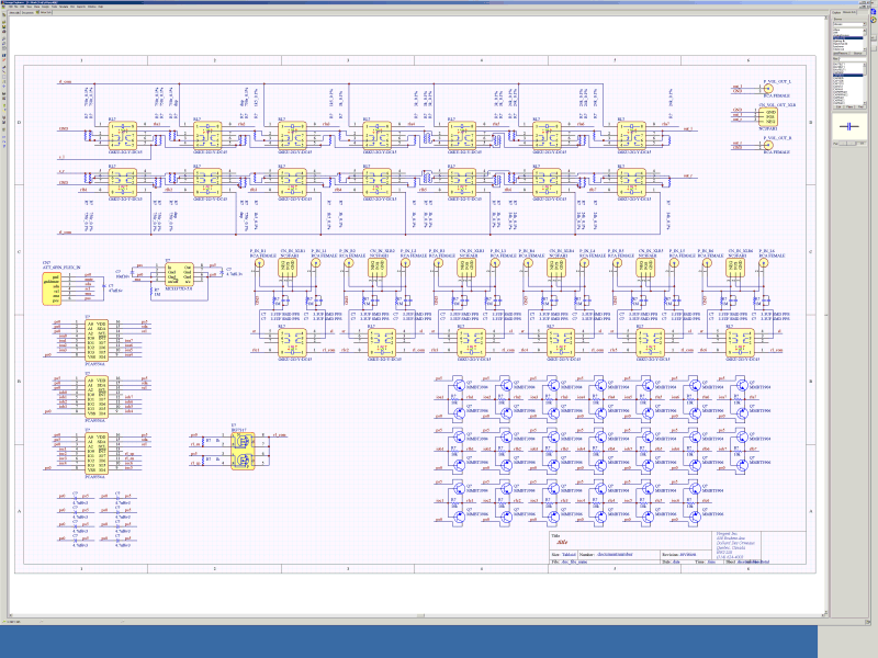

My passive, wireless remote control, battery powered preamp is coming! It should be puny in size & price compared to what I’ve seen so far in this topic.
I'm now doing the IR receiver / processor & display PCB, schematic of the attenuator module is attached.
-It runs on 2 lithium coin cells. They should last at least a year.
-Consumption: 100ma for 2 seconds just after a volume change, 30ma for 3 more seconds while the 4-digit display is on, less than 0.003ma (3ua) while nothing is happening. Processor is completely stopped here, ABSOLUTELY NO EM signals being generated at this time. Even the microcontroller oscillator is shut down.
-Supply range, 5v to 16v dc.
-Supply is completely isolated from the analog audio path.
-Software selectable linear pot emulation, or, volumetric pot emulation.
-Software controls learns remote signals from 1 of your existing remotes.
-(modules only) Exclusive special price for DIYaudio forum members.

Why don't you post the schematic, my eye are not good enough to see what your doing.
Brian,
Sorry, waiting for the first PCB before I potentially embarrass myself.
Also, I guess I might as well wait for the processor schematic to be finished & post everything in it's own thread.
I gues you could call this a preview...

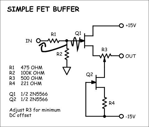

Instead of placing the pot between output and ground (4 needed) place the pot between positve and negative output of ea balanced channel (2 needed), so one stereo pot would work. This way, depending on impedance of the pot, positive and negative output will cancel each other without conecting to ground. You can find this setup in Pass D1 DAC.
Yes.I think it's better to do it after 221 resistors. Also 100k is too much for the output. Both this resistor's value and 5k to ground should be carefully chosen for best operation.

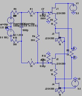

Hi Grant,
The options to adjust the volume of the BZLS really freak you out, don't they? Apparently, the simplicity of the line-stage makes it more difficult to decide upon the 'right' level-control 😉
Anyway here are my observations:
The maximum value of a pot at the input is restricted by the input capacitance of the MOSFETs. A high value pot together with this reasonable capacitance (in nano-farads) forms an RC-filter that causes a high frequency roll-off. For this reason, Nelson advices not to exceed 10k. In the Aleph P he just omitted the input pot to increase the bandwith of the line-stage.
The output impedance of the BZLS is directly related to the value of the pot. The lower the better and as Nelson explained 5k seems reasonable
I have simulated this alternative with Simetrix and found out that the value of the pot needs to be 1k to be effective. Be aware however that with unbalanced sources the output level of the two polarities of the signal is not the same, which makes the attenuation of the signal with a balanced attenuator a problem at low volume settings.
Hope this helps,
Fox
1. How do you calculate the optimal value for a (normal) volume control at the input to your preamp? I have heard 25-50K mentioned for the BZLS input. How/why?
2. How do you calculate the optimal value for a (normal) volume control at the output to your preamp? I have heard 5-10K mentioned for the BZLS input. How/why?
3. With the single-pot method of volume control of a balanced amp, no part of the pot is grounded, or placed across the amp's input or output. How do you work out the right value for this pot?
Hope this helps,
Fox
1k!! That is extremely low. Why? What goes wrong with a higher value? The multi-channel volume control I am thinking of using only comes in 10k and larger sizes.
Above 1k the signal won't be attenuated, which means that with a 10k-pot you can only use the first quarter of the pot-range. This results in a very small range to attenuate between very loud and very low sound pressure levels. Sorry but that's life for ya 😀

It was simulated - where? A, B or C (post 72)?
I think that A, but nearby the input (C) would be maybe fine with a higher value, too -?
Could you possibly simulate it?
Laci
Hi Laci,
I simulated the circuit at A (post 72) but contrary to the picture, after the 100K resistors. Attenuation before these resistors does not work.
According to my simulations, attenuation at the input (C) should work well with a 10k-pot. A 20k-pot should also work but does result in an increase of the signal in comparison to a 10k-pot. This implies that with a 20k-pot the range between 10k and 20k does not alter the signal level. So the conclusion seems justified that with a 10k-pot the most accurate level-attenuation is possible because the whole range of the pot can be used. 🙂
Hope this helps,
Fox
Hope this helps,
Fox

Sorry to resurrect an old thread, but...
I'm having a big problem with putting the pot between the two lines of a balanced channel, as the simulation gives me an attenuation curve that is opposite from what audio taper is supposed to be. Most of the attenuation happens for pot settings that are lower than the series resistors it follows.
The attached image shows my situation; R4 is the pot, with the DAC output represented by the sources on the left, and the buffer on the right. Using a pot of just a few K gives a more normal curve, but the maximum volume is a third of the original, and with no voltage gain stages after this it's no good. I know there was a way to use a shunt resistor to fake a log law, but that does not work in this configuration. I can't figure out how to do this, so I hope someone can help.
