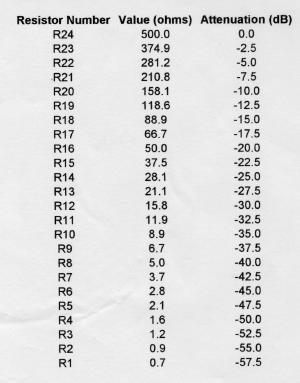

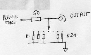

I'm using Elma type 4, 2 gang switch at the output of my DAC. Besides slight noise when switching, I'm quite happy with it. There are two versions of that switch, this is the better one, with improved contacts. There is one series resistor in 50 ohm value and I'm only switching shunt resistors which range from 500 to 0.5 ohm. This assures very low output impedance. If there is an interest I can post the values.😉

Does anyone have plans for physical construction of attenuator in which resistors from peters table can be used? how did you do it peter?
Peter,
It looks to me as if the attenuation values you posted are for a 500 ohm series resistor not a 50 ohm.
I see now🙂 Didnt looked at that pic closely before.. Attenuator on this pic is for 1 balanced ch. only?

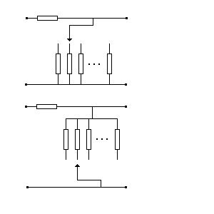

Does anybody know which is preferable (if useful at all in bottom version) of the different versions below? I read something about having the switch as close to ground as possible but in this case it seems maybe a lot of stray capacitance would be added?
/UrSv
/UrSv
UrSv
I would go with a top one, somehow I don't like the idea of so many resistors hanging from the output.

It's stereo, I'm not using balanced output there.

doesn't the type of connection vary the output impedance of the circuit? I don't know if I like that.
Also I was wondering what would happen if you put a 5k fixed resistor to ground after the 50 Ohm as a way of getting rid of the switching noise. The log curve would be changed but that should be about it.
