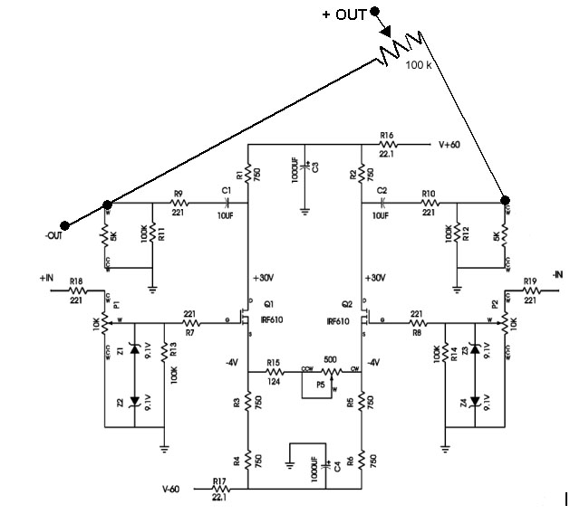

How can I make a volume control with one pot (or attenuator?) for both channels of bosoz running balanced (now im using two 5k stereo pots of not so good quality)?

Instead of placing the pot between output and ground (4 needed) place the pot between positve and negative output of ea balanced channel (2 needed), so one stereo pot would work. This way, depending on impedance of the pot, positive and negative output will cancel each other without conecting to ground. You can find this setup in Pass D1 DAC.
You can use Peter's idea but be aware that it can change the character of the circuit. Look at the original BoSoZ article. The distortion is related to gain, and using a pot between the two sides of the circuit changes the gain.

Is that option for a stereo pot in the BOSOZ schematic as well? I seem to remember that being built in to the design.
Any idea on what resistance value to put there? Any pro/cons to doing it this way?

The gain pot is the separate pot. The pots I'm talking about are at the output.
I don't think it was discussed in the original article. What I'm suggesting here is a quite clever way of using single stereo pot to control balanced stereo output. I can only see pros (since pots don't even have to be matched perfectly) and none of the cons. Yet, this method is not very popular with DIYers, anybody knows why?

That's not too bad. For everybody considering that approach I suggest using fixed series resistor and change only the resistors to the ground with a switch, like Harry did in his passive pramp.😉
We used a pot across the balanced output in the
DAC, as described by Peter. It works fine except that
it won't give you absolute zero volume. There is always
some residual output at minimum.
Is this what you mean?
