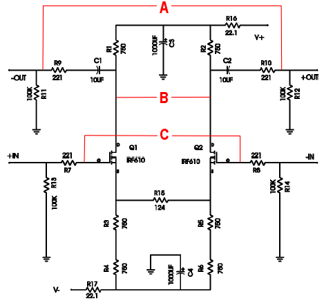

mefinnis said:Resurrecting an old thread, which was brought to my attention by a friend.
Clearly there are a number of options as to exactly where a single pot/switch may be placed.
Which of the following (A/B/C) do we think would be the best option?
Thanks,
mark
Don't forget changing the value of R15, except it works in the opposite direction. Higher resistance is lower gain.
