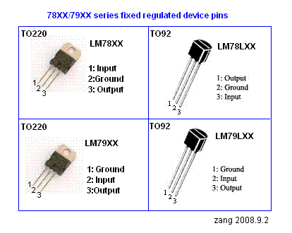

I vuilt two of these boards and when I fire them up I get -15V on the negative pin of the DIP8 socket, but a whopping +30V on the positive pin. Im inputing that voltage so it seems as though my input passes through unregulated. Now this happens on both so what could cause this? A faulty regulator, maybe, but two of them? I used TO92 style regulators with heatsinks mounted on them.
Ok, so I tried running the board from an 18V supply, but the + side is still not regulating. Im not sure what is happening here. Any ideas would be welcome.
digi01 said:turn the positive regulator 180 degree.there are pins different of TO220 and TO92.
the attached is a pins direction.
H.B.
Thanks, but Im running with the L78L15 and it have the reverse pinout from the LM78LXX TO92 regulator and the same as the To220 regulator. At least according to the datasheet. This was the first thing I checked, but I didnt switch it around since the datasheet indicated the correct pin layout.
I desoldered that sucker, not an easy feat, and sure enough you were right. It works now, so I guess the datasheet from my supplier is wrong or I didnt get the correct regulator. Thanks for your help.
