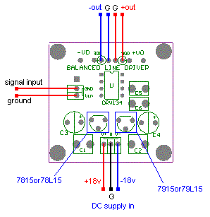

hello digi01, hope its not to late to post here.

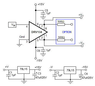

I wonder (as i am very new to this) why does your pcb have a positive and a negative voltage regulator? All the circuits i have experimented with recently have just used a positive regulator. Will this drv134 chip only work with a + and - regulator connected to pins 5 and 6?
thanks for any info : )

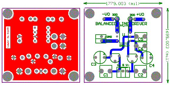

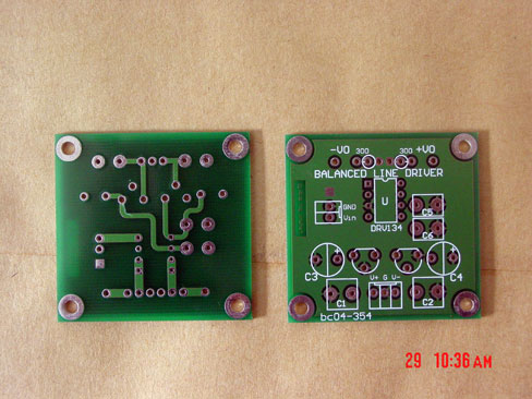

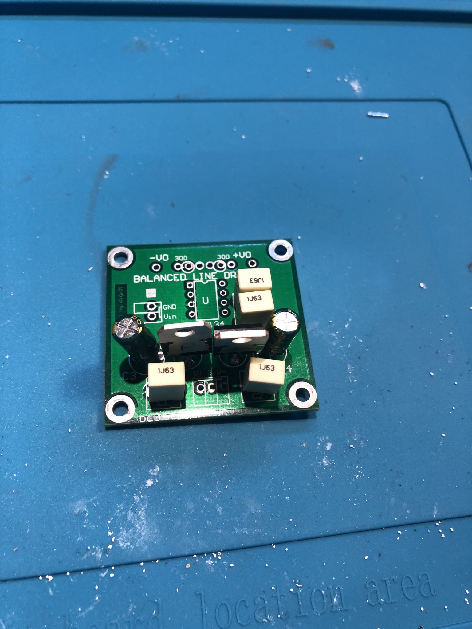

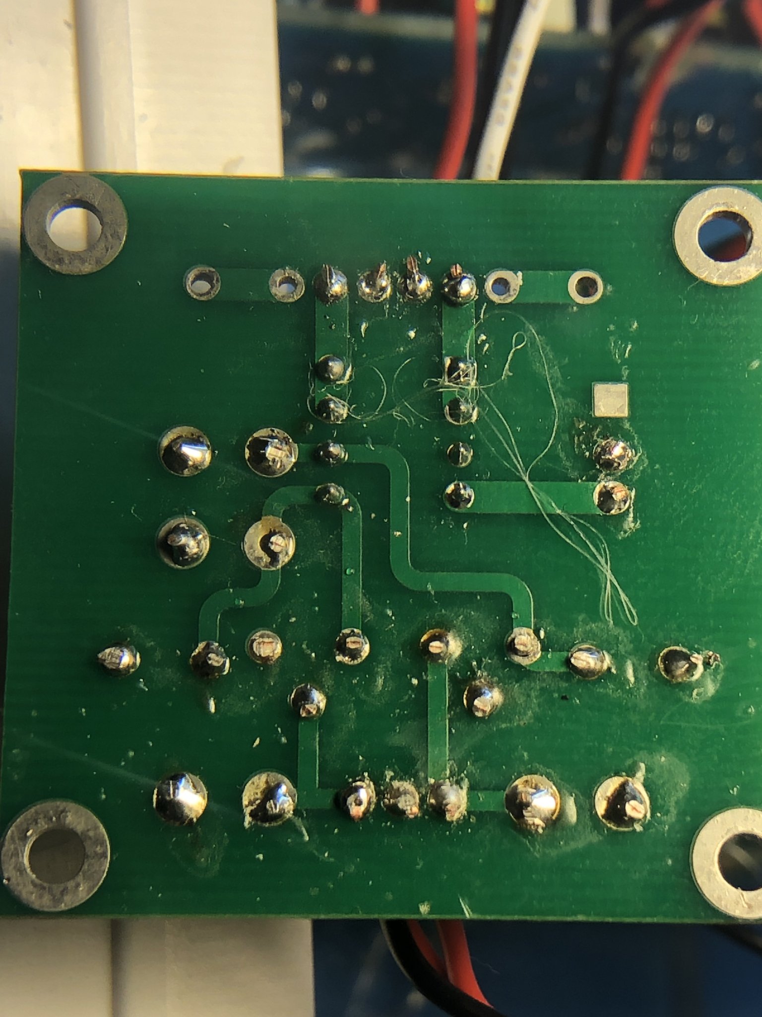

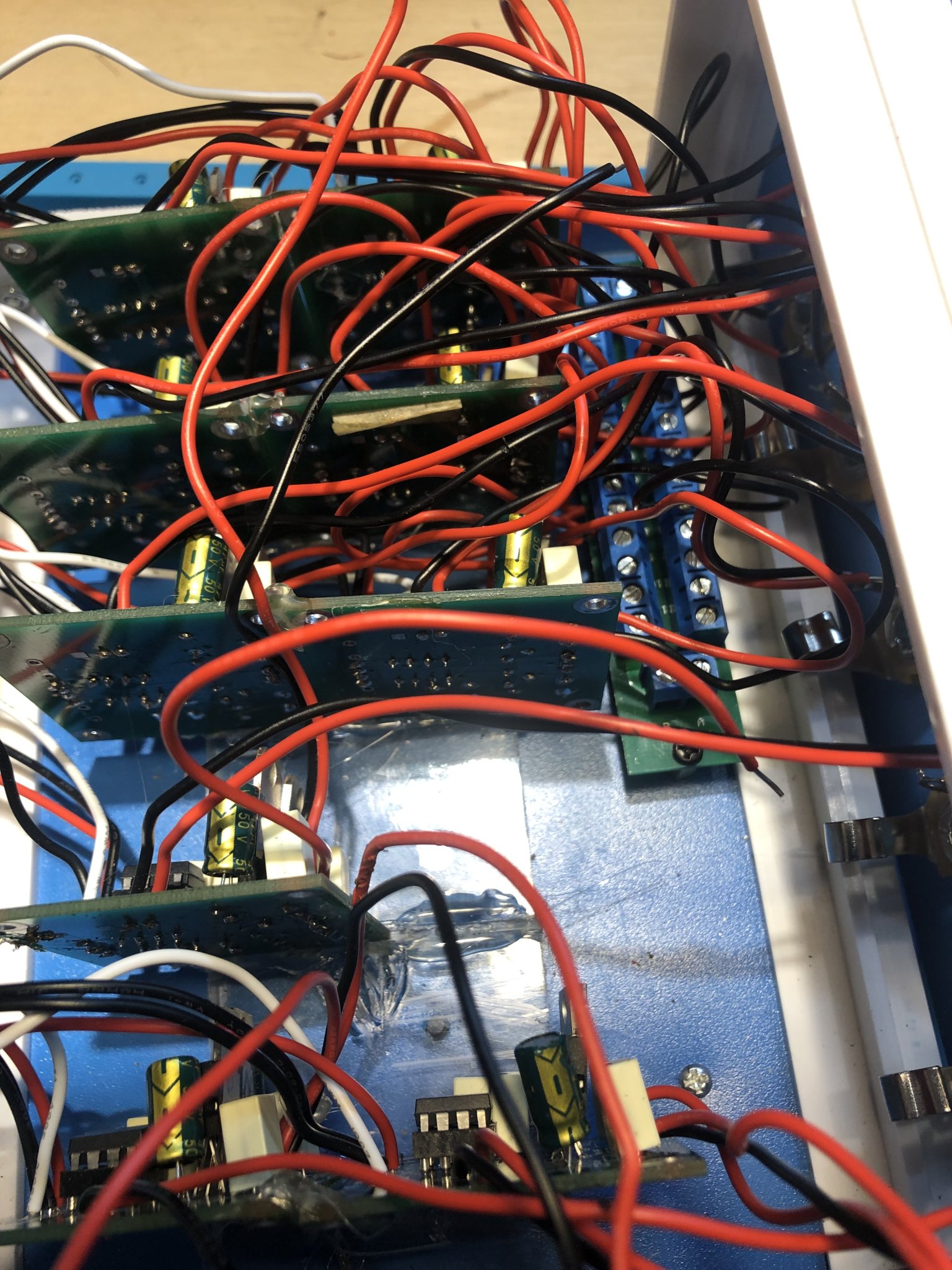

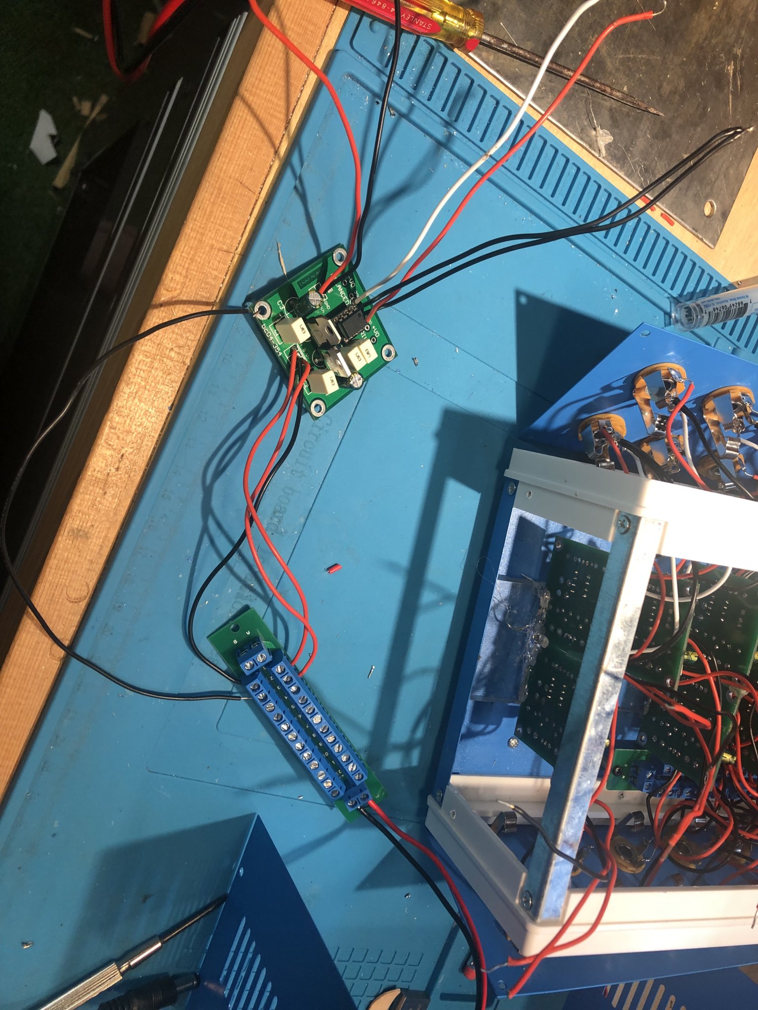

Hey! Don't know if anybody is still monitoring this... I'm trying to get in touch with Digi01 (Zang) I bought a bunch of his balanced line driver PCBs and finally got around to building. I'm having some weird issues. Everything seems to be correct with the build but I'm getting a pulsed noise and the 18 volt input is dropping to 0 and pulsing up to 6 volts or so when the circuit is connected.
Great! OK I've got 10 units built and installed but they all do the same thing, singly or together. Pulsing from 0 to 4-6 volts when metered from ground to outputs. The power supply is 18 v DC center positive. I'm powering them all from a small rail. I've got one isolated for testing. Show in pics: Original layout from Digi01 circa 2006, Back of one of mine, Top of one of mine, The loaded chassis, The test set up and the schematic. Any help much appreciated!
Yes! It's been a while. These PCBs have been sitting on my shelf for 10 years! I think I got it worked out. The circuit requires BOTH neg and pos power. I have no instructions and I though the - and+ markings on the power input were to identify which side of the system they powered as it has a positive side and a neg side, so I was putting +18 on both sides. Got a converter that supplies both and that did the trick!
I don't have it all assembled yet but tests look good. I'm going to use this to fix the direct, unbalanced channel outs from a vintage Allen+Heath mix console going into a modern digital converter. Been using it unbalanced forever and figured I'd see if this makes a difference.
