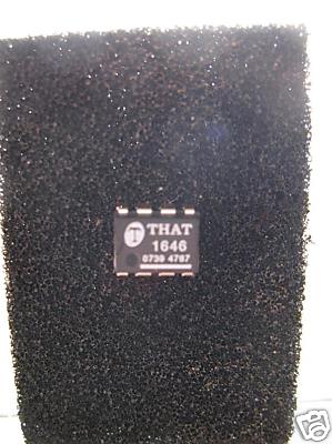

I have some extra THAD 1646 chip which even measure better than the DRV-134 .
You can look up the test on the net.
You can use as a replacement one by one to replace the DRV-134 chip.
The price for 1 chip $6.50

THAT 1646 not THAD 1646
MFR P/N 1646P08-U
Anthony

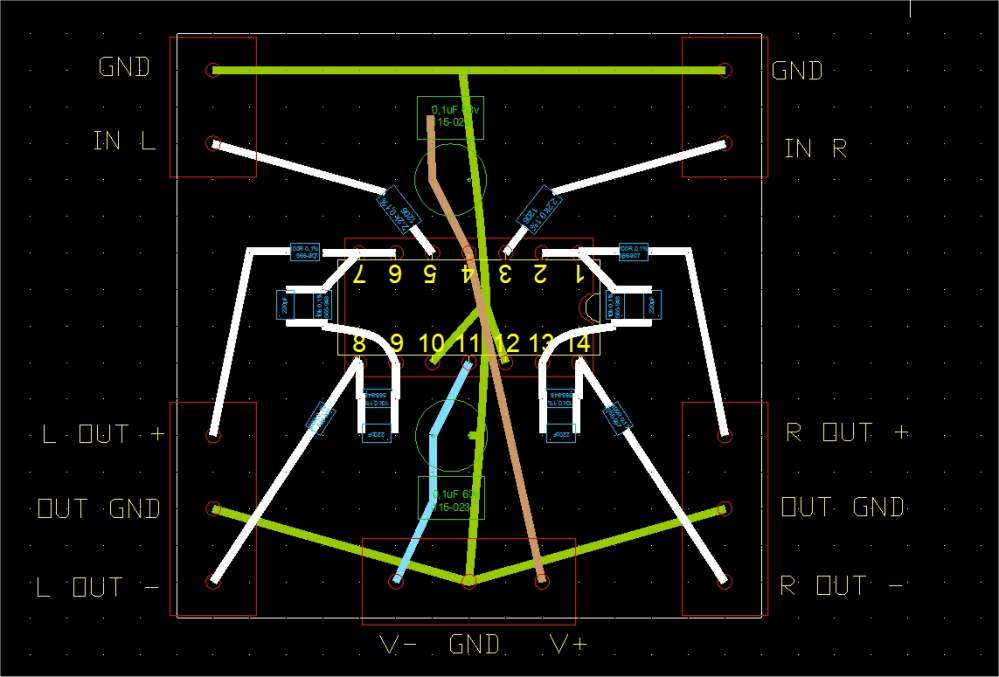

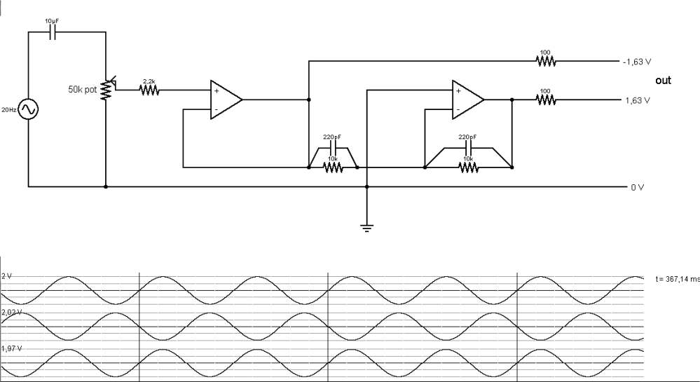

I go for this schematic. I'm now drawing the layout of the protoboard with one only quadruple opamp (TLE2074) for stereo configuration and SMD resistors 0,1% tolerance. The board will measure 40x40mm.
The 10uf input capacitor and the potentiometer will be out of the board.

Hi J,
not all opamps like zero resistance in the unity gain feedback loop.
Some NEED a real resistance value between output pin and -IN pin.
Add a 1k resistor. It is still a unity gain non-inverting buffer.
Add some input filters.
Why the two 220pF caps on the inverting half channel?
That top 100r must be located very close to the left hand tl07x output pin.

AndrewT said:Hi J,
i add the 1k resistor. The caps parallel to resistors are an advice of a friend to avoid noise, he said is to avoid any kind od gain at very high frequencies and also oscillations in the opamp.
About the input filters, a 2,2uf cap is enough. Is there any cap of this capacitance that i can use in a very small pcb. If not, i will use them out of the board, just after the pot.
Have you any preference about the quad opamp?
is that decoupling connected to the signal ground?
9mV from a pair of FET input opamps seems a bit high.
I realise that FET input amps can tolerate much higher input resistance mismatches, but maybe your zero attempt to do any balancing of the input resistances of both opamps is resulting in this high offset.
Once you have a high offset it becomes much more susceptible to drift with temperature.
not dc offset, what i mean is 9mv ac signal in the output with the pot at the min.AndrewT said:is that decoupling connected to the signal ground?
is this AC output a combination of noise and/or hum?juluska said:9mv ac signal in the output with the pot at the min.
Have you listened to it.
an ordinary speaker will reveal much about it.
A pair of headphones will reveal it at very loud level.
